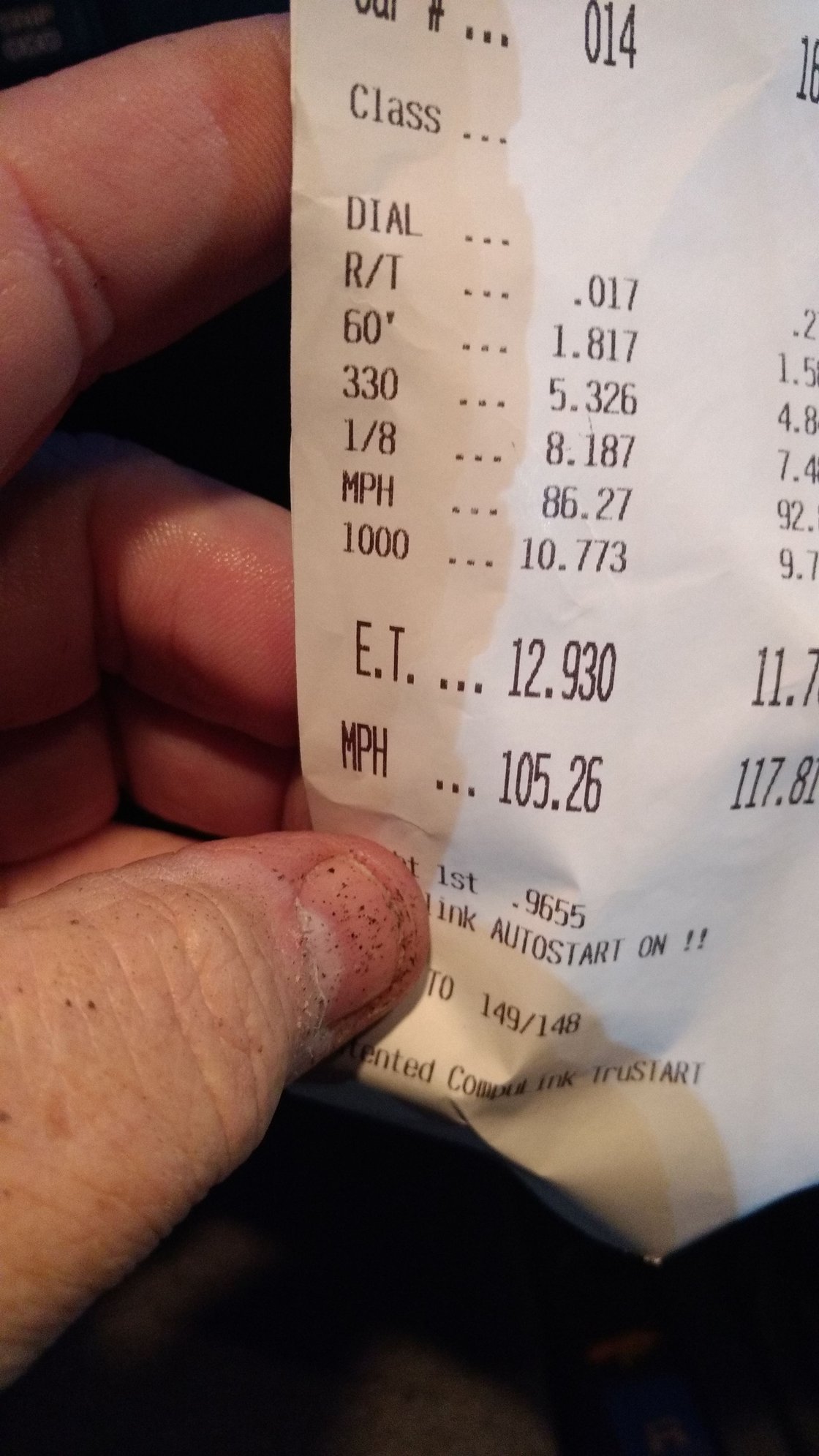

I posted earlier in another thread I was having problems at the drag strip as soon as I would launch car it would fall on its face about 10 ft out. Gas gauge showed half a tank, well the gas gauge was off and the problem was fuel sloshing to the rear of the tank. Now with full tank having a pretty good Friday night

Nice; was that just from a cam swap or did you do get the 1.6 rockers too? I forgot.......109mph roughly not too shabby. Nice 60 foots......drag radials??

Yes I do have Lunati Voodoo 1.6 S/A RR, Lunati double valve springs and CC hardened pushrods. this was on street tires. 275/40-18 Summitomo HTRZ 2, I do have a Protorque 2800 converter. leaving at 2500rpm
