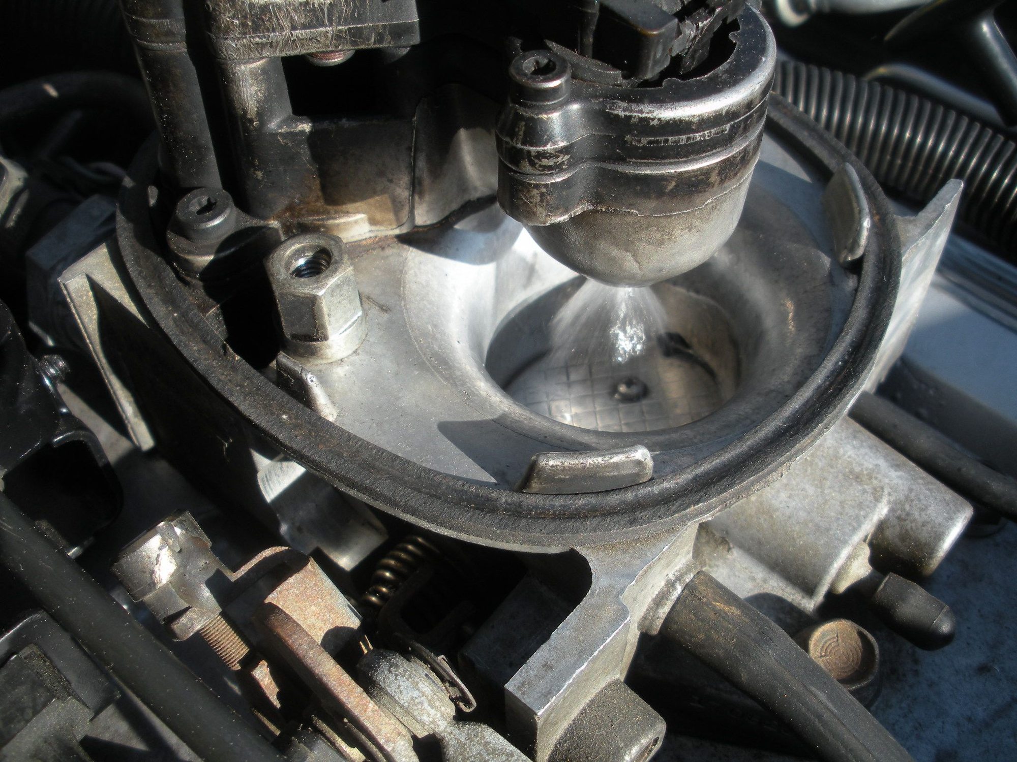

Originally Posted by Radioway
It's not really a cone more like a fan
Here's what mine looks like. Point your ignition timing light at the injector to see the pulse.
