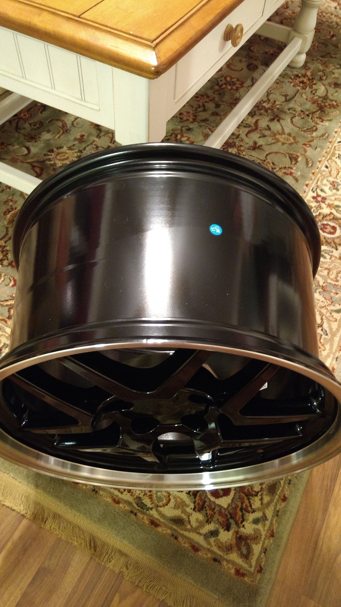

anyone have any experience in installing a lowering kit? I realize the rear is a simple longer spring bolt. it's what happens in the front I am not too clear on. also I was considering 2" drop in rear maybe 1.5 front and they all say 1" drop. not sure why my car looks so high. i have to close the wheel gaps but still want to get a good alignment. I just got new wheels but just added an inch in width in both front and rear. still gonna sit too high. thanks for input. car is only a sunny day cruiser for cruise ins and such.
