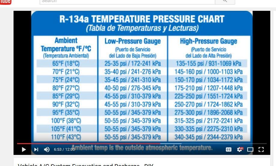

This is absolutely where to start with a set of gauges. You first check to see if the cycling points are at the right pressures. The low point should be about 22.5 psi is where the switch opens and the cultch releases. Then at around 45 psi the cycling switch should close and re-engage the clutch.
Regardless of the amount of Freon in the system, it should cycle at the proper points.
If you are good at these pressures and the numbers are very close, then the cycling switch is OK and you are probably low on Freon.
If the numbers are way off and it cycles at 30 or more, then the cycling switch is probably bad.
The ambient temperature should be about 70F or above which is nice. Not good to service A/C when its 40, 50 or even 60 outside.
Watch some YouTubes on how to interpret the gauges.

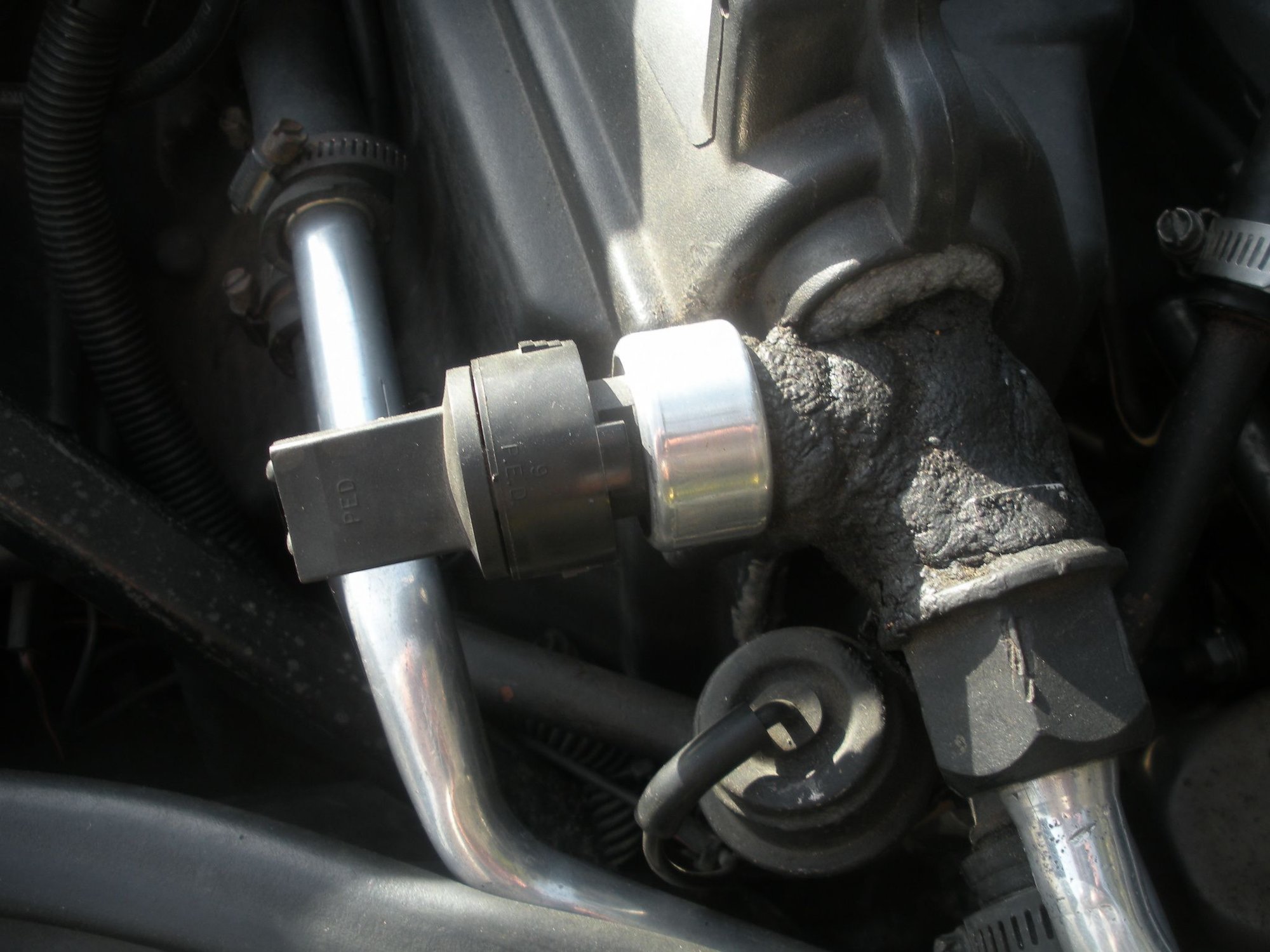

For clarification, the switch near the evaporator inlet is the LOW pressure switch, which is the switch that causes the compressor clutch to cycle when everything is working properly. The HIGH pressure switch is a safety switch, which will only actuate when something has gone wrong with the system, usually a condenser fan failure, overheat situation, or too much refrigerant in the system. The HIGH pressure switch is located somewhere in the high pressure lines on the outlet of the compressor.

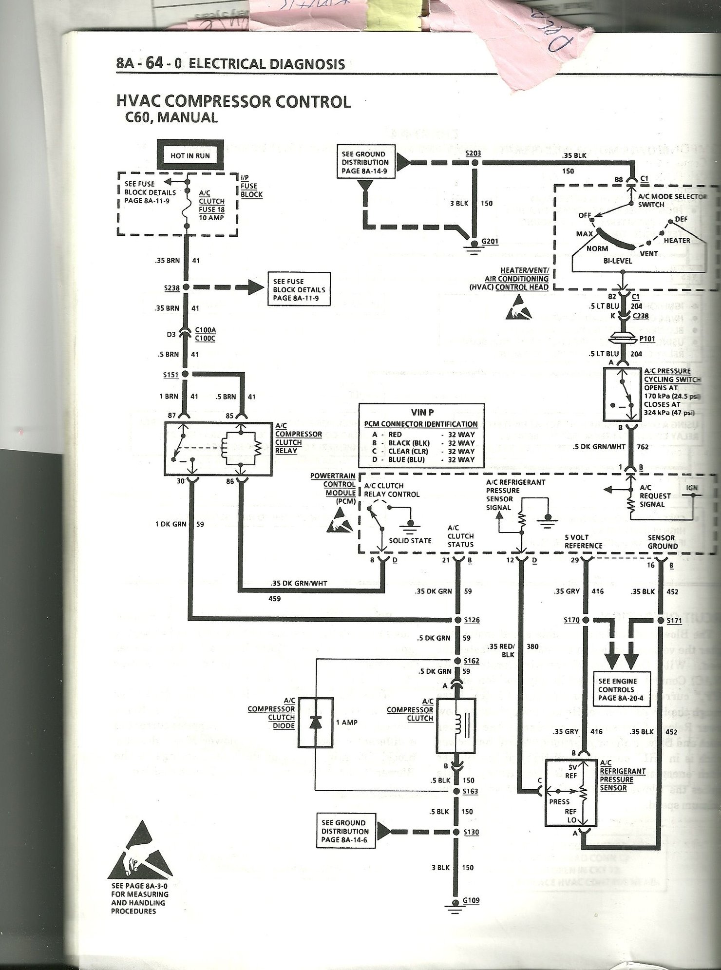

The high pressure unit is not a switch as the low pressure cycling switch is. The high pressure is a variable resistor or rheostat which produces a voltage dependent on pressure of the high pressure line. The voltage is read by the PCM and has inputs into A/C operation. It can also shut down the compressor if it does not see a pressure change when compressor starts.
You can also read the high side line pressure using a Tech1 or professional scanner using the OBD1 (ALDL) connector
What year are you referring to? Can you post a diagram of this system? My ALDL connector can't do this test, since there is no such sensor in my a/c system. My system uses a switch to disable the clutch if there is excessive high side pressure .
I'm sure about the years 92 to 96. I know the 90 uses the switch setup you talked about. Not sure about the 91 but a guess would be the switch assembly.
The 92 and 93 uses the ECM but functionality is the same.

Thanks for posting that diagram, pcolt. The engineers sure are busy, making these cars more complicated! But my post #13 is still valid, since I was trying to clarify that it's the "low side" AC PRESSURE CYCLING SWITCH that controls the cycling of the compressor clutch. All that electronics in the later cars will also be used to give you the error codes that the early cars can't.
