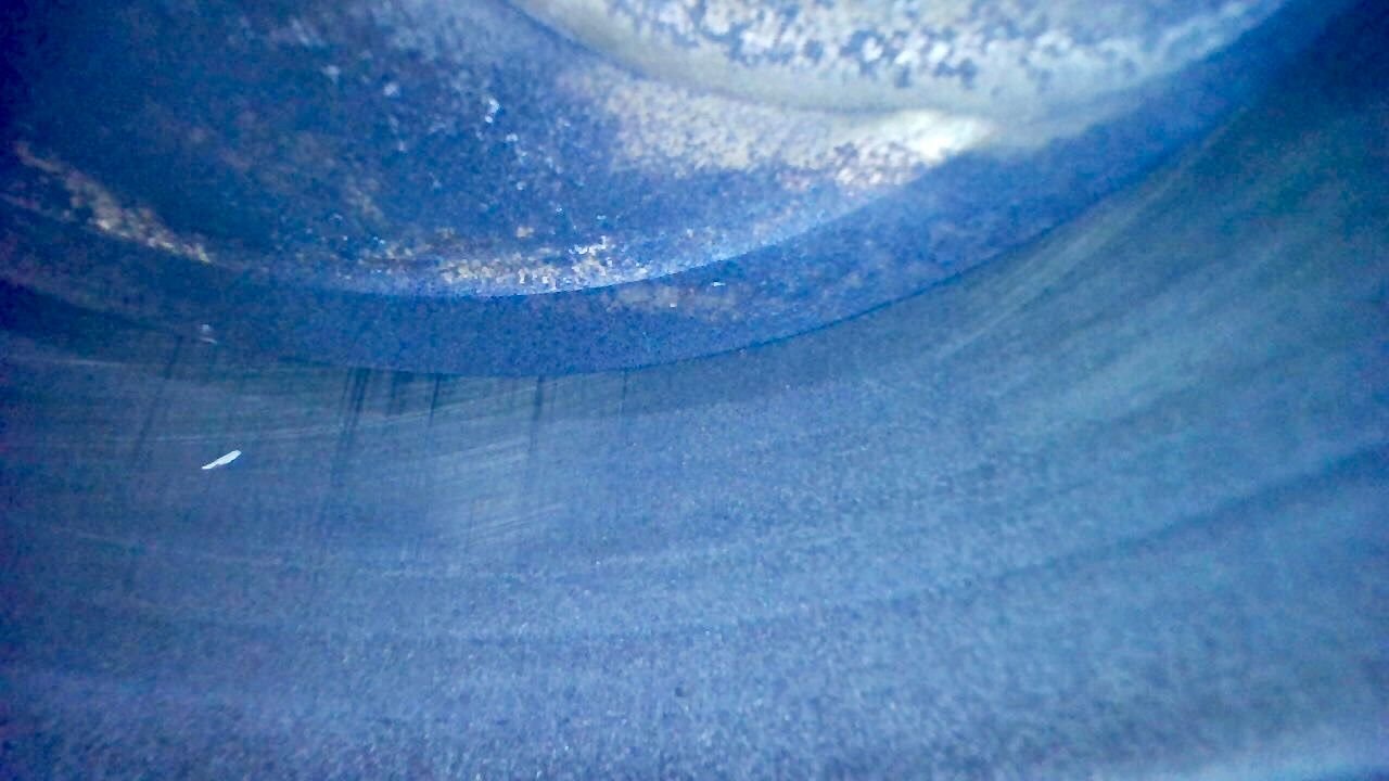

I just used bore scope not more then 15 mins ago and found I have dish pistons I have included a photo. I now need to find out what cc they are

Here's a picture of my stock '89 from when I did a head gasket replacement this past winter.
Old Jul 18, 2019 | 01:23 PM
mlm0's Avatar
mlm0
Joined: Dec 2012
Posts: 1,504
Likes: 73
From: Georgetown TX
Same as mine. Do you happen to know the piston volume?
