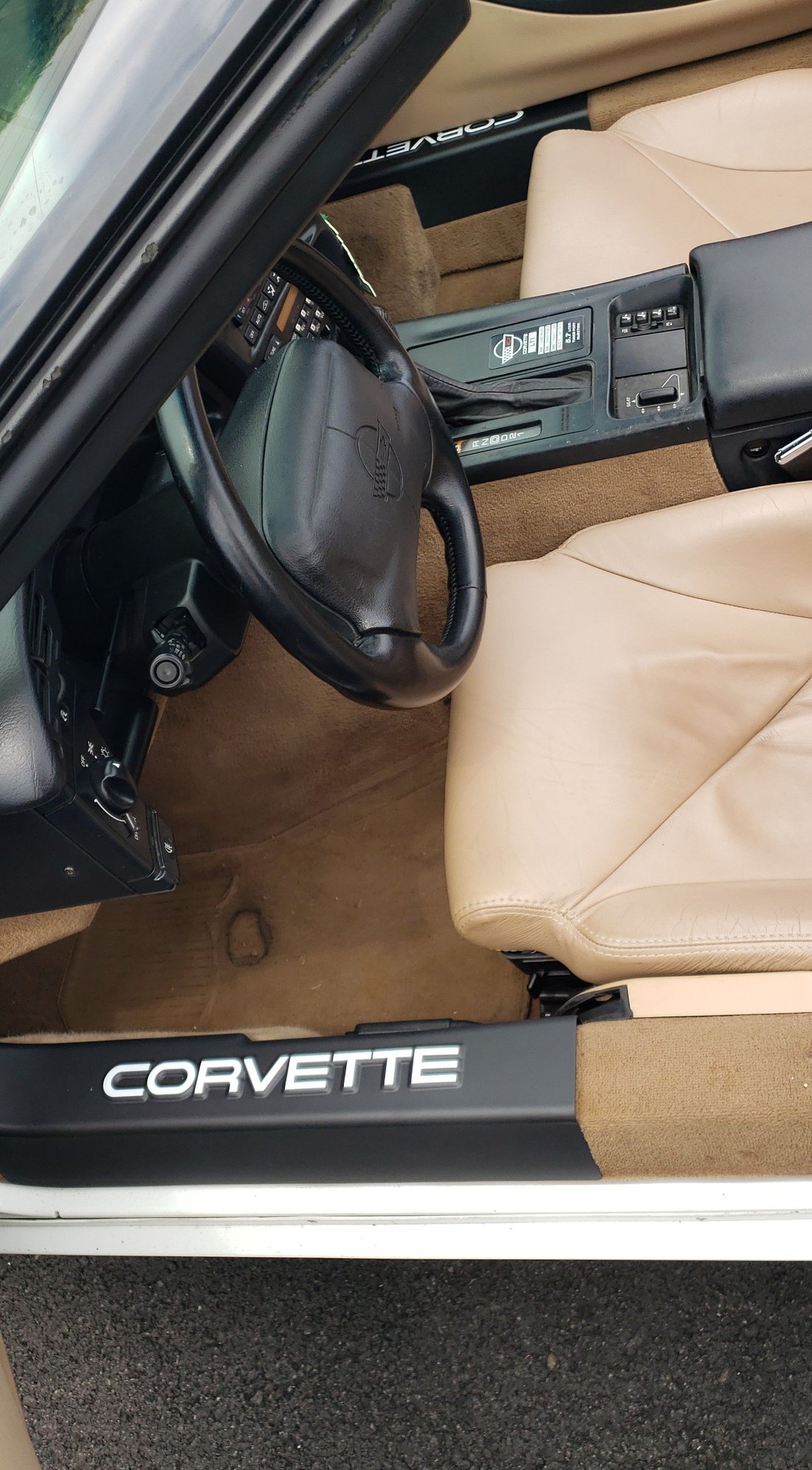

Interior shot...door sill protectors and HP info plate installed
Any questions? I didn't think so! LOL

That is a beautiful Corvette you have there, I hope that you gets many years of smiles out of it.
