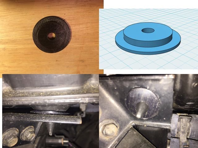

Here's a fairly simple piece but it's also a NLA part that I needed. Plus I wanted to play around with flexible filament.
It's printed in TPU which comes out like a stiff piece of rubber. This has been on the car about 2 years.
https://www.thingiverse.com/thing:4163309

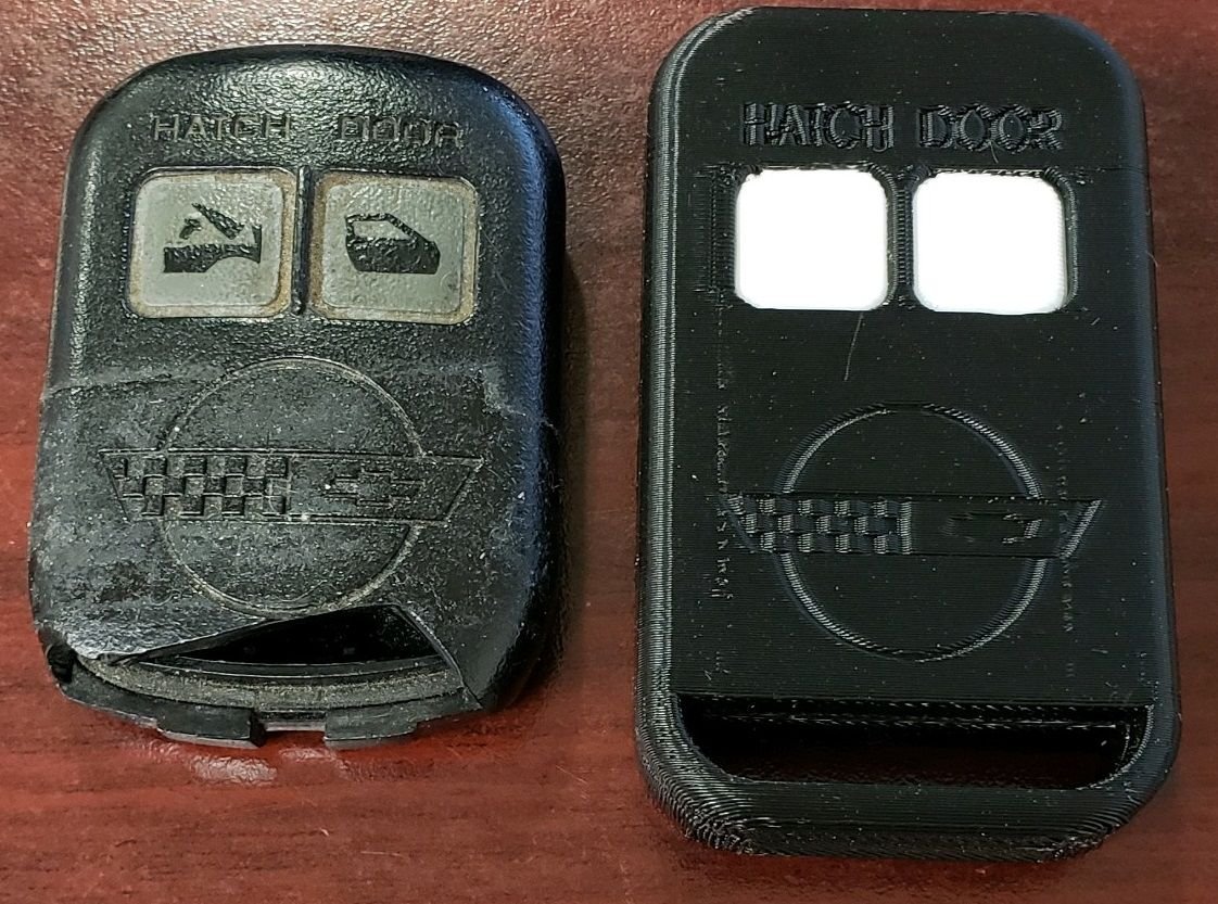

My brother did this for me:

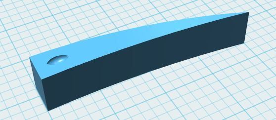

This isn't C4 unique, but handy if you need to change a regulator. They wedge between the outer seal and the glass to hold the window in place.
These are available commercially. I had a regulator to change on my daughters car and just drew up and printed a couple.
https://www.thingiverse.com/thing:4166949
