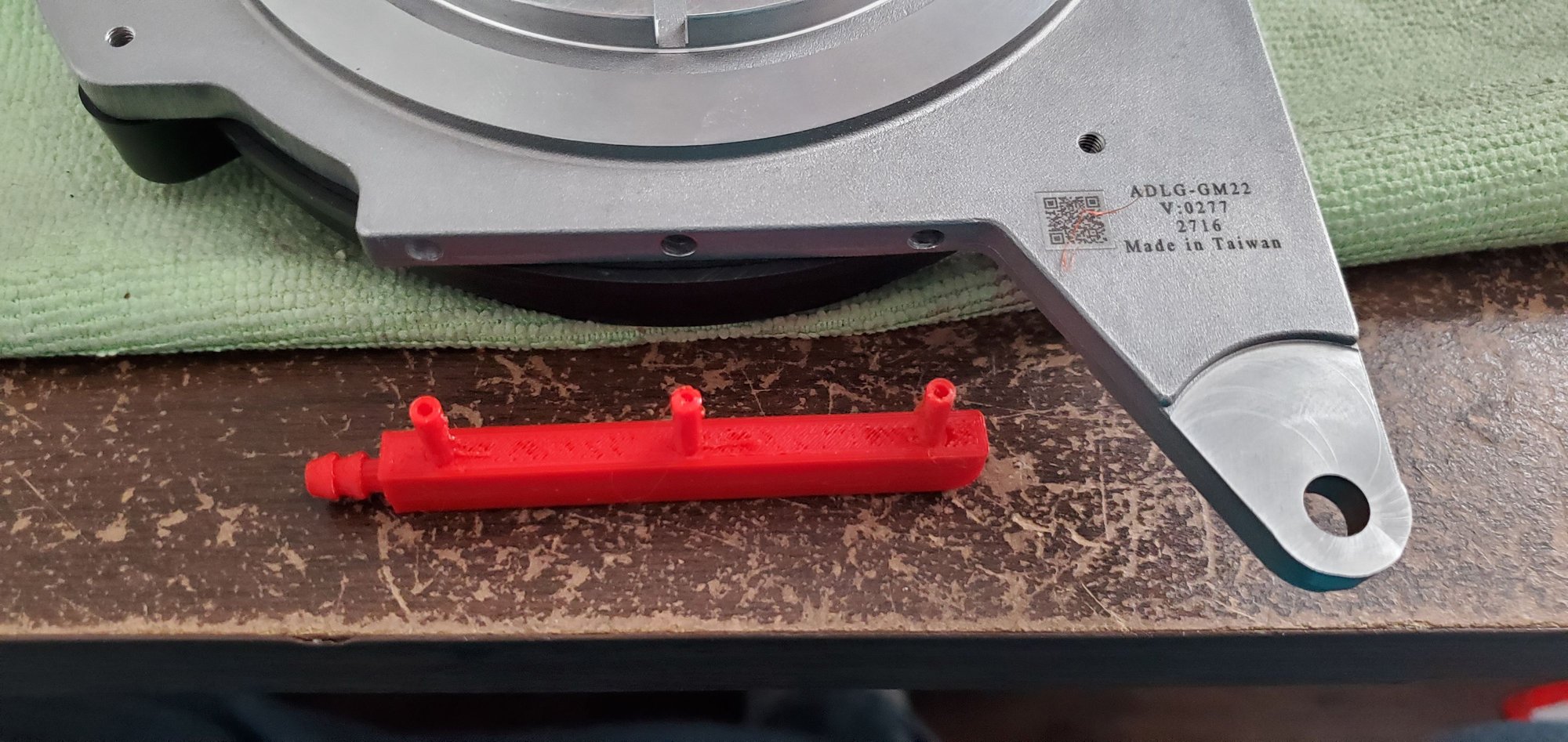

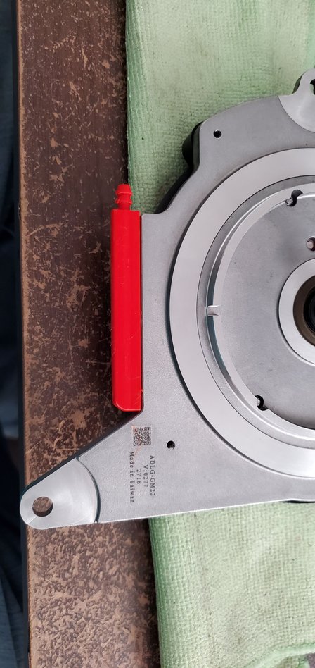

So not exclusively for a C4 but I printed an adapter for the gen1 optispark to put a proper suction on it. I have mine under warranty from autozone so they are free to replace for life but at the risk of having to do it. Well its been 5 years and I decided to take the version of this I did on my last and apply it to the replacement with an improvement. The requirement is to drill out the three vent holes with a 5/32 drill bit. Ho slowly and it will draw it self. Next print this at 100% with petg and glue it in place.
