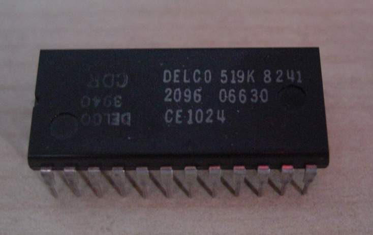

Lockup points were changed. One replacement chip from GM ond also in tuner chips.
These are the ones I know of:
CDR3940.bin stock
CDR8277.bin GM fix for TCC lockup speeds
ADS8407B.bin ADS Superchip 'B'. To use with low temp thermostat
hypertech 84 cfi thermalmaster.bin
Address - CDR3940 - CDR8277 - ADS8407B -HYPERTECH
001E4 - 045 (15) - 131 (44) - 096 (32) - 130 (43) - (MPH*3 for TCC engage 3rd gear)
001E5 - 042 (14) - 128 (43) - 089 (30) - 128 (43) - (MPH*3 for TCC disengage 3rd gear)
001F8 - 080 (27) - 131 (44) - 128 (43) - 130 (43) - (MPH*3 for TCC engage 4th gear)
001F9 - 074 (25) - 128 (43) - 120 (40) - 128 (43) - (MPH*3 for TCC disengage 4th gear)
So stock chip should engage at 15 mph in 3rd and 27 mp in 4th if all other conditions are met.

Does the chip have numbers on it so I can tell which one I have? I think I have the original GM that should have been updated.
Ken
Old Feb 28, 2020 | 07:50 PM
JoBy's Avatar
JoBy
Posts: 2,149
Likes: 303
From: Timra, Sweden
The chip should say CDR 3940 or CDR 8277.
I have the bin files if you know someone with an eprom programmer.
The chips are 1k of a type that is 'impossible' to fine but you can use 4k eproms and repeat the data 4 times.
Actually the 4k chip ( 2732 if I remember ) has extra address pins that are something else on the stock chip. When using a 4k chip data will be read from the 3rd k if I remember.
