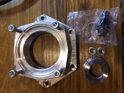

I finally got my oil pan, an F body style i found on the bay store for $110. Also received the tail shaft housing adapter and did some test fitting with that. The kit came with a new reluctor ring that slips on the tail shaft and tightens down, but the old one is in the way. I should be able to press that one off right? Also the tail shaft on the original 700R4 stuck out 3/4" but with the adapter and original tail housing it sticks out about 1 1 /4". I don't think it will be a problem but today I hope to get the driveshaft out of the car and check.

Goodies!
