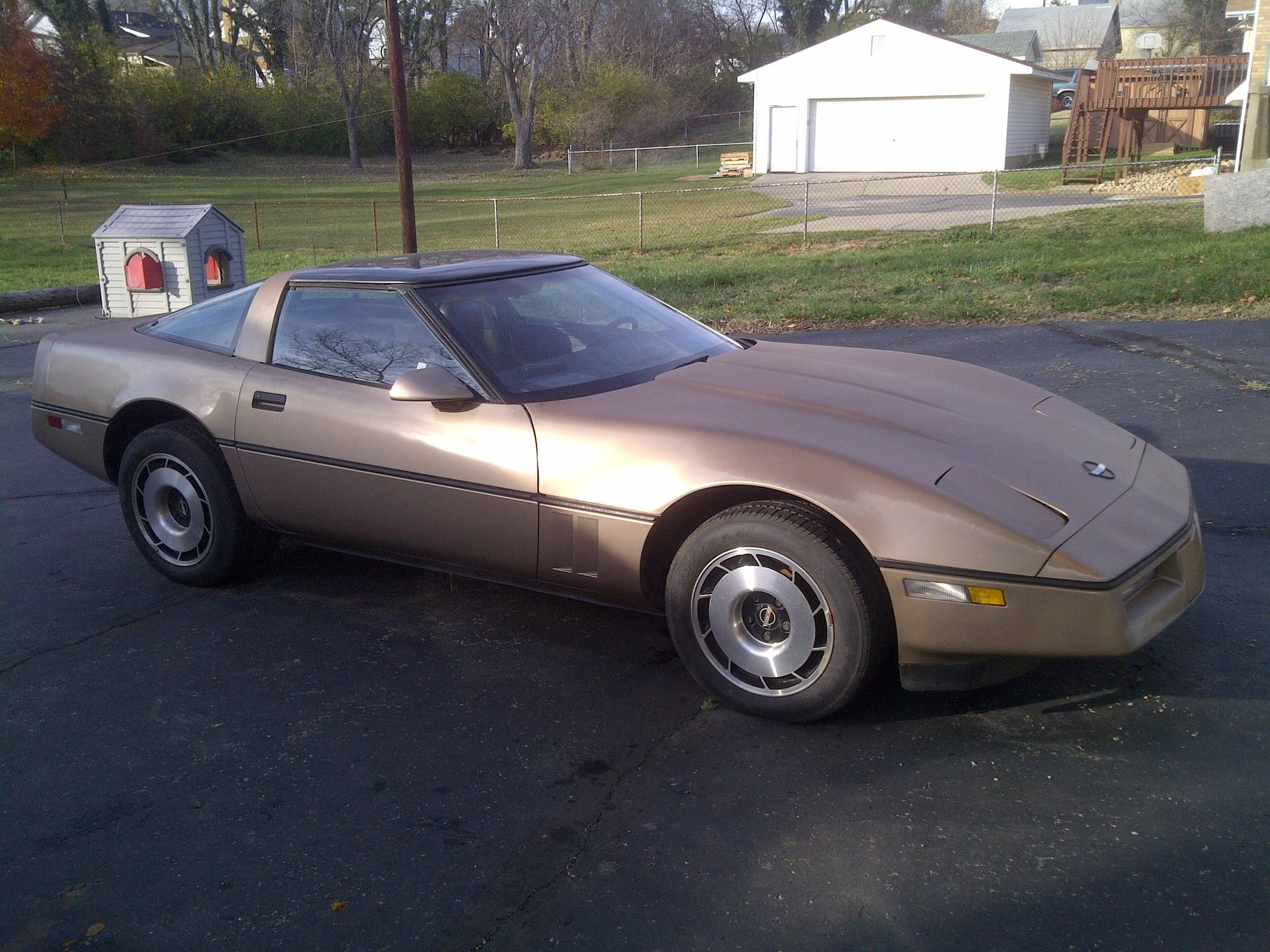

I bought my first corvette, a 1985 C4, back in 2013. Paid way too much for it, then spent way too much trying to get the 105,000 mile L98 running correctly. After replacing all the sensors, computer, cleaning injectors and throttle body, new radiator and water pump, it was running but with a solid miss. Pulled off the valve covers and found the #8 cylinder with an exhaust valve stuck open. Pulled the heads and installed a used set of World Products heads I had laying around, and finally had a good running car. Built my own custom exhaust with 40 series mufflers and a set of dual tips from the e store. Car sat for a couple years, then the alternator crapped out and messed up the digital dash. Since the interior is shot and the body needs a good paint job, I was stuck with either parting it out to get a small portion of my investment back, or do the swap and restore the car. I decided on the swap. I was able to fix the dash with a new power supply and new film on the LCD displays so that sealed the deal. Picked up a 113,000 mile LQ4, a 4L60E with unknown miles, and decided on the Holley Terminator X Max fuel management system with trans control. The plan is to rebuild the engine by breaking the glaze on the cylinders and reuse the pistons, rods and crank with new rings and bearings. Everything looked real nice when I broke it down, no cylinder ridge and still has some cross hatch left. I plan to run a 400 grit ball hone through the cylinders, then clean and paint the block and put it back together using rebuilt 706 heads. There is an article out on the webs of an LQ4 making 480hp with 473lb/ft with these heads, and streetable torque with my horsepower goal should make a great weekend warrior. I'm very undecided on the cam, being only familiar with the Gen 1 Chevy and Pontiac engines. I'd like to make 450 hp. I also plan on using the adapter that lets you attach the original tail shaft to the 4L60E, although its fairly expensive. Here are some pics of the project.
This is my first time posting anywhere about any project so bear with me. I have over 20+ years experience building on cars, mostly Firebirds and Trans Ams. However, I have never messed with anything fuel injected/computer controlled, but that doesn't mean I won't give it a shot. I've always loved the look of a C4, and jumped on this one. I understand the 85's are set up as a mostly stand alone computer system, so that will help with the switch to the Holley system. I have a fair amount of electrical experience and skill (dad was an electrical engineer) and can weld, do body work and paint. Here is a pic of my 81 Trans Am that I did a frame off restoration and installed a 383 with Vortec heads. I went 13.3 at 105mph at the local track, and that was on street tires spinning through the 60ft mark.
Anyway, thanks for looking at my post. I will be adding more info/pics as I go. Any suggestions/comments are much appreciated. I've been looking at a couple other build threads and hope to learn from them and others, and share my experience as well as assist others with any questions.

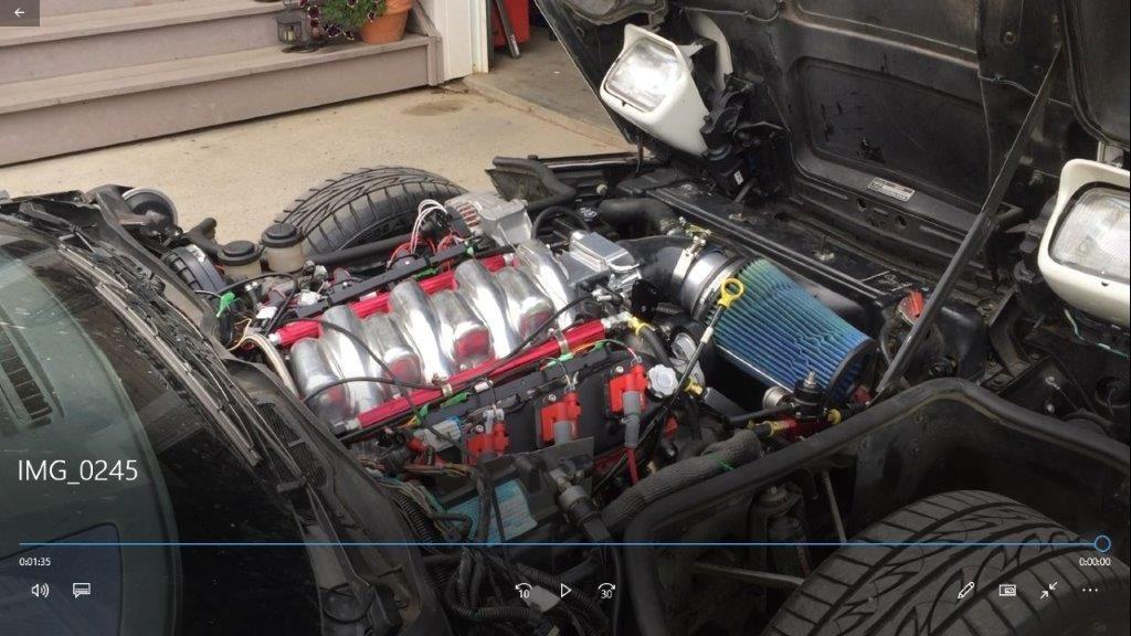

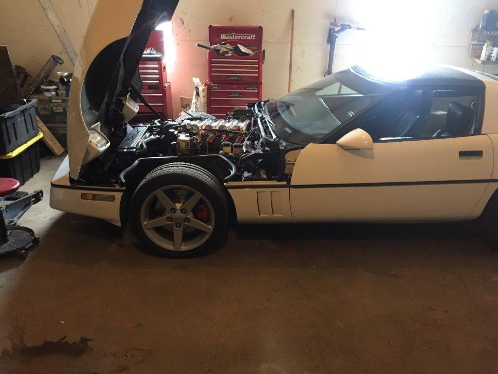

I have a LQ9/700R 85 vette, FAST stand alone, ev6 LS3 injectors, speedmaster intake, 102mm throttle body, headers. I would install the LS2/LQ9 pistons (and since the engine is apart, LS2 pistons are cheap) and run the larger intake runner/intake valve 243/799/317 heads (210cc runner). The 706 heads will work fine (200cc runner)., I would also run the newer C4 rad support (slanted rad), so you can have a cleaner cold air set-up. My original dream was going to run a turbo, but not sure if its going to happen.
To 1985 C4 LQ4/4L60E conversion
