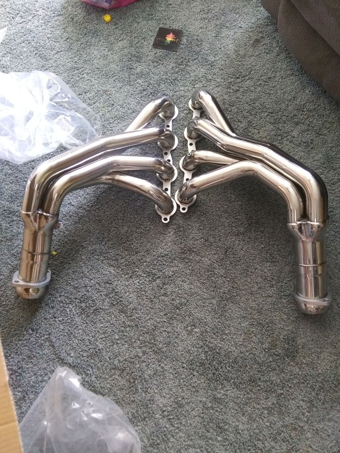

Got a set of "stainless steel" C5 headers from Amazonian yesterday. I saw in other posts that C5 headers will fit if you cut the collector off and weld it back on at a 45deg angle.

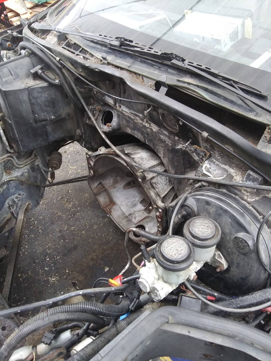

I also test fit the transmission empty to make it easier to maneuver. Going to be a lot of fun when its assembled and 145lbs or so.
Looks like it has decent firewall clearance.

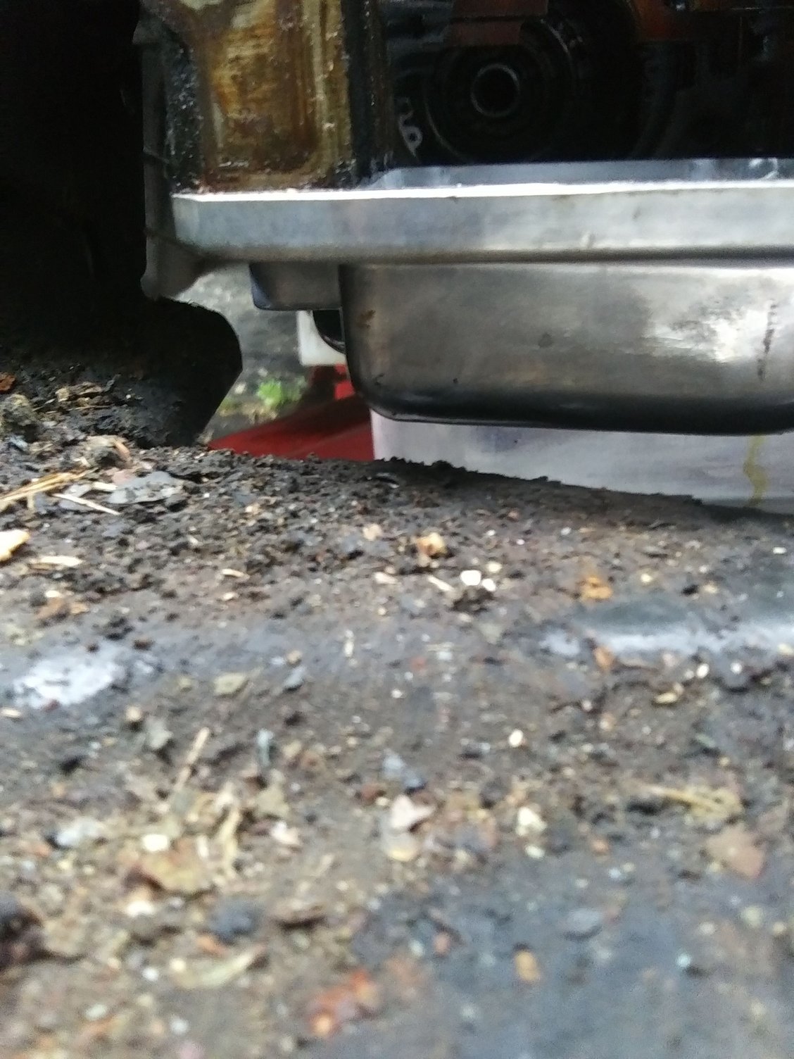

Good ground clearance too I may reuse the deep truck oil pan.

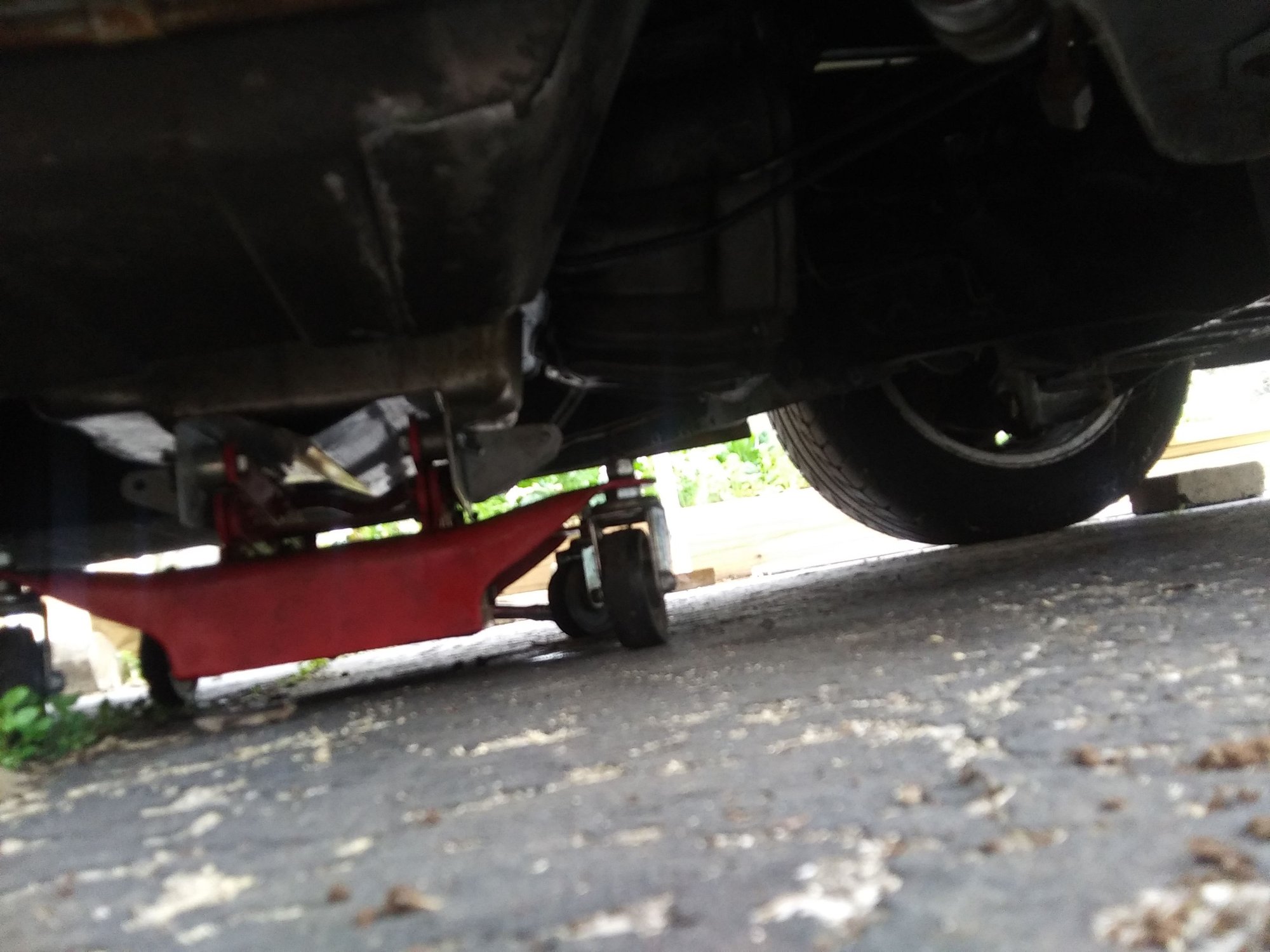

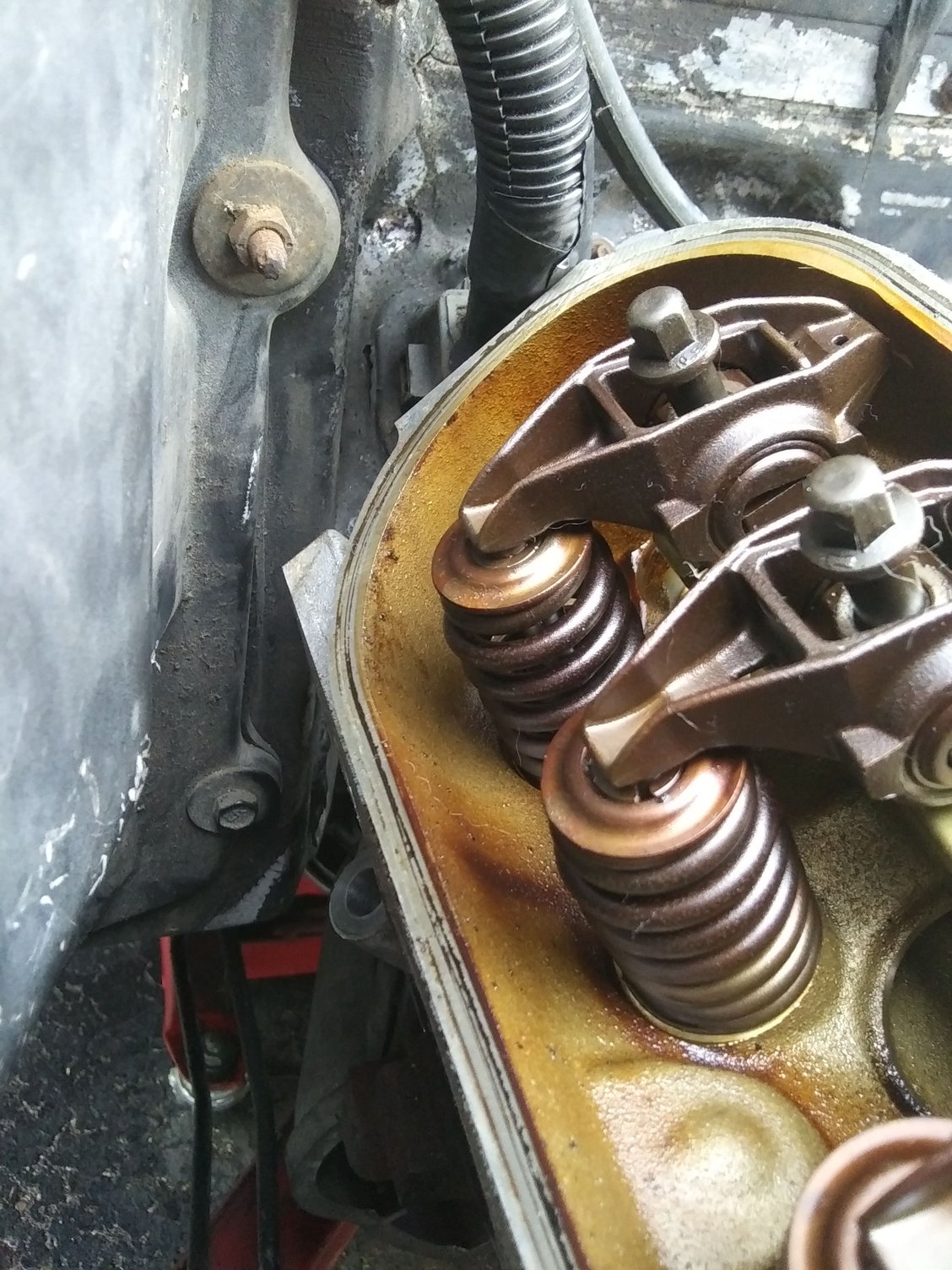

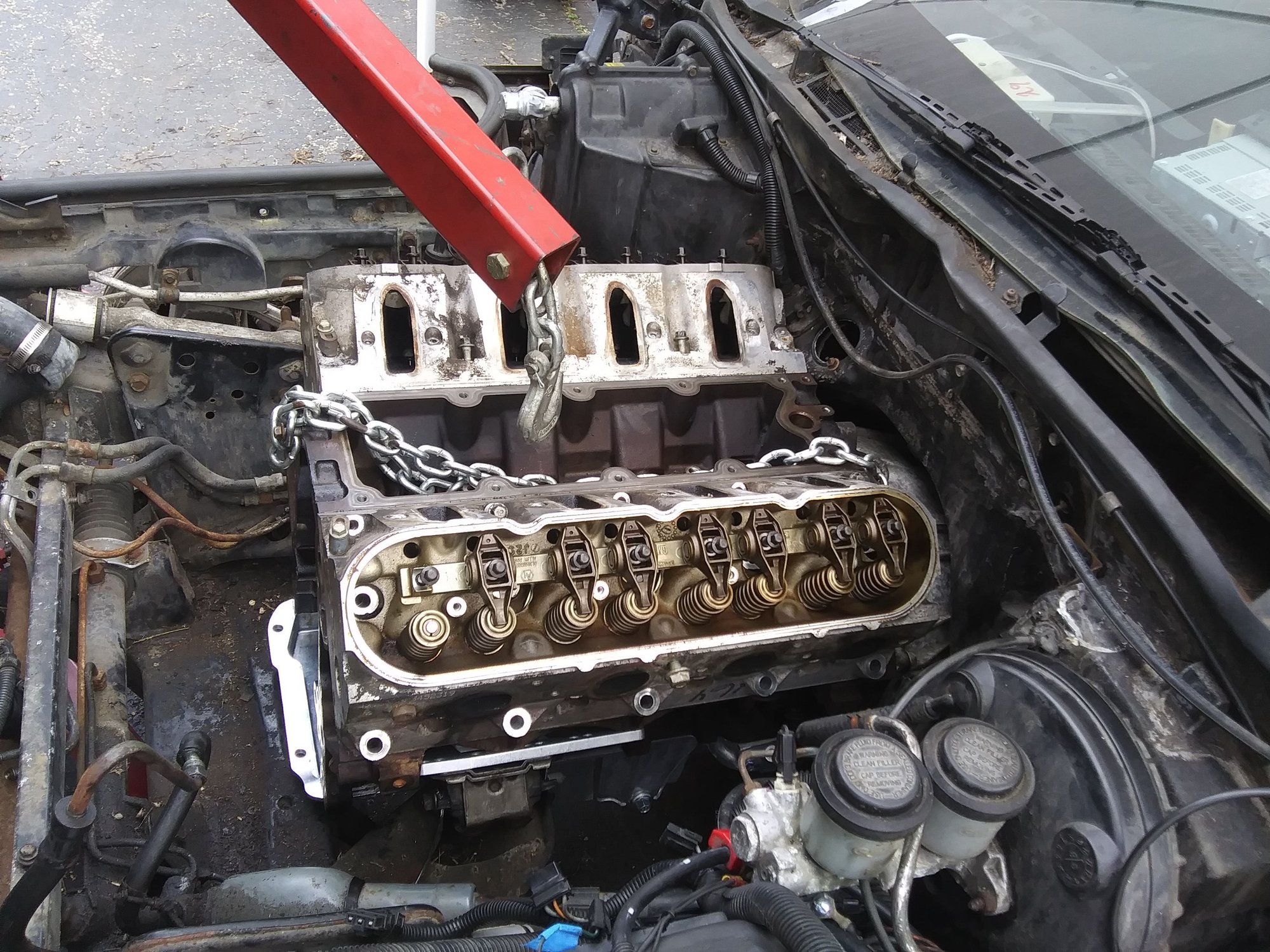

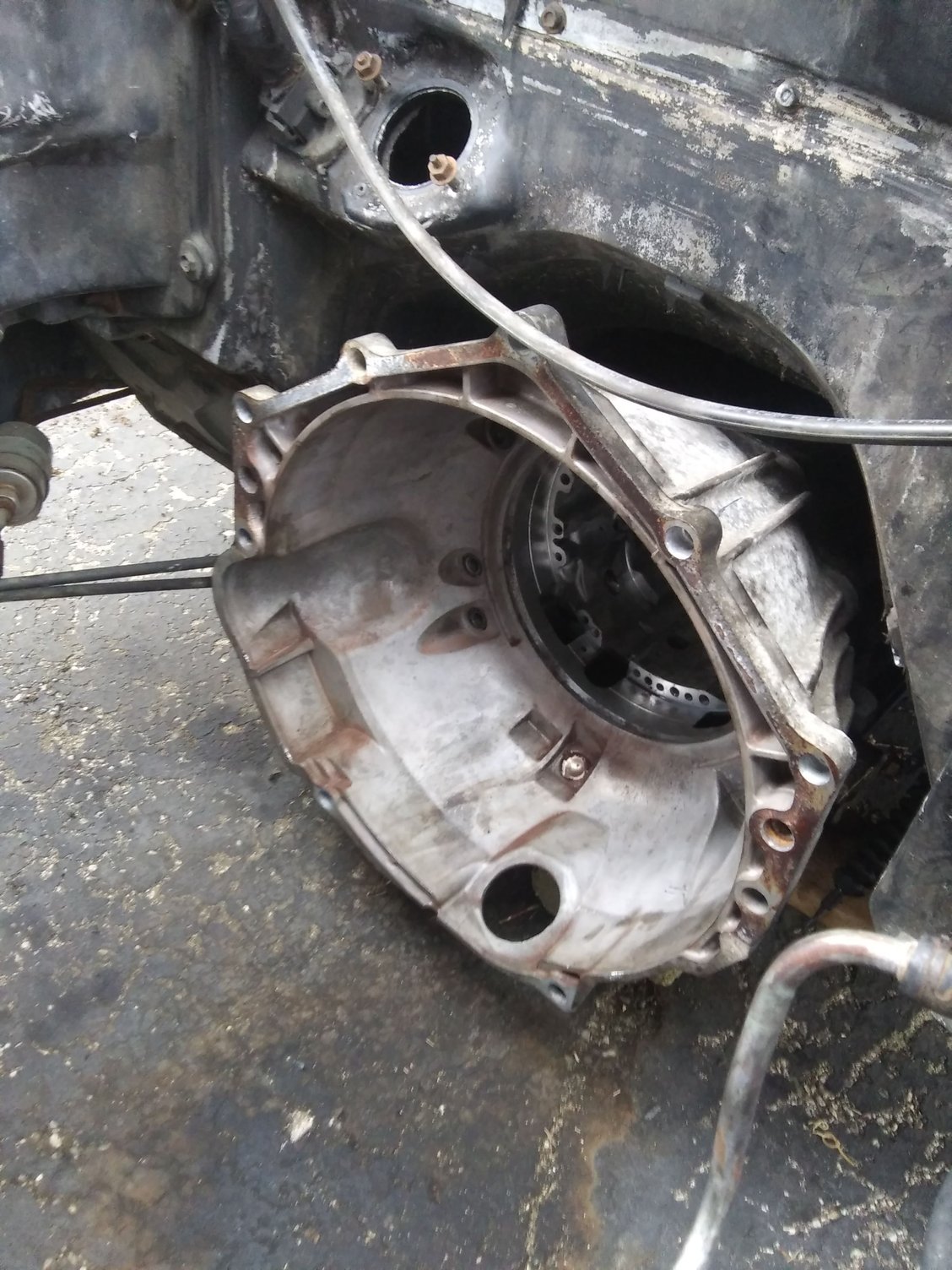

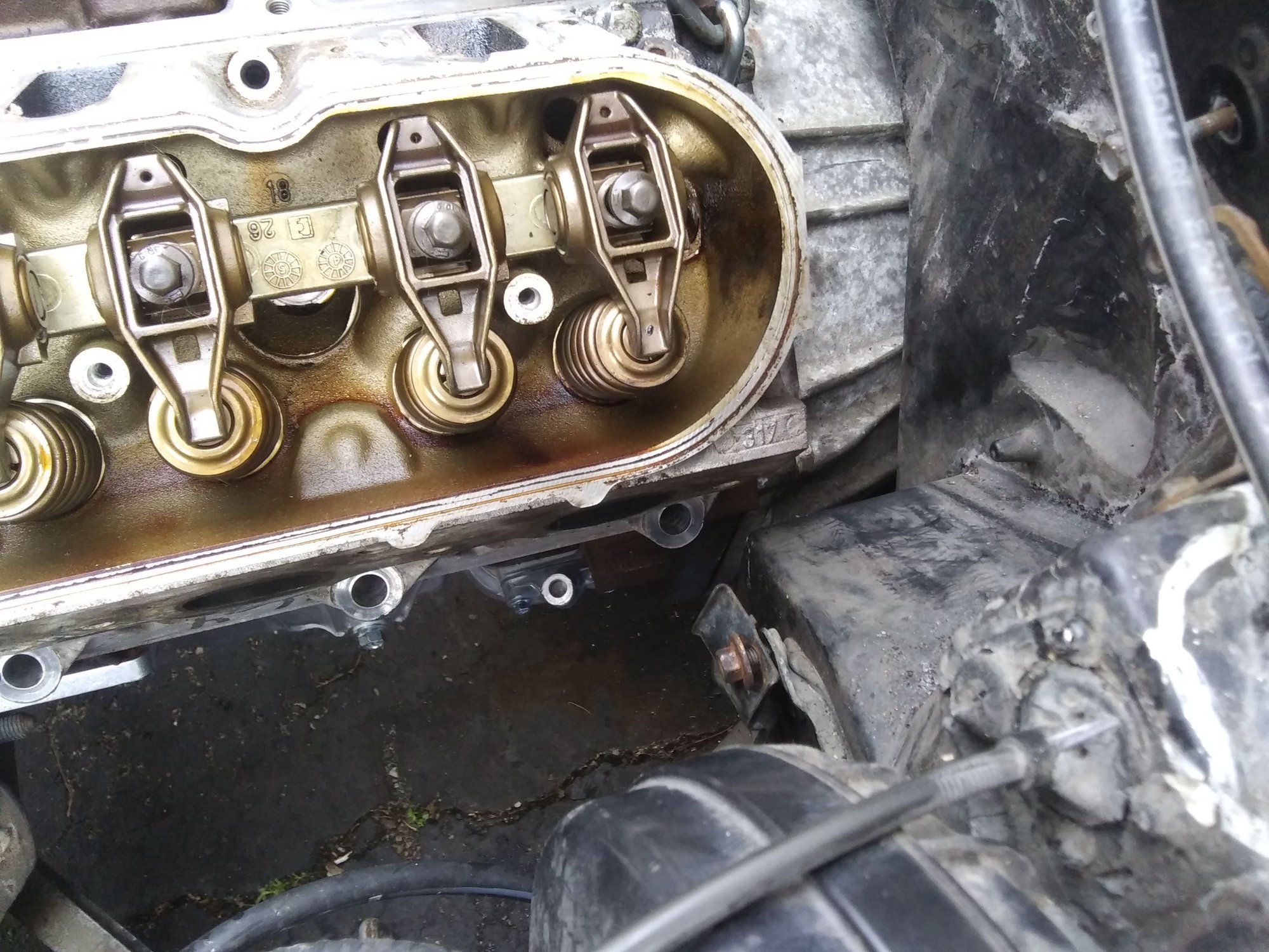

Round 2 test fitting. From todays experience I think I'm going to have to attach the trans to the engine after its lowered into the engine bay but not into the pedestals, then attach the driveshaft and cbeam, then drop the engine into the pedestals. If anyone has other suggestions please let me know. Heads and oil pan cleared nicely, both C5 headers need to come from underneath to install.
Good driver side clearance
Good passenger side clearance
Oil pan clearance good
Both sides look good

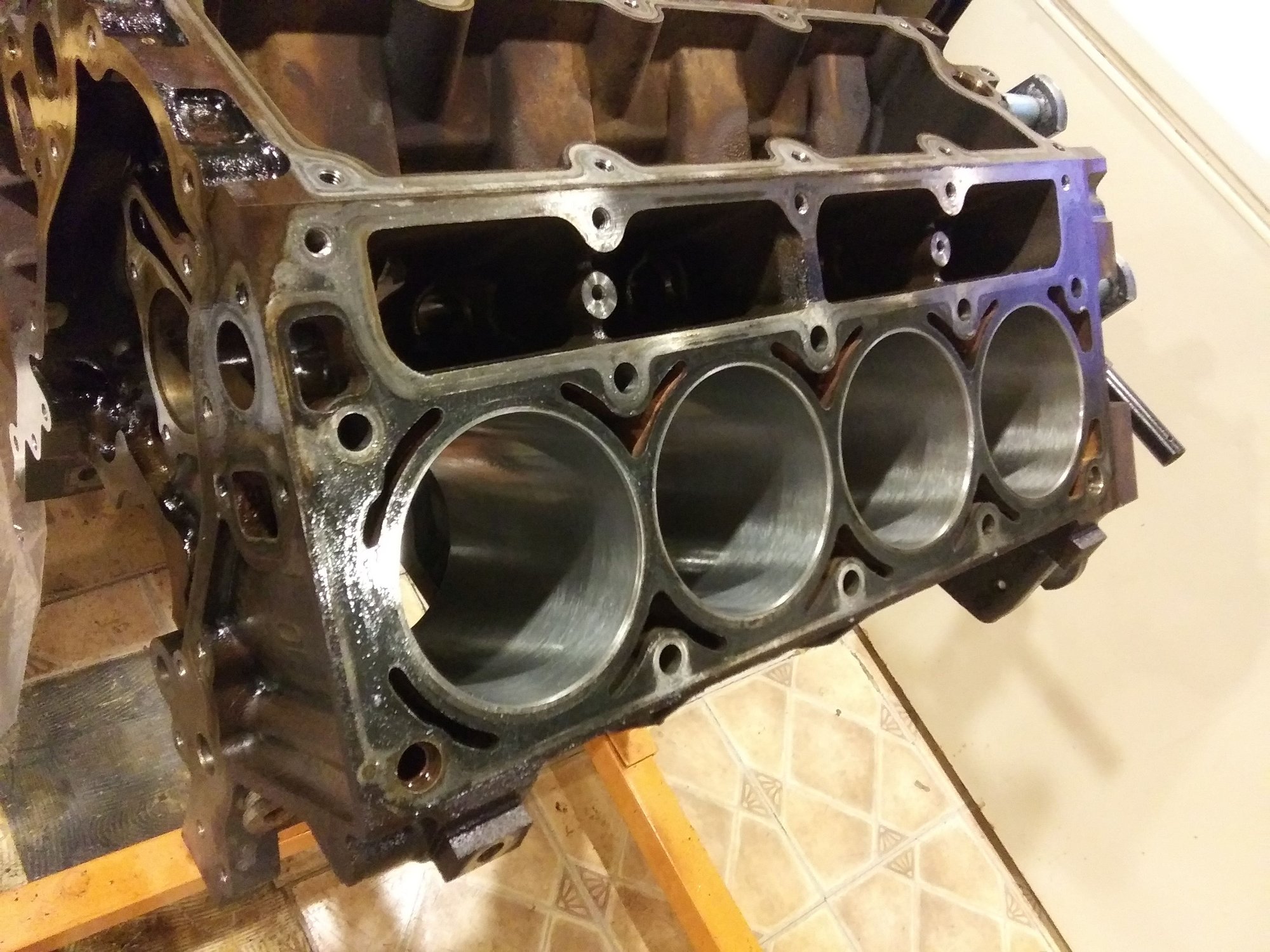

Sunday funday was able to clean the block, hone the cylinders with a 400 grit hone for the moly rings, then we went to the local car wash for a quick soap and clean. Wiped the cylinder bores clean with paper towels then sprayed with wd40. Brought it home blew out all the threaded holes with compressed air then extra spraying with wd40 to keep flash rust down. Hope to finish cleaning the internal passages this week and start the assembly.

Cylinders cleaned up very nice

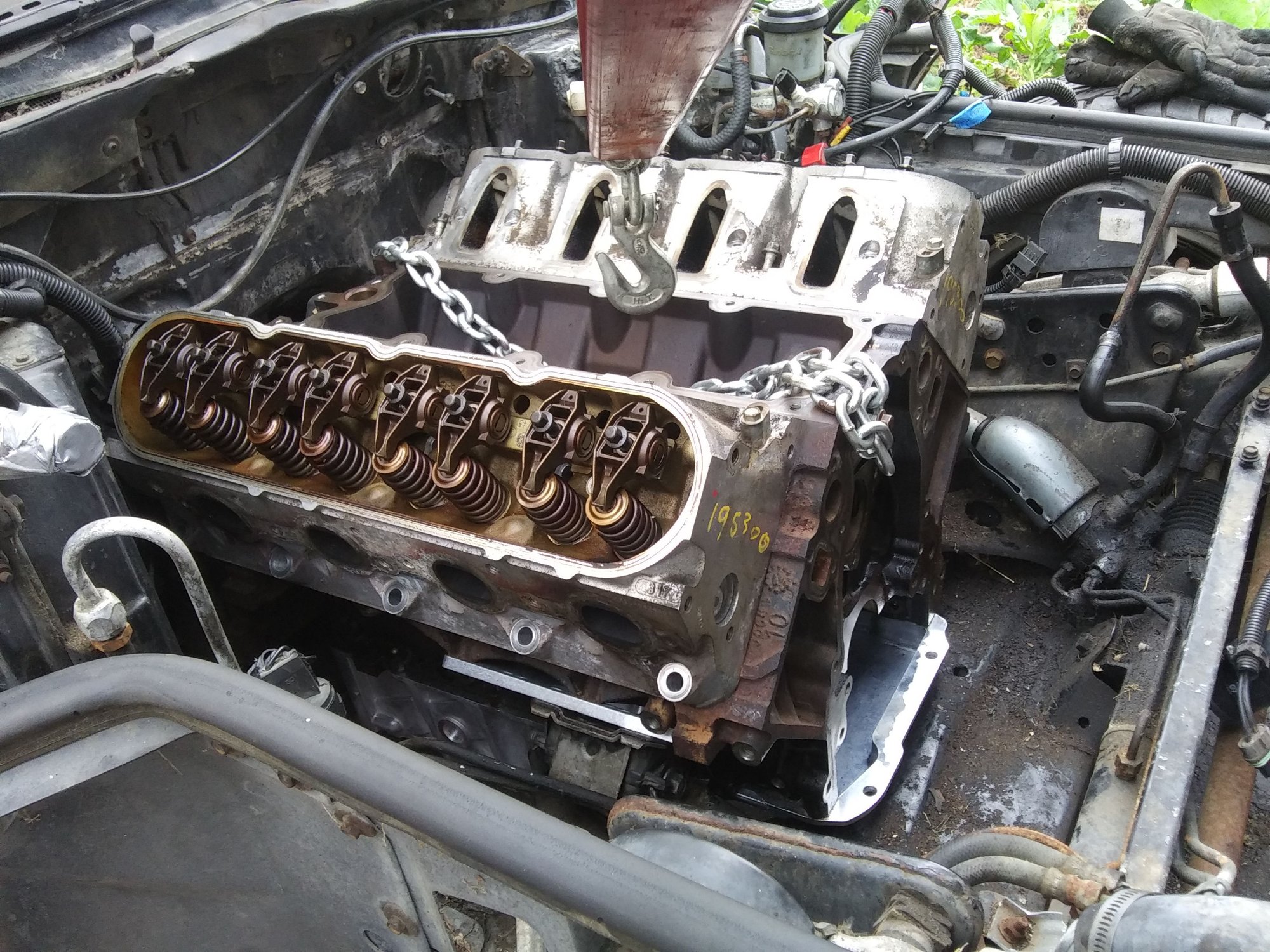

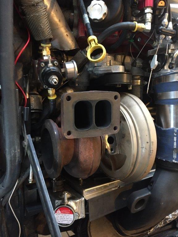

I found this old gem on my computer, my turbo test fit. The turbo is a tiny S480/T-6 1.32 a/r (large frame turbo). You could easily run a mid frame turbo on these C4's.

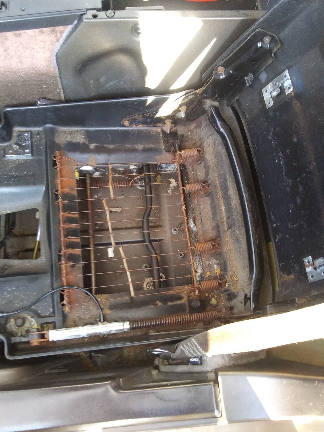

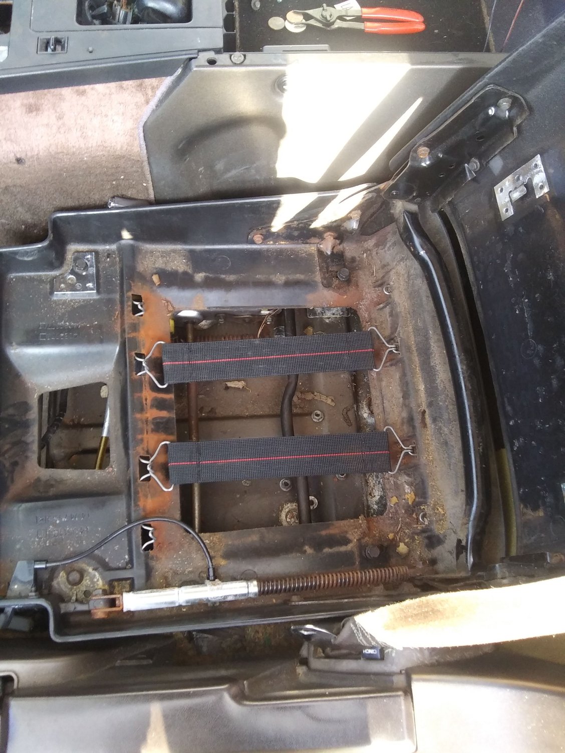

Small quick project today installed the seat cushion suspenders to replace the rusted metal stuff that used to be there
Driver side was mostly intact. Passenger side was dust

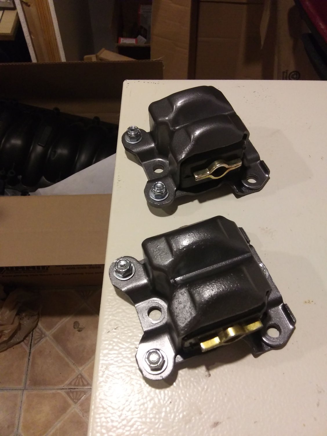

It took a few days here and there to clean the ridiculous amount of grease and grime and rust from the engine mount shells, but finally got them painted and prothane guts installed.
