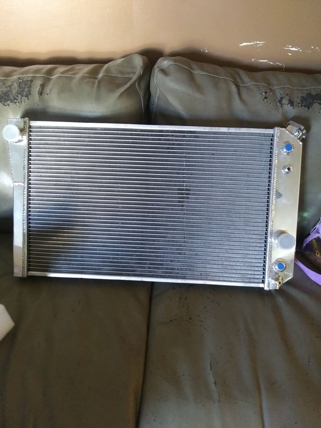

Recieved the new radiator this week, looks pretty solid in my opinion.
Old Sep 24, 2020 | 01:16 PM
  #259
Gibbles's Avatar
Gibbles
Joined: Mar 2015
Posts: 1,275
Likes: 165
From: Utah
I'm playing catch up here.
Looks like lots of progress made!
