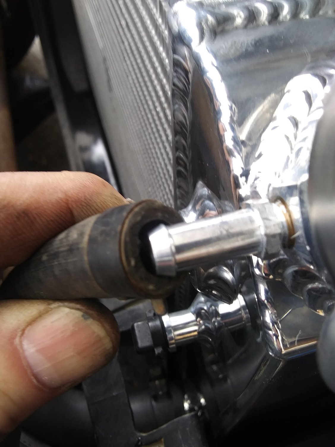

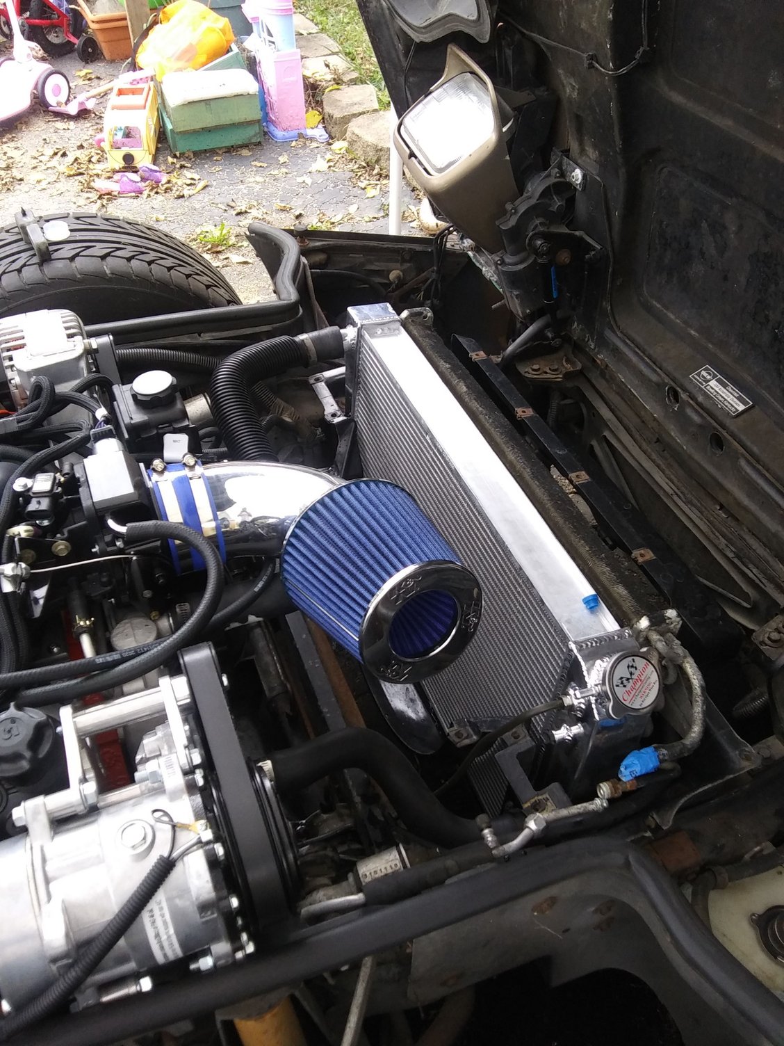

Finally got the new 3 row radiator in today. Its not 100% drop in, the rubber mounts need to be cut down and I expected that. Also had to trim one of the ears on the radiator cap to clear the radiator shroud. The nipple for the overflow is 5/16" so I had to make a custom hose to splice a 5/16" hose into a 3/8" hose. But its all together and doesnt leak. Need to burp it again and throw some antifreeze in it before it gets too cold.

In the second picture below the trans line there is a port coming out of the radiator that gets a plug. anyone know what this is called? I broke the ears off trying to get it out of the old radiator and will need a new one, I superglued them back on but not too confident it will hold.
The plug you are referring to is the coolant level sensor. The part number is 10054615. I definitely wouldn't trust it with both ears broken off...

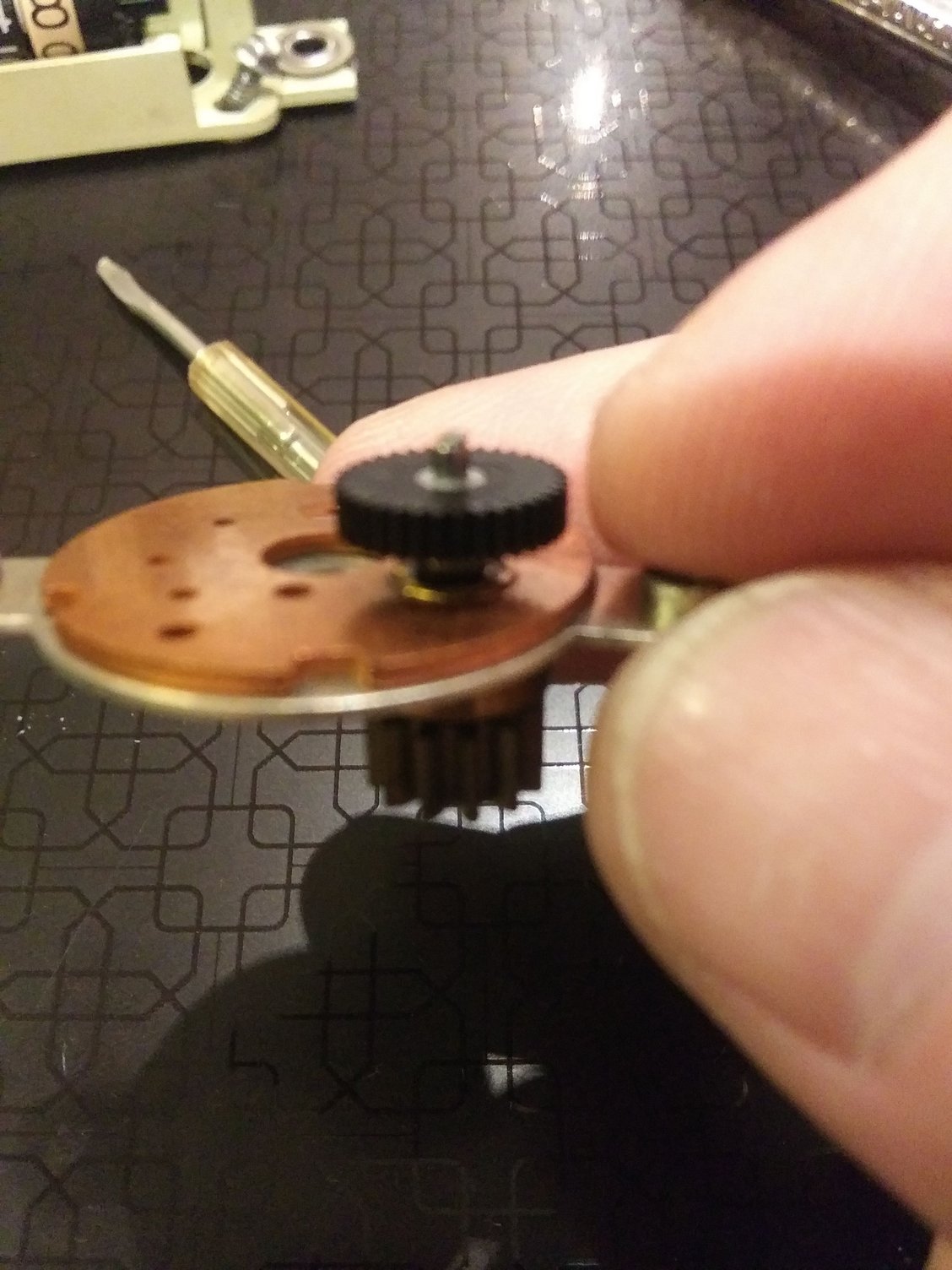

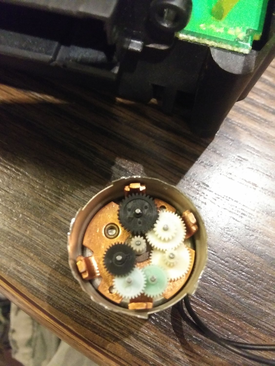

This week I was able to get the odometer working again. I ended up taking the motor apart to see if it was able to spin and it wasn't. I'm guessing that the grease inside the motor had become solid and prevented the armature from spinning. I freed it up by gently spinning the motor gear with a pair of pliers. Lots of tiny gears in there!

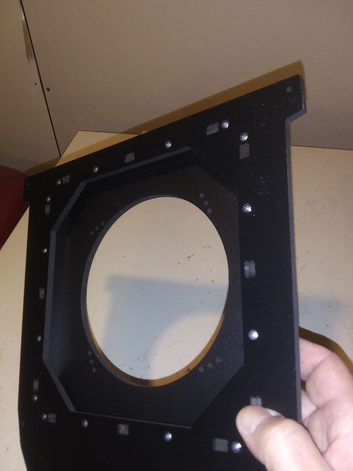

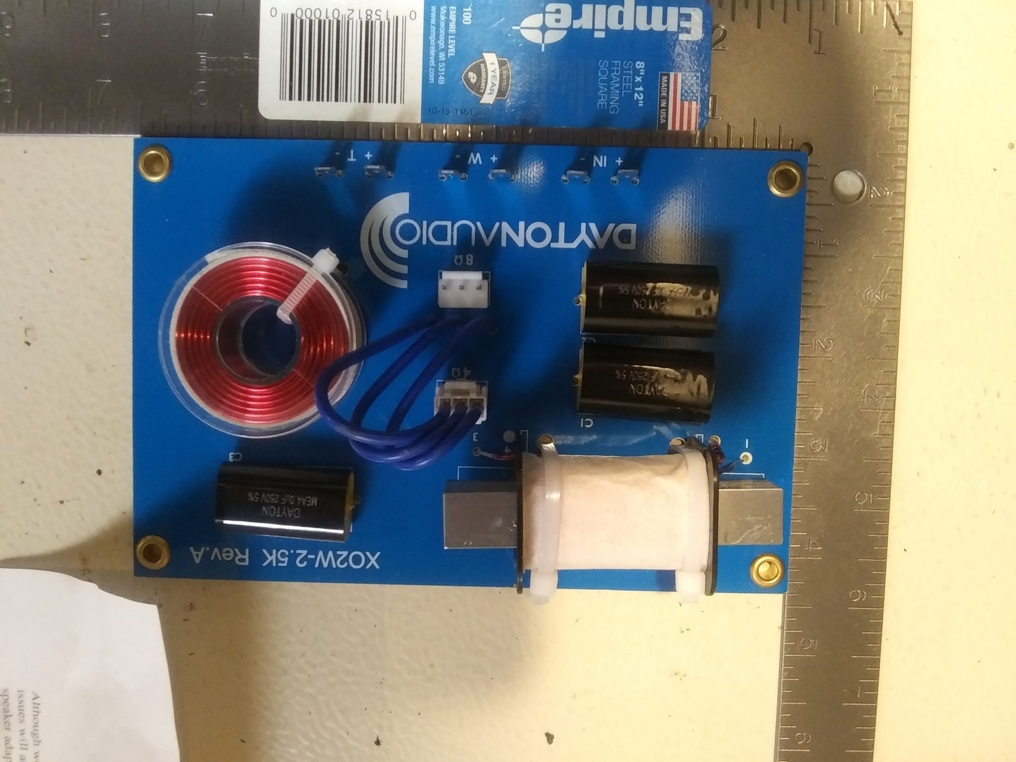

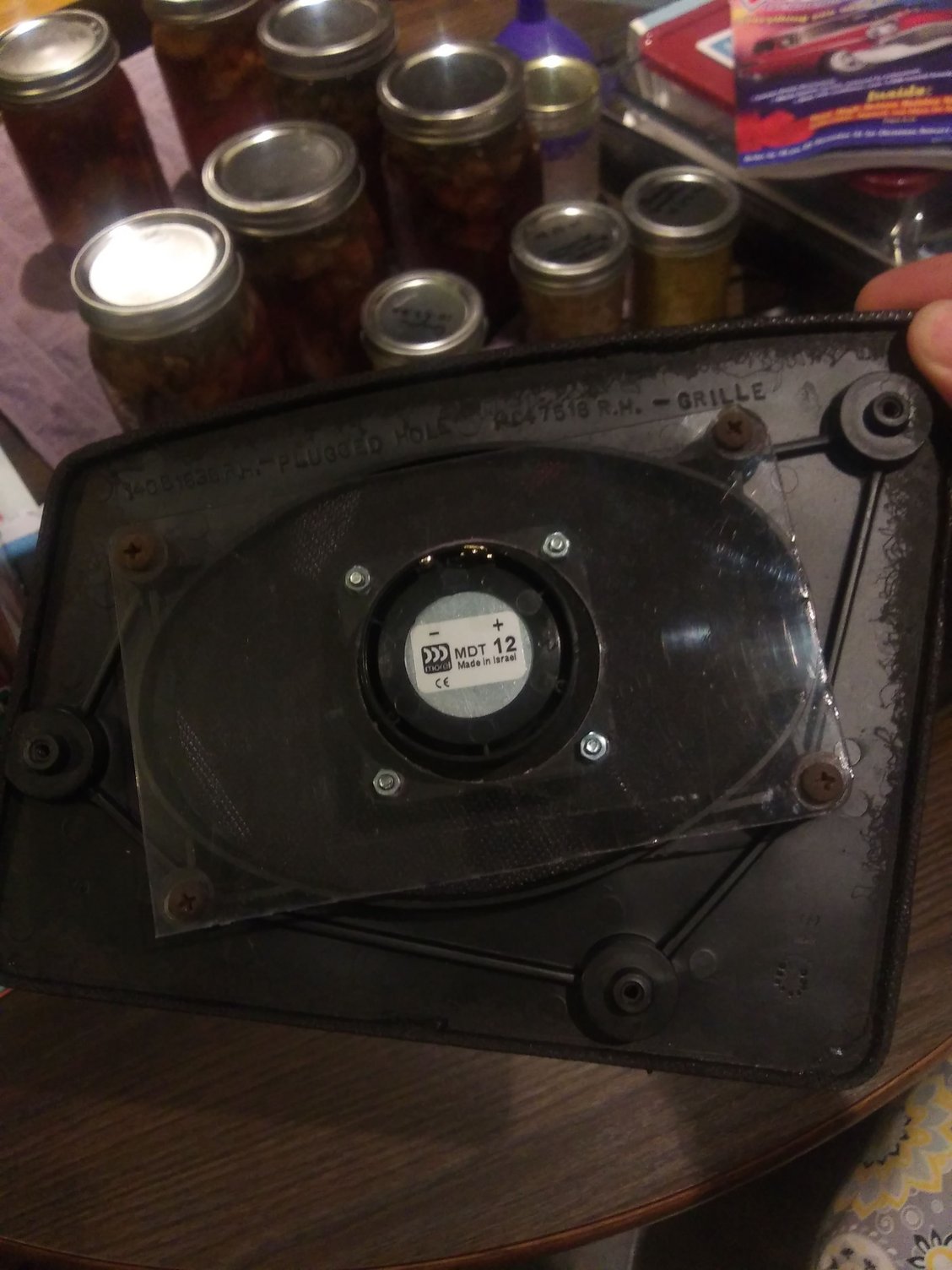

Over the past few months I decided I wanted to install new speakers in the doors and have tweeters in the dash. The previous owner had already removed the bose head unit and installed an alpine cd player which still works fine. They also installed 4x6 speakers in the dash which were junk when I removed them. My plan was to install 6 1/2" woofers in the doors and tweeters in the dash utilizing a 2 way crossover.
I bought these speaker plates off eBay. The speakers I used had larger magnets than your typical car speaker so I removed the spacers and reattached the 2 plates with screws and pvc cement.
The plates in the dash had already been cut out so I used a piece of hobby plastic I had laying around to mount the Morel tweeters
The Dayton crossovers are quite a bit larger than I was expecting them to be. However I think I can mount them under the dash board to the metal braces that support the front of the dash/instrument panel.
The door speakers were a little more involved. Removing the old bose speaker box and replacing with the adapters took some time and patience and some trimming of the door opening but they found their way in. These are Goldwood GW-6024 6 1/2" speakers from Parts Express.
The original speaker wiring appeared to be fine so I reused it and just soldered the connections to the speaker to prevent any corrosion from interfering with the connections.
I havent finished this project yet but I expect the sound quality to be greatly improved over the bose system. I'll be doing something similar at the rear, maybe with 8" speakers and a 3 way setup.
