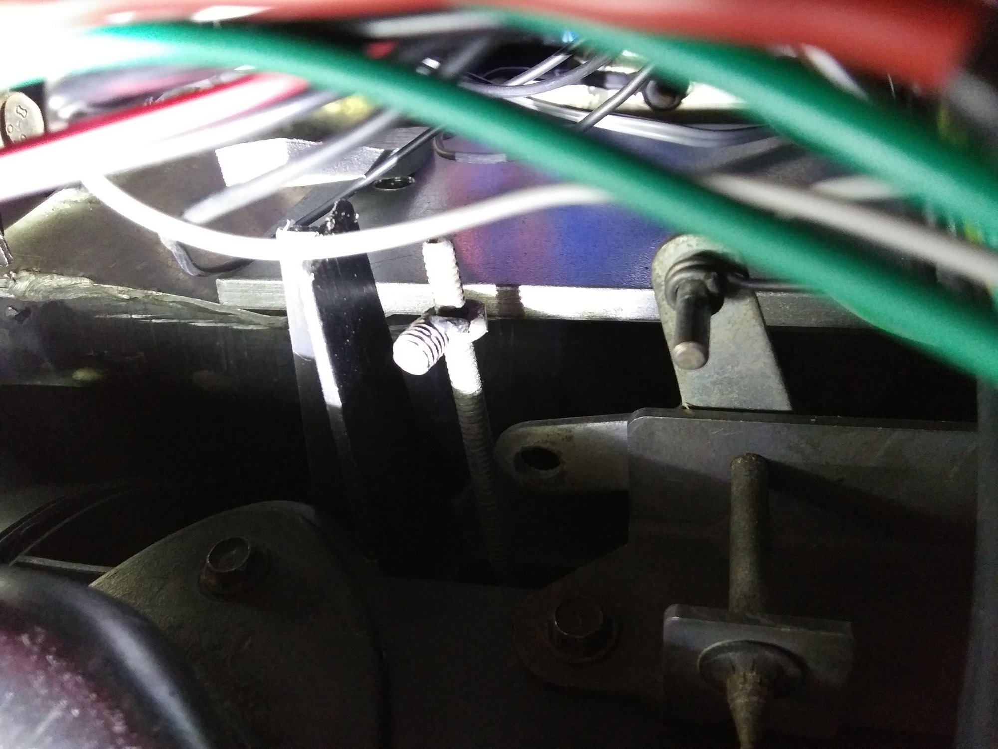

OK so.....something wasnt adding up so I crawled back under the dash, moved all the FI wiring out of the way and found that the blend door threaded rod had come out of the plastic clip that links the rod to the cable. Not sure why that happened but I cant push the clip back into the bracket with the threaded rod threaded onto it. So I'm going the make a custom "clip" and use nuts on either side for adjustment. Pictures coming

Ended up welding a #10-24 nut to a 6mm bolt with the head cut off. It was a bitch getting it threaded onto the actuator rod and trying to turn it with one hand from underneath. But it should outlast the car and now I have nice warm heat!

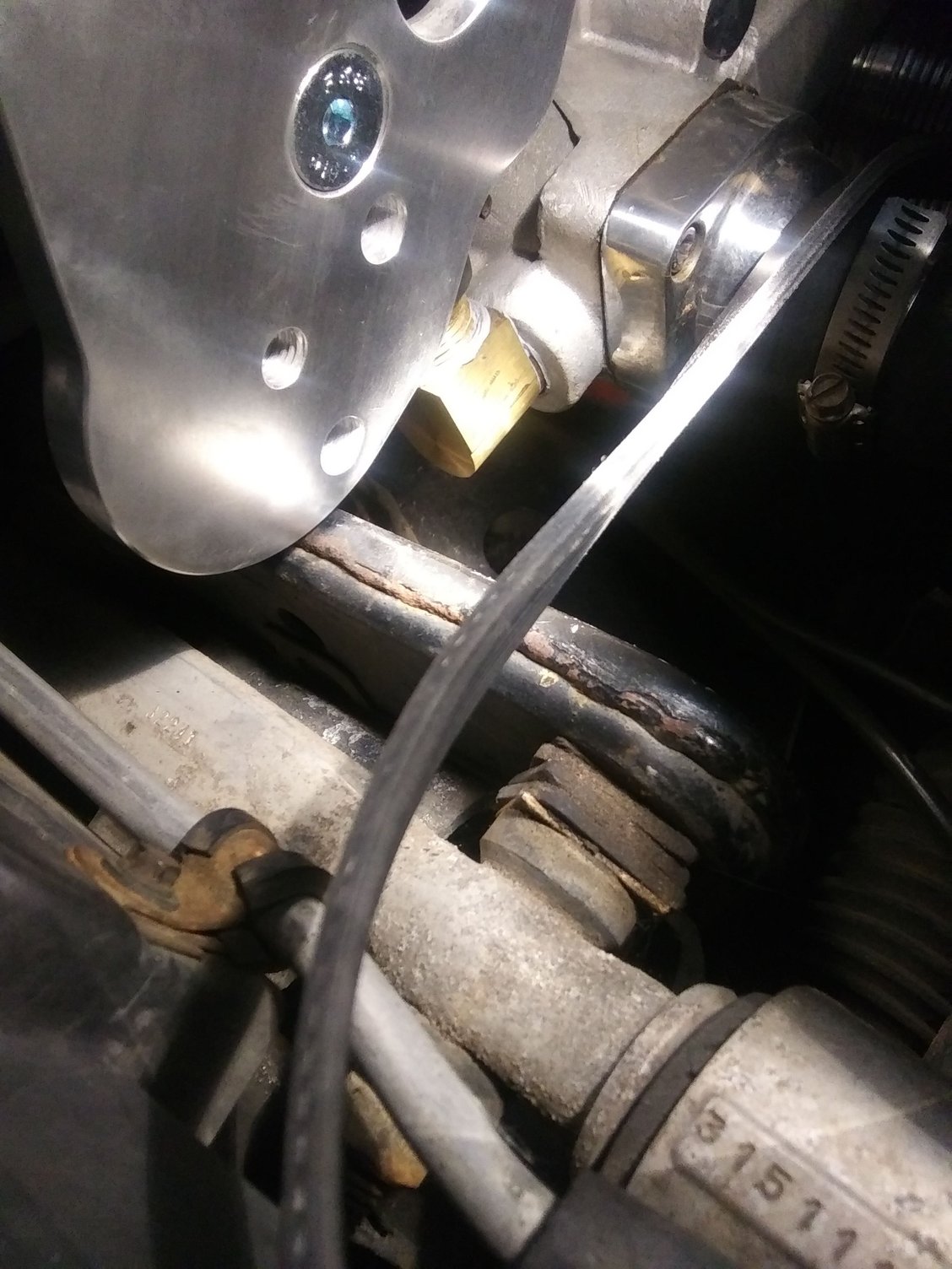

Not gonna work. The tensioner bolts on right where the bracket hits the frame and sticks out about 2 inches. Tech support was very responsive but kept showing my pics of a C3. Sending it back tomorrow and at this point I'll modify the ICT bracket.

Correction: my brackets are 3/8" so around $23 hopefully I can have my cnc guy at work run them out for me. I made a paper template to move the compressor in about 3/4" which is as far as it can go without hitting the tensioner. Now I need to transfer it to CAD and make a digital drawing.

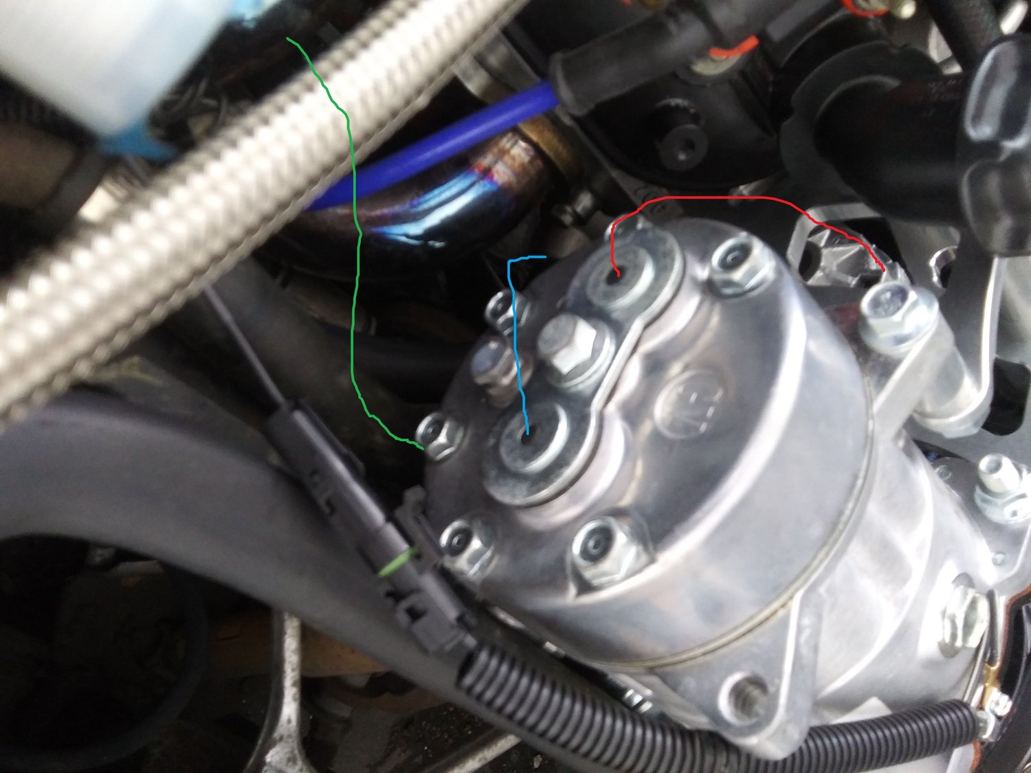

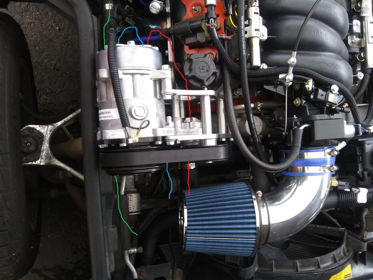

I think I may have a plan on the ac lines, if I can get them bent in the right direction
The green line is from the core and goes under the compressor after I do some trim work to the heater hoses. Red line goes through the brackets and blue line goes under the compressor, also after trimming heater hoses
Sorry for the rotated photos but I had to rotate them in paint to mark them up correctly.
I'll still try to get the compressor moved in about 3/4" with my redesigned brackets, if I can get them made. Now I need to find some fitting and see what I can do. Another thing I'll need to do is relocate the air filter, its not in an ideal spot anyway and won't allow me to install the receiver/dryer can.
