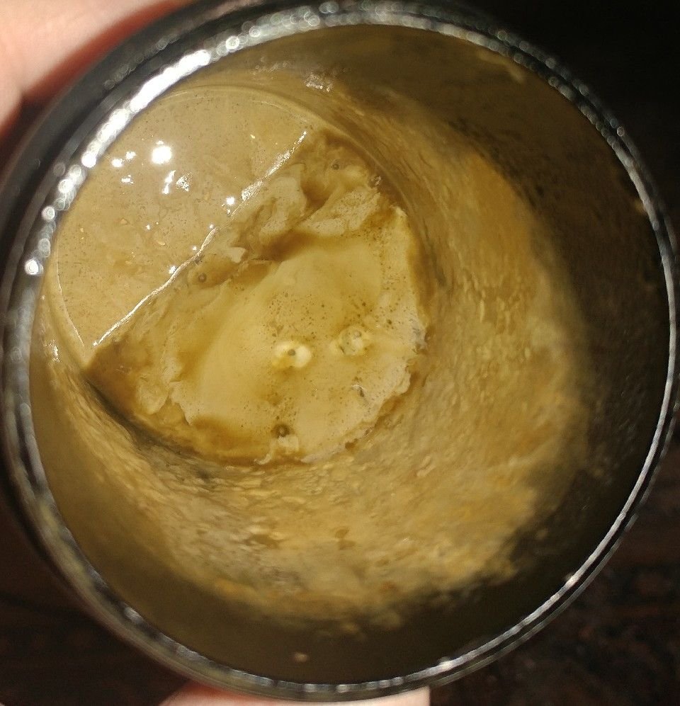

Something im seeing a bit regularly now. Some moisture at the oil fill cap and some light brown spots. I fear that my 706 castech heads are leaking some water into the oil even though theres no signs of water on the dipstick. Considering a set of 799 ebay heads and switching valve springs from my heads. Short of pulling the valve covers is there any other way of knowing if these heads are leakers? The machine shop where i had them serviced said they checked out fine with the pressure check.
Oh man, i'm sorry to hear this. Did you get the block decked before you did the rebuild? just wondering because the other thing it could be is a bad head gasket seal if the block deck wasn't quite level.... Hope it turns out to be something minor.

What is your pvc set up like or how are you venting the crankcase?
Any oil in the coolant? Loosing any coolant? Or are you just finding the film on the oil cap?
It could be that you just aren't running it long enough to get all the condensation out. It will collect on the underside of the oil cap when it is cold outside and doesn't get up to temp.
I run a catch can. Both valve covers are plumbed to it and it has a breather cap on it. When late fall hits, and we get cool weather I have to empty it quite regularly. Fills up with condesation and oil film. The rest of the year when it is 70 or above out when I am driving it a lot, the catch can stays empty. Just a little bit of oil in it.
Here is what it looked like today. Last time I drove her it was in the low 50s all night.

Im not losing any coolant and it looks clean. My pvc system is almost like stock, what i did was i pulled the nipple out of the valve cover on the driver side, cut down the valve cover to clear the wiper motor, then threaded a 3/8" 90 degree elbow into the intake side, then plumbed the nipple inline with the 3/8" hose to the throttle body. Passenger side hooked up as usual to the port in front of the throttle blade.
i noticed the light brown residue before and i wiped it off and it stayed gone until recently. I also havent driven it lately just started it up a few times. Krusty i hope youre right and it just needs to be driven

Thanks blackvetter, its been quite a journey. Im not totally convinced that the heads are junk yet. Gonna get it out tomorrow and put some miles on it to see if the condensation goes away. If not I'll be looking at some 799 heads. I should have done more research on the castechs but my shop said they were fine. We'll see

Took Solid Gold out for a 20 mile spin this afternoon and no more signs of the tan residue. There was more water under the oil cap so I'm convinced its condensation but I dont think I've ever seen this before on the older engines.
