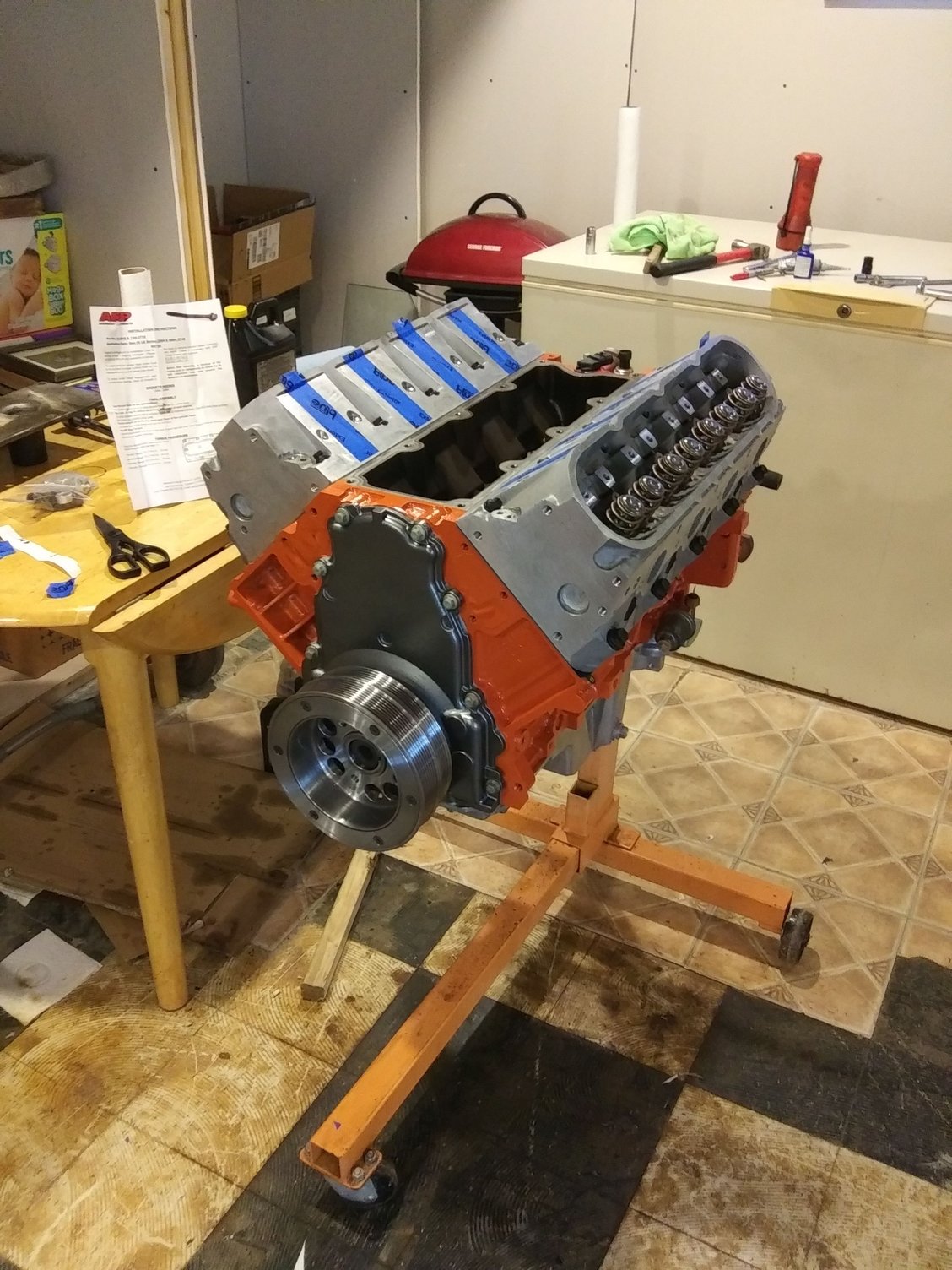

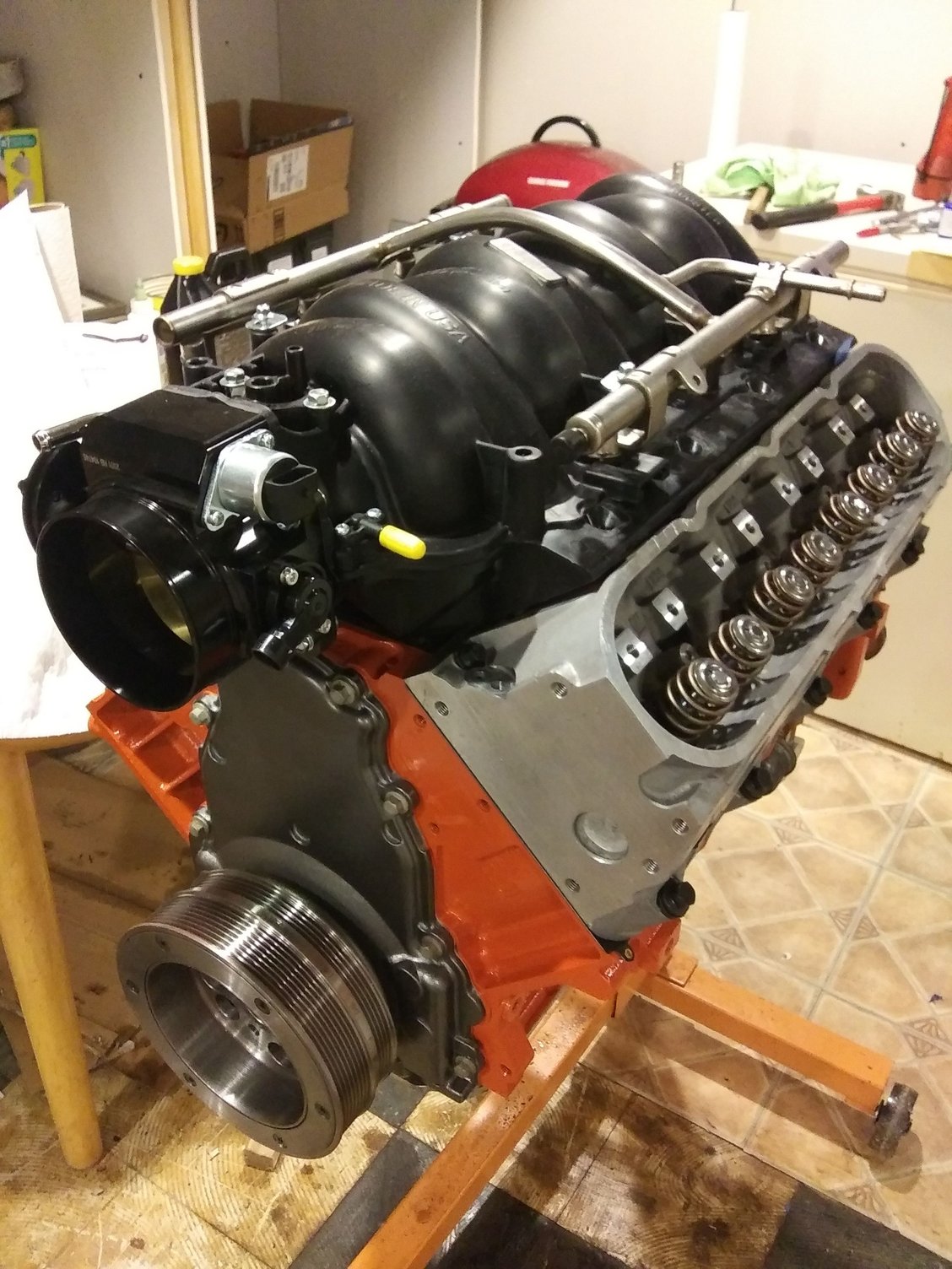

I was able to get the heads on last night after painting the block, removing a broken stud and drill and tap for the 85 temp sensor. Tossed on the intake for the photo op. Making progress!

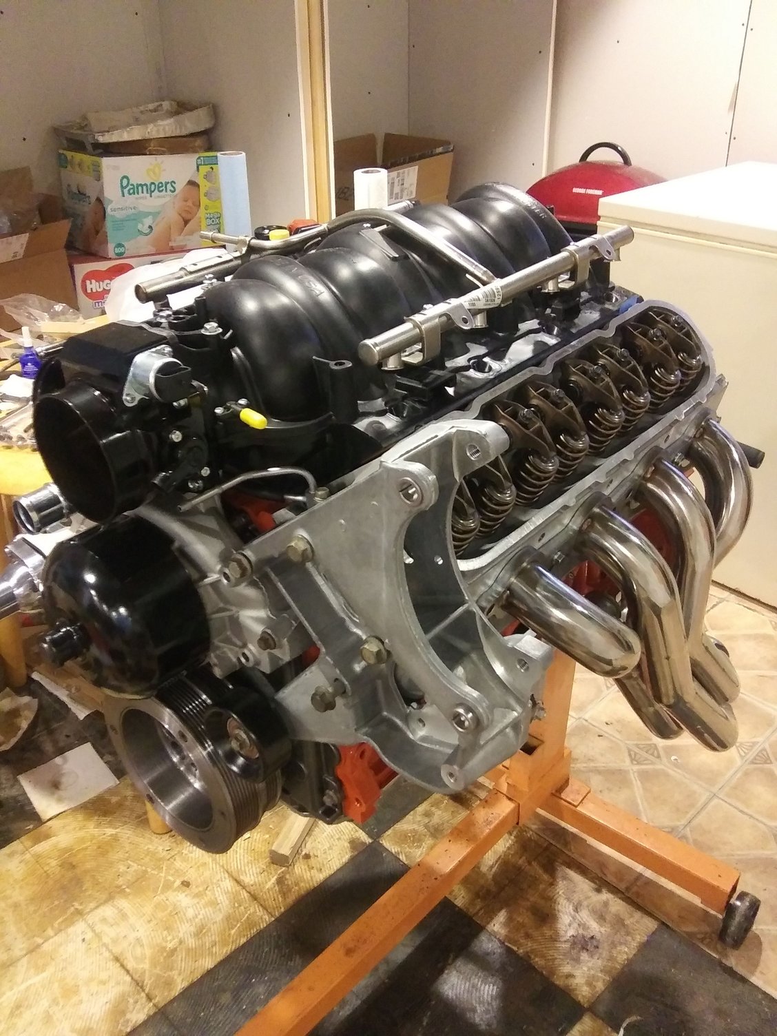

Cheap Amazon headers fit well and test fitting the Holley O2 sensor seems to fit either side so I got options. Just pulled out the main harness that connects on the driver side for cleanup, rewire and wrap. Anyone have ideas on how to connect a C5 alternator to a C4 harness?

Wow Bandit, your making some pretty decent progress. Those headers are going to have to adjusted (modified) as they will come into contact with your 4L65 transmission. C5/C6 have the transmission at the rear of the car and there is a bell housing/torque tube at the rear of the engine. I think Kusty has some pictures to show you the required mods. I ran shortie headers with 3in exhaust, so mine fit pretty easy.

Yep I read through another link authored by pwnage where he modded his cheapie headers and that's where I got the idea. I'm hoping to not have to ding them like he did since they are "stainless" (we'll see about that) and look nice at the moment.

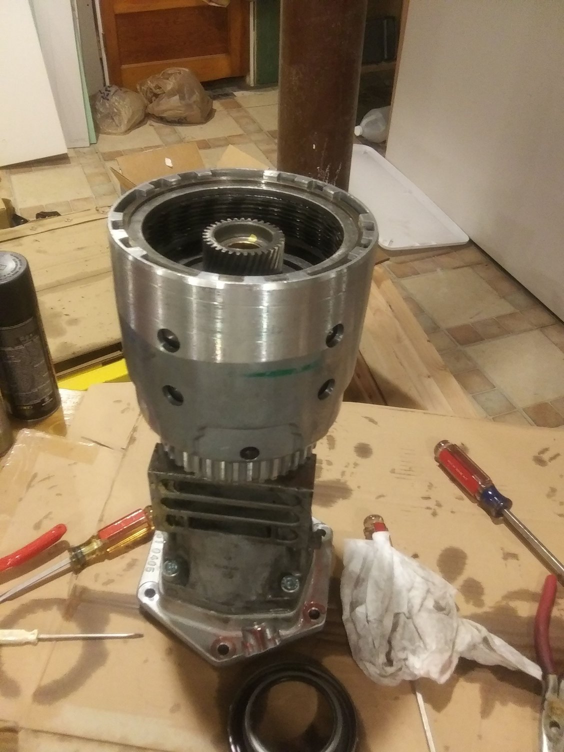

Surprise! My alto kit came this morning, wasn't due til late next week so while my wife and daughter went to the produce market i got to work. I was able to assemble the input drum clutches and clean and reassemble the valve body and get all the bushings pressed in. I am very impressed with this kit so far and it comes with the 9 friction 3-4 clutch pack which also makes me happy. Clearance is good with about .032" . I did however manage to destroy the reverse input clutch seals before I figured out a good way to install that piston. New seals will be here Tuesday and I'll detail how I got it in at that point. I am hoping to finish the trans by the end of next week, paint it and then consider buying a $500 torque convertor.
Old May 16, 2020 | 10:23 PM
  #95
banditt1979's Avatar
banditt1979
Joined: Jan 2013
Posts: 403
Likes: 87
From: Cincinnati OH

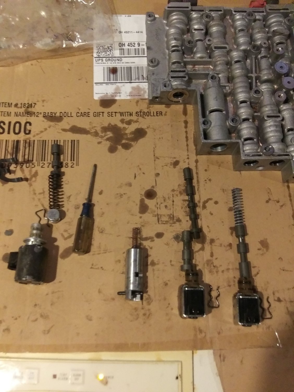

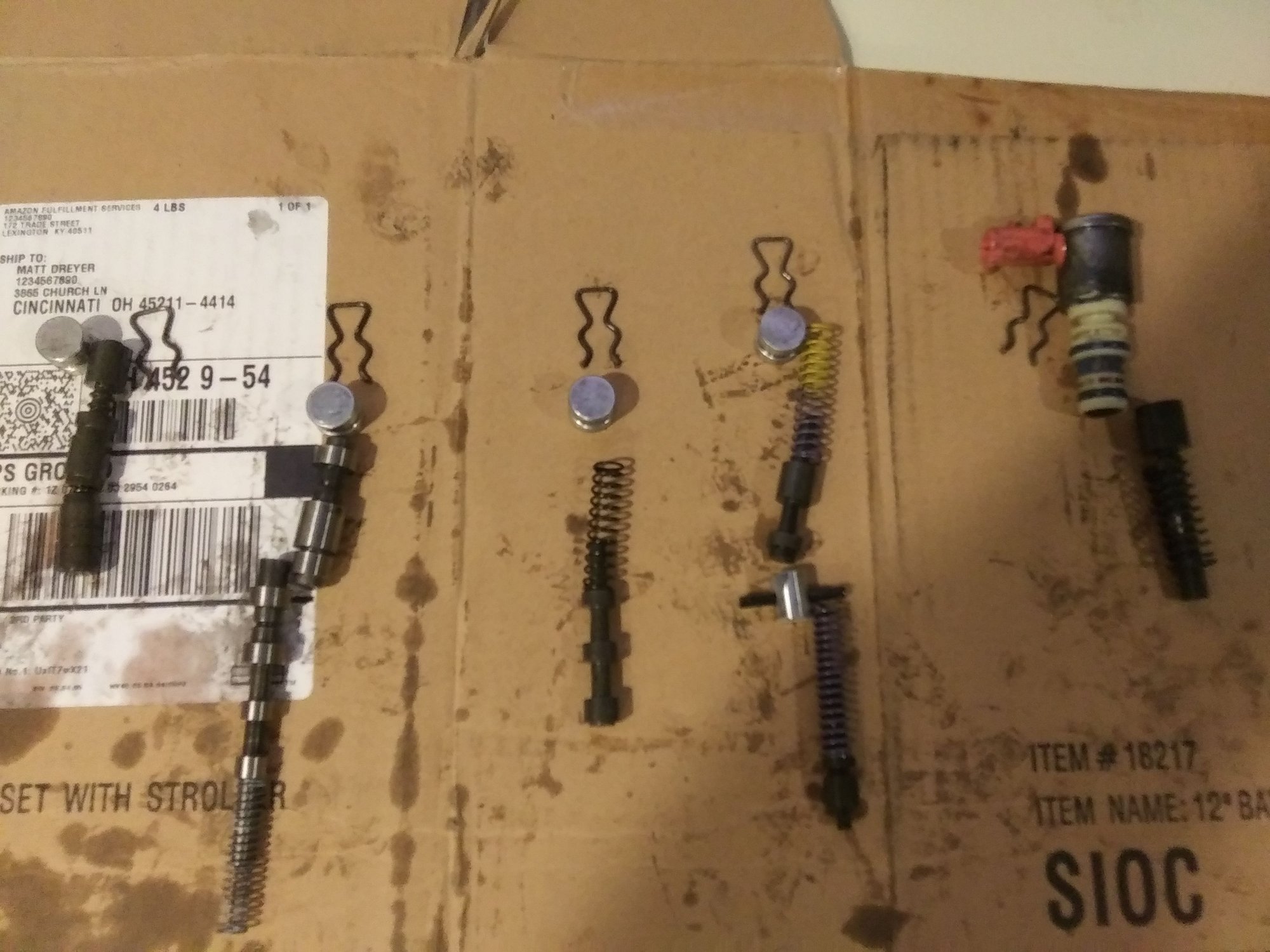

Some pics from today
Valve body layout
Valve body layout
Input drum assembled for the second time both the video I watched and haynes manual were for different versions but I eventually figured it out

Thank you, it's really not too difficult, just have to put it back together in reverse of disassembly and there's a few things to check such as clutch plate clearances, planet gears, and a few others. Some of the check ***** can wedge themselves into the separator plate, one on this one was almost about to do that so I bought a kit to fix that as well.

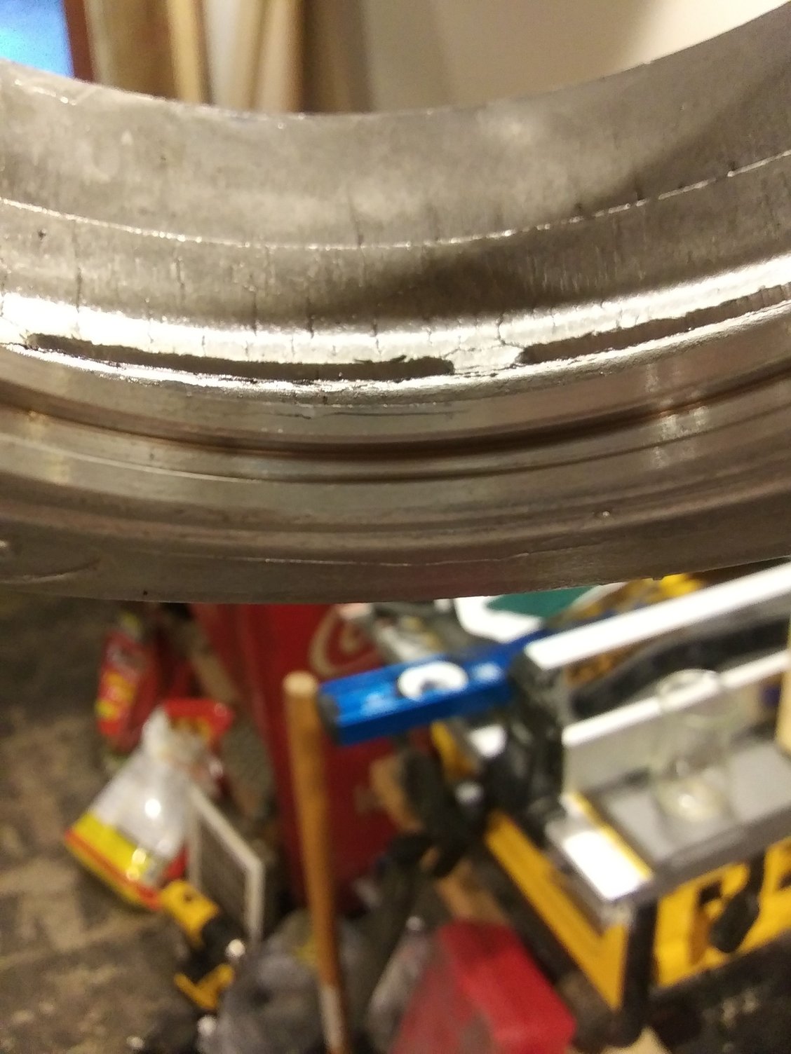

Irritating update. Found a crack in the low reverse clutch piston at lunch (working from home has some benefits) confirmed the crack by checking it with a pair of pliers. IDK what the impact would be if I installed as is but not taking chances here. Found a good used one for 19 bucks on ebay, was supposed to deliver this Saturday but their server was down for a few hours and when it came back up it said next Tuesday. If I have to wait til Tuesday so be it, just glad I found the crack before something bad happened 👌
Seal crack was much wider before I squeezed it with pliers
This imperfection is what made me take a closer look
