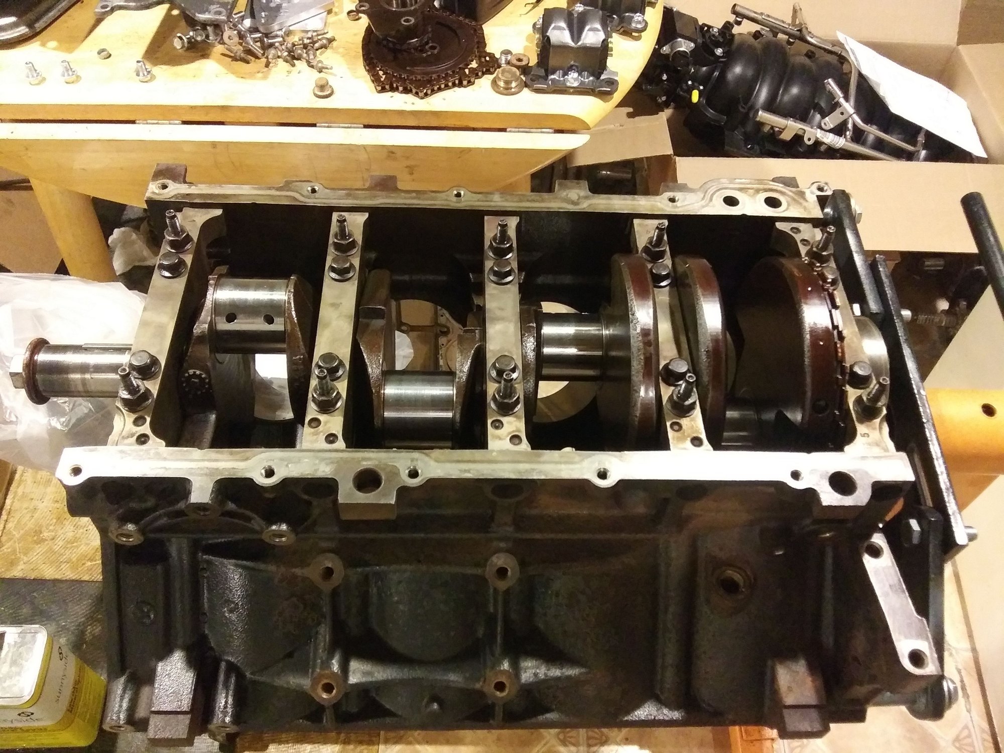

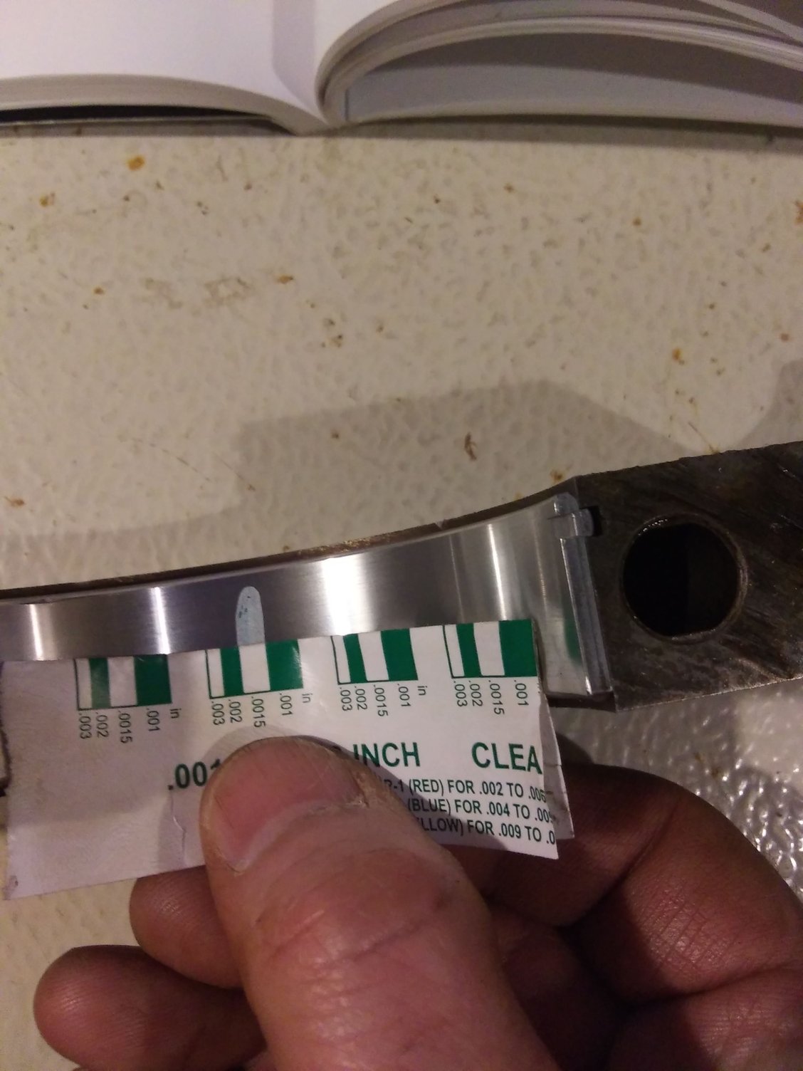

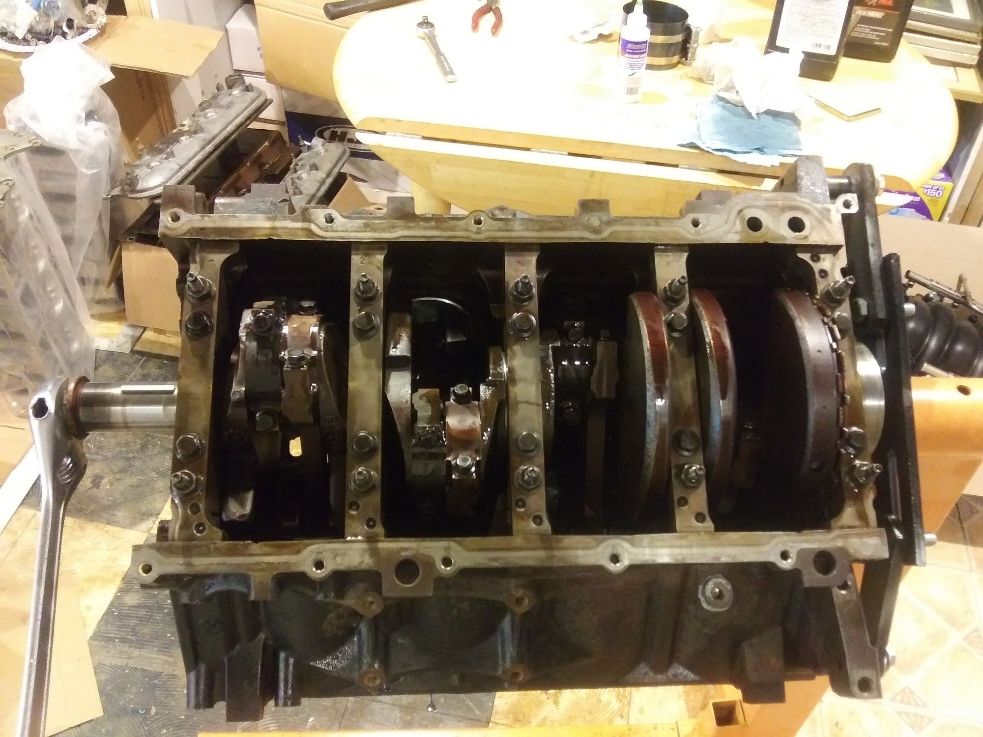

I was able to locate some green plastigage last night and today I was able to go through all 5 main bearings. Anywhere from .001 to .0015 clearance. Calling it good!

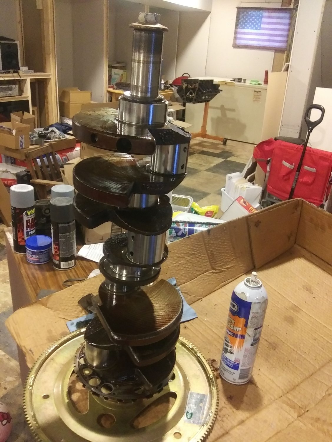

I got the block brushed clean, gave the crank a final degrease and scrub with a scotchbrite pad, hot water bath then a bath in wd40, and another run through the passages with the brush. Wiped all the excess wd40 from the crank with my hands since I currently dont have a roll of lint free towels. I'm using lucas semi synthetic engine assembly lube. Went together well and spins great. All downhill from here

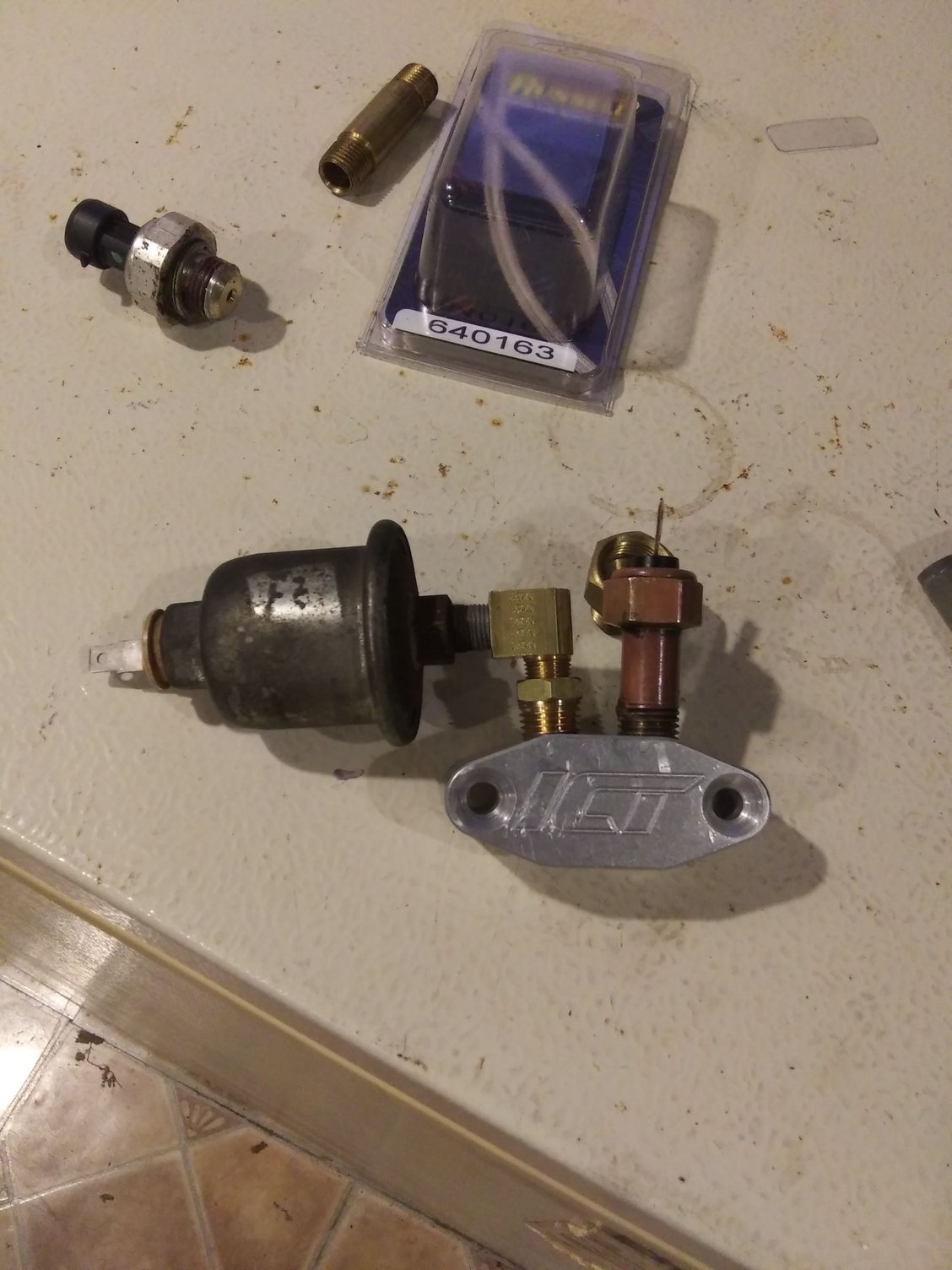

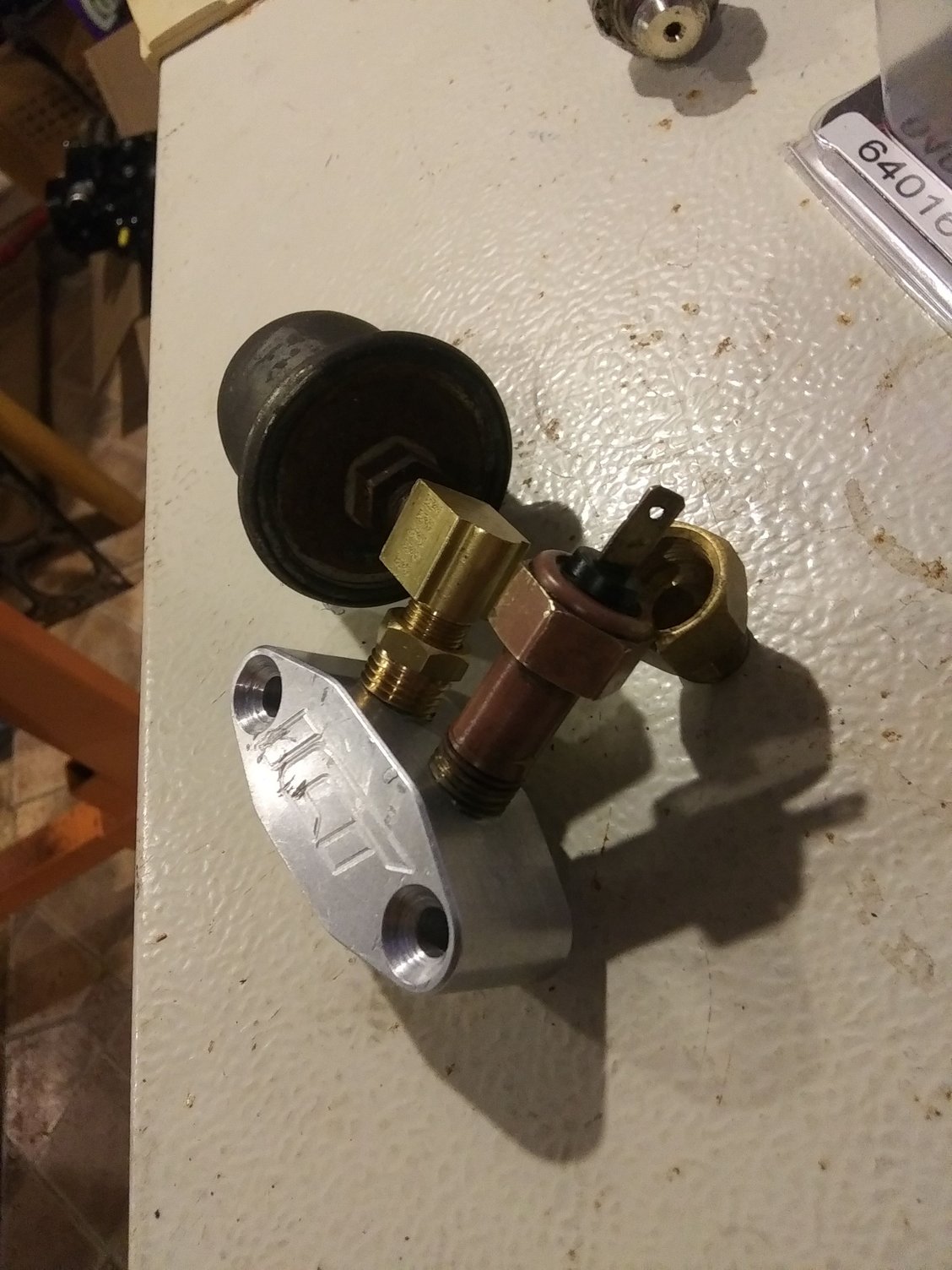

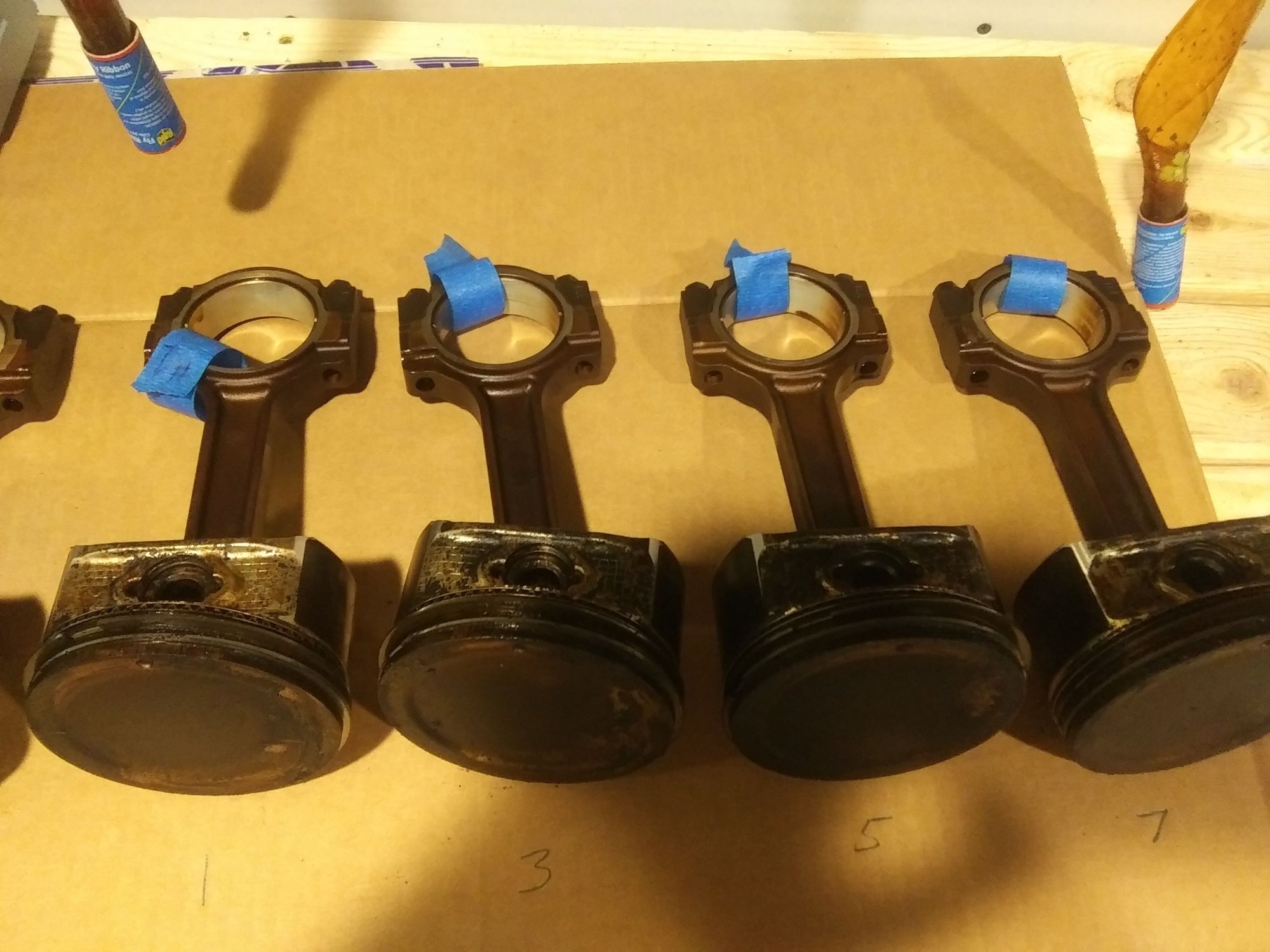

So while my pistons soak in a can of berrymans chem clean (one at a time, 4 hours each seems to do the job) I drilled and tapped this little guy from ICT Billet for 1/4" NPT threads for the factory oil sensors. I think it'll work. Scratched it up a bit not thinking I should wrap it in tape before putting it in a vise, but its down low so no big deal I guess.

Nice, that's how I did my temp sensor. I put my oil pressure in the factory SBC position near the cam sensor.

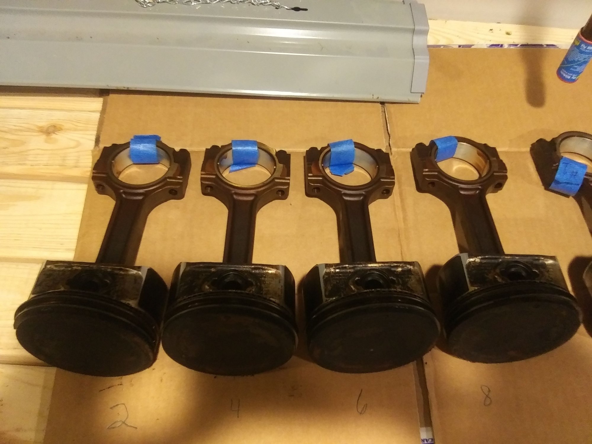

Likes: 87
From: Cincinnati OH

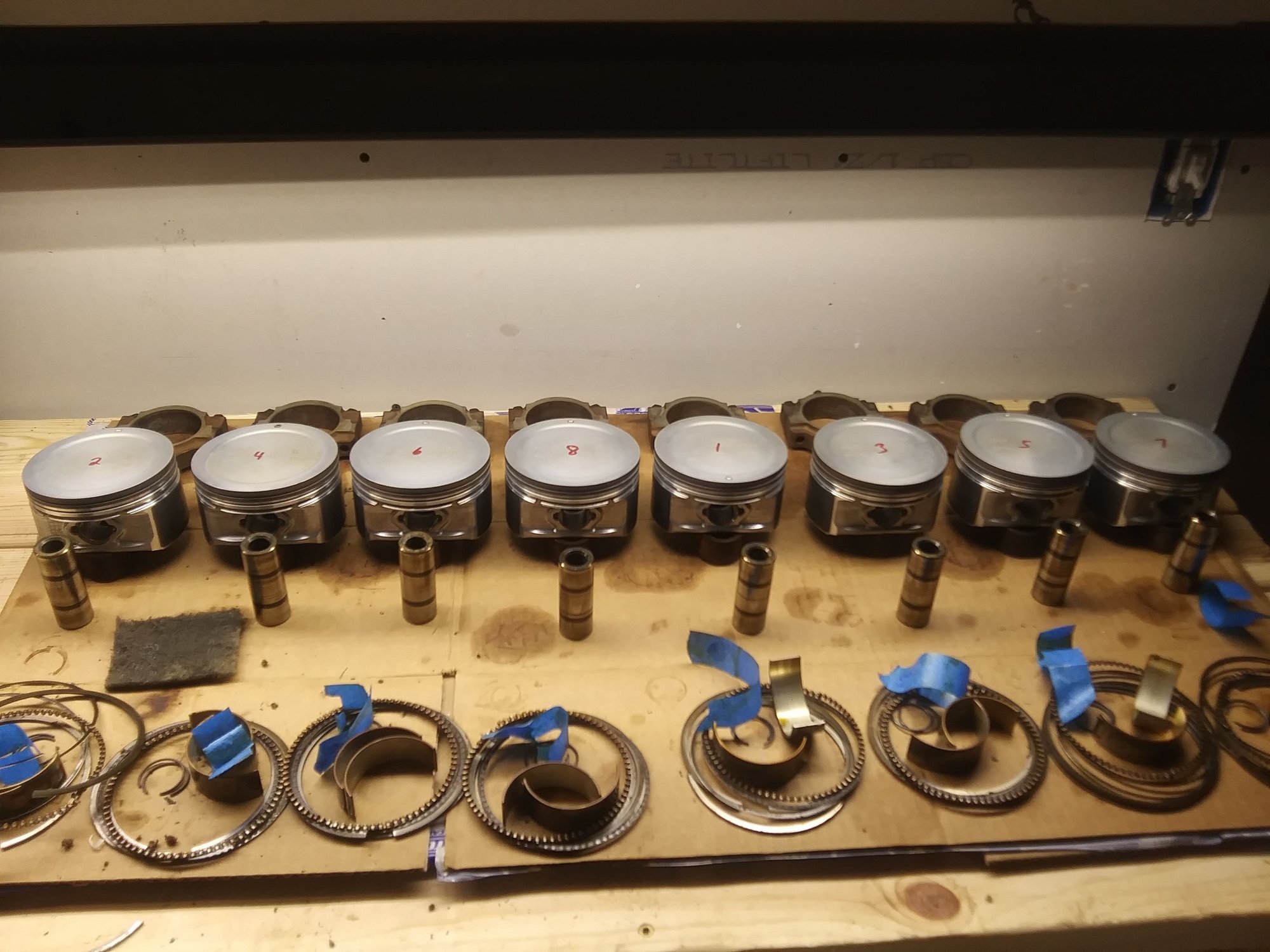

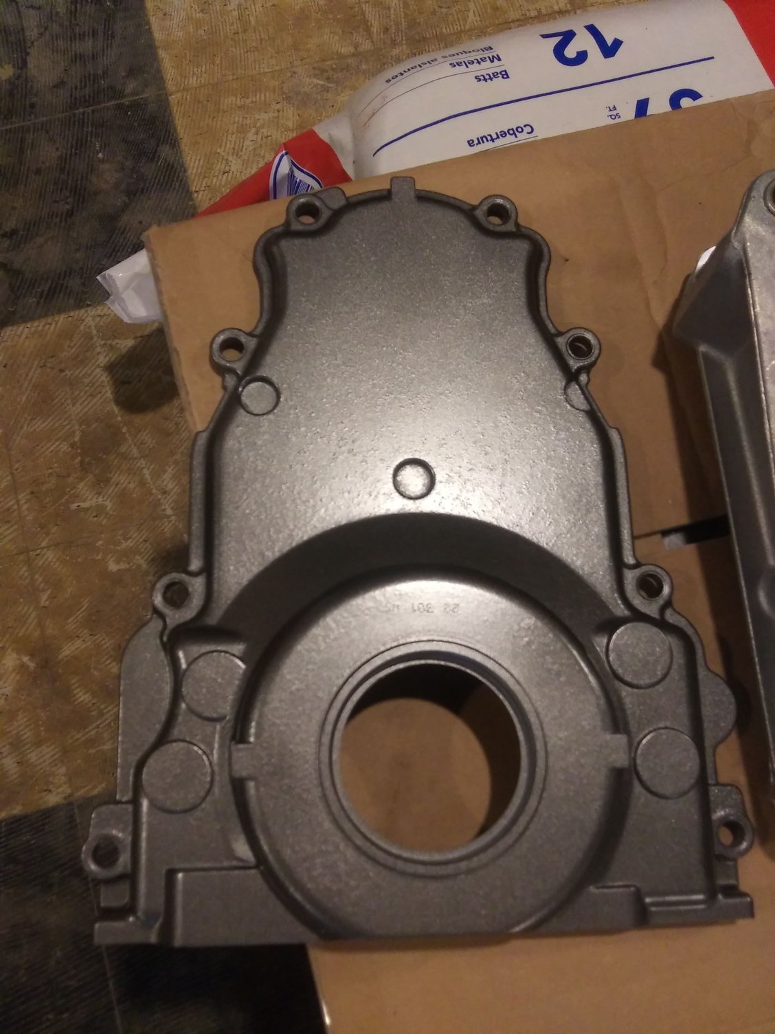

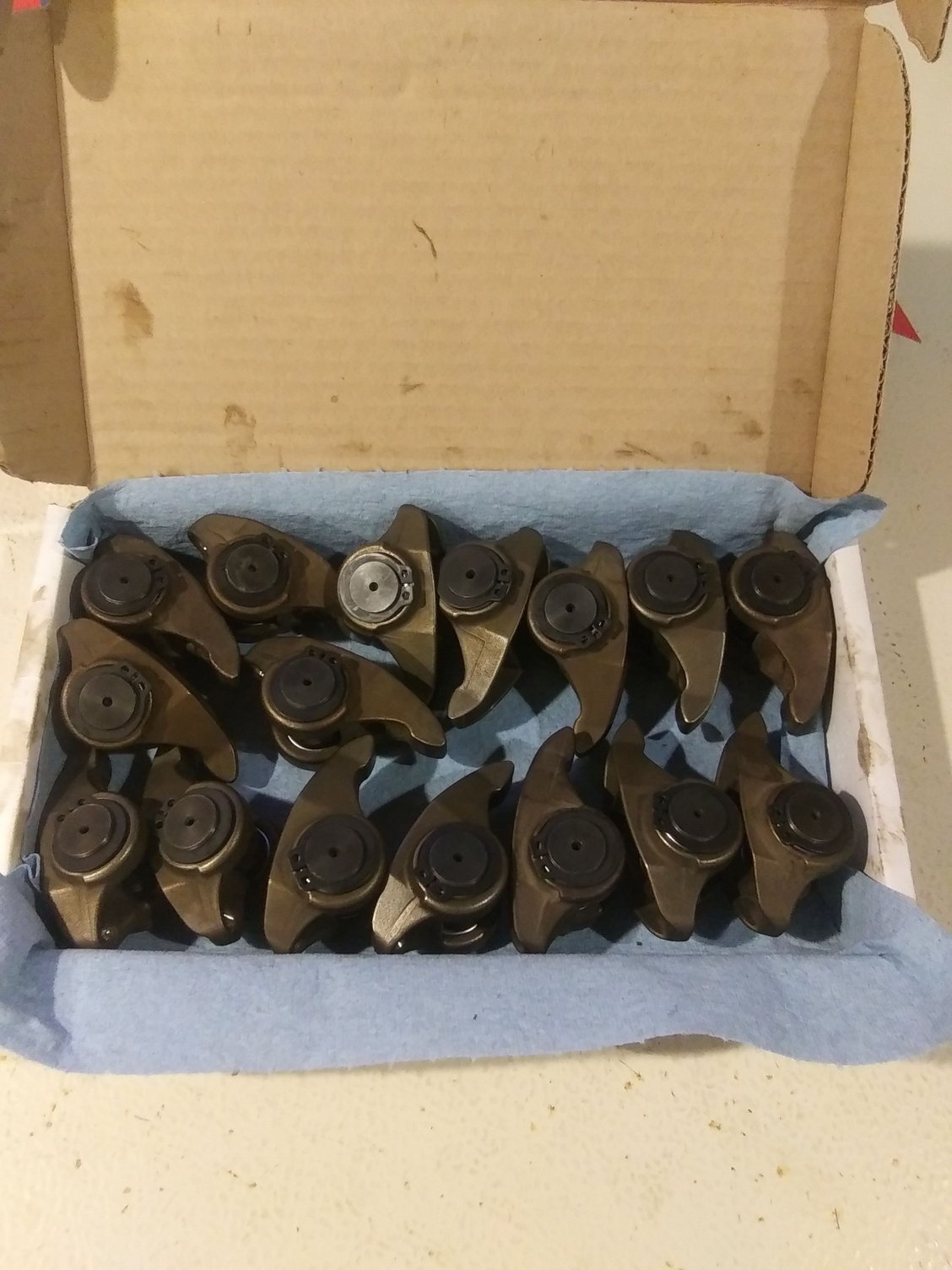

Made some more progress, finally all the pistons, pins and rods are clean. Finished up my rockers using the Brian Tooley trunnion upgrade kit which was super easy with a press, and cleaned and painted the front timing cover.
I also used #1 cylinder and piston to check ring gaps and top ring is .018 and bottom ring is .022. From what I've read that is damn near perfect.

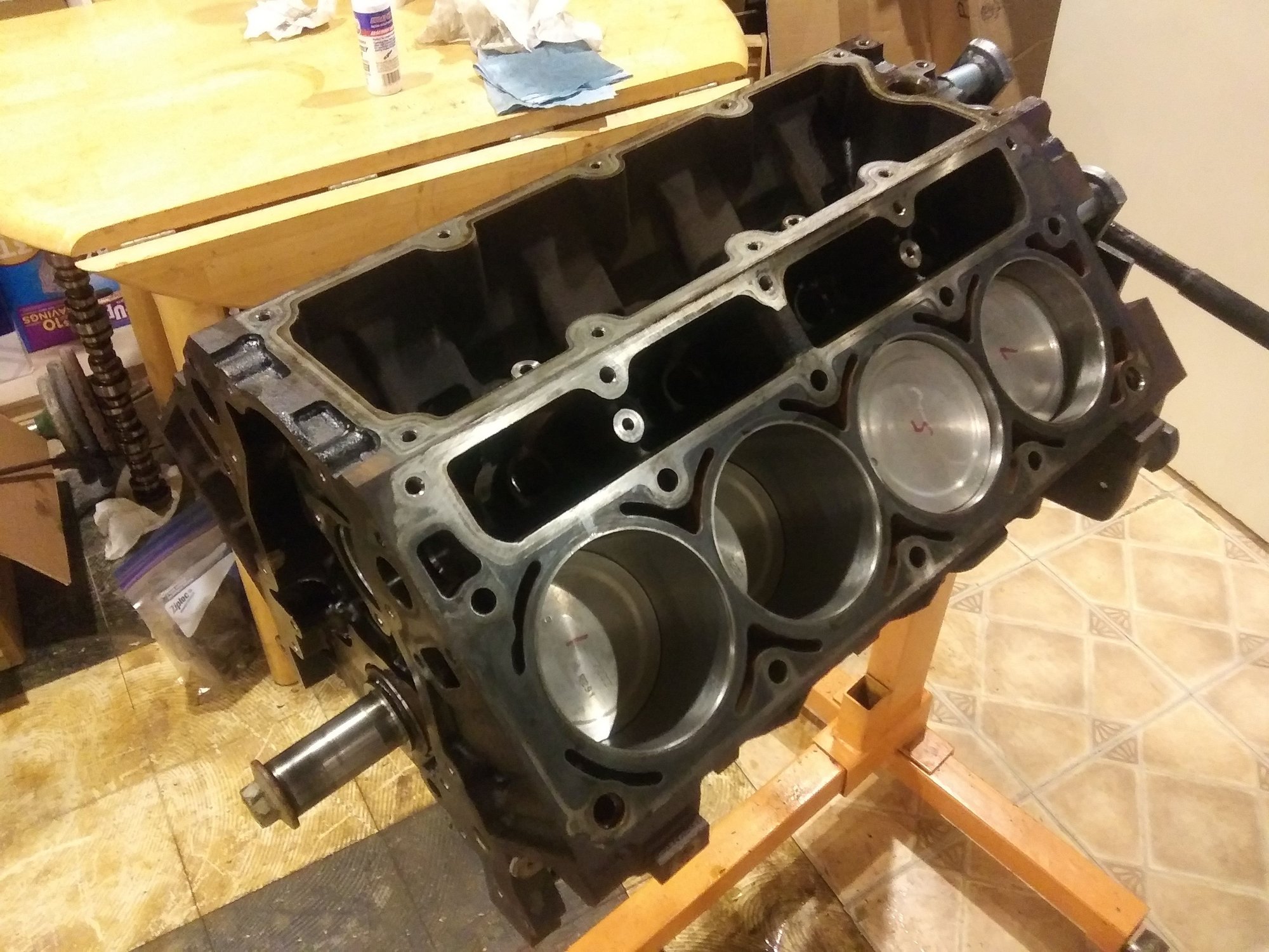

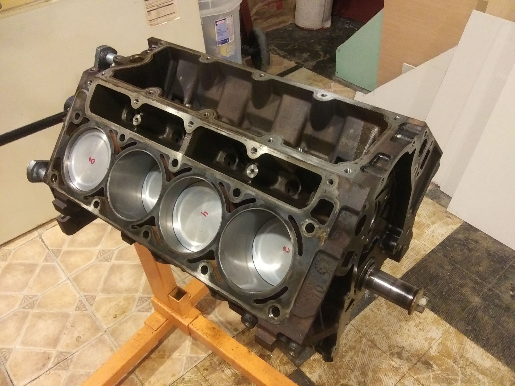

Today I got the pistons in. My crappy ring compressor tried to stop me but I prevailed. 2 1/2 hours to install rings, bearings, and final torque plus angle. Good quarantine times!

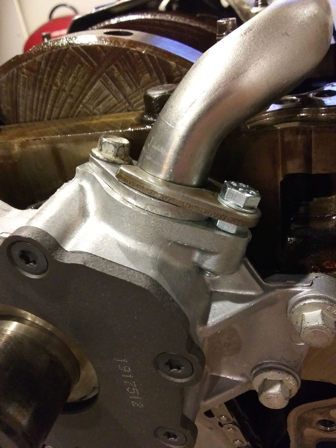

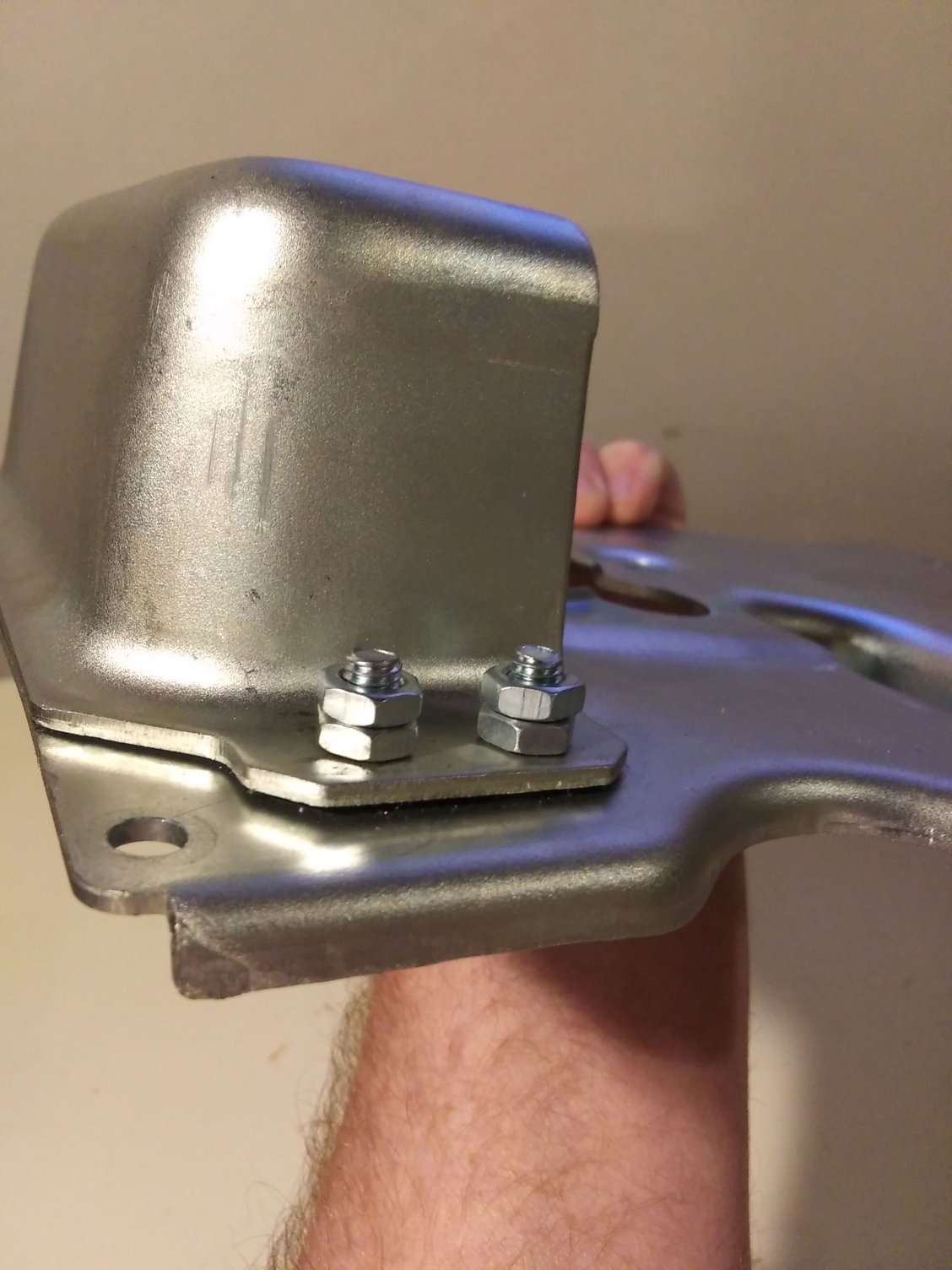

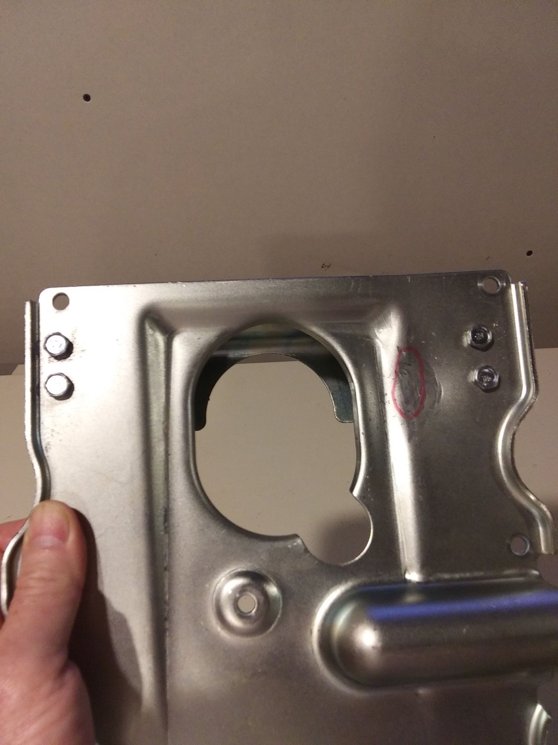

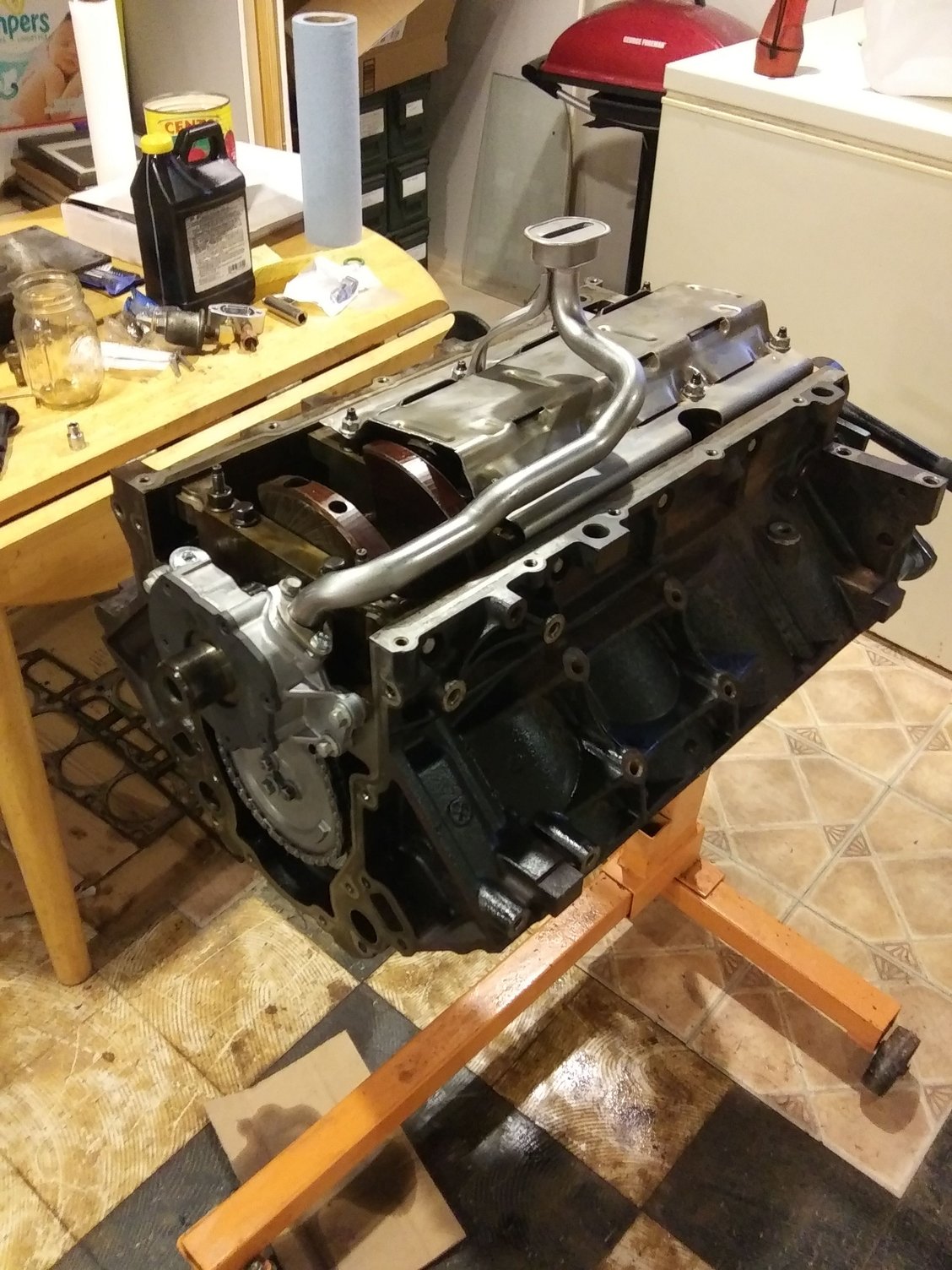

I modified my lq4 wind age tray to mimic the f body tray and it worked with my f body oil pan. Not so much with my oil pickup. Had to do some clearancing on the wind age tray to get the bracket to fit down right. No big deal. Then after test fitting the oil pan I discovered that the pick up tube was hitting the baffle in the pan, so I removed the baffle and did some more clearancing. Which resulted in the front part of the baffle falling off. The tiny welds holding it on just broke right off. So once I got enough clearance for the pan to sit flat on the engine with the baffle installed, I went to the drill press and match drilled 4 holes and bolted the front part of the baffle to the top part using red loctite. I think it will work.
Then I watched some videos and figured out that I could cut off the tab that mounts the pick up tube to the oil pump, off of my lq4 truck pick up tube, and modify it to hold the other side of the f body pickup tube to the oil pump. Much like a distributer hold down bracket. I think this will work as well, using a longer bolt and blue loctite.
