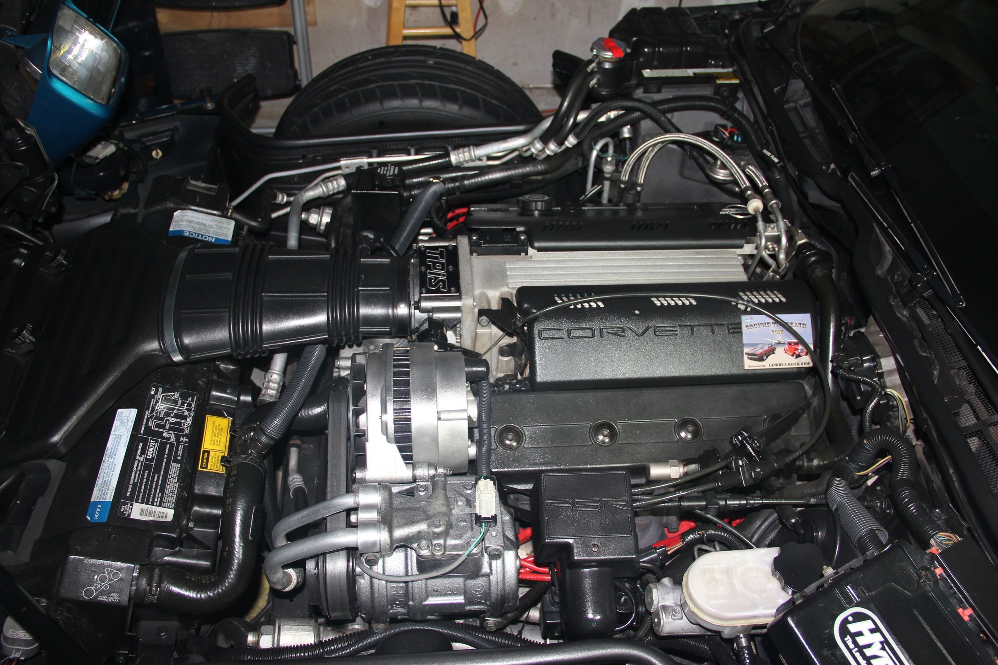

People are acting like installing a 58 MM throttle is a bad thing on modded but if anybody has read anything on this install BY the X-Perts not so bad and my motor is modded Hot cam ported heads headers and returned . I don't see the big deal ,like I said I drove it and pull you back in the seat way more pep for sure .
I may be old BUT not old school as some of you must be for the is it pretty comment .
I was thinking we were all on the same page trying to do improve or Corvettes no matter what we did to them and when someone needed REAL help with A REAL problem installing a 58 mm is not that big a deal people do it all the time ,I don't get it like ( I rebuilt this 93 from the ground up and rebuilt the motor ) Like I don't know what I am doing and some know it all .. Maybe I don"t need you help after all and some of you are A-holes ... Thanks but NO thanks ..
I am a carb. guy . I will figure it out ....
YEP PRETTY...

Looks nice. A 58mm throttle body will not hurt performace and may help, lets work through the issue so we can get it to work for you. I run a 58mm on all of my engines or bigger. (Monoblade). If you are interested call me and I will walk you through what I am thinking.
