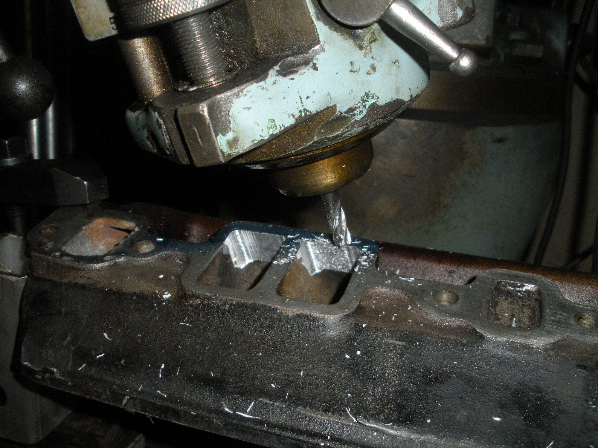

Old Jul 6, 2020 | 10:11 PM
Buccaneer's Avatar
Buccaneer
Joined: Nov 2005
Posts: 3,532
Likes: 1,185
From: Arizona - If you don’t know CFI, STOP proliferating the myths around it...
Originally Posted by 84 4+3
You and I both know yours will make the most. But I am curious if the curves are gonna move around. you know, for science.
You are correct about mine and it will make the most at mid and high end when the motor will want a ton of air. I say, go for it and see what it will do and collect the data. The water jacket will be the limiting factor for sure on a stock unit. BTW, I did hear from one foundry today and the numbers were rather disappointing, way too high. One more to go.
