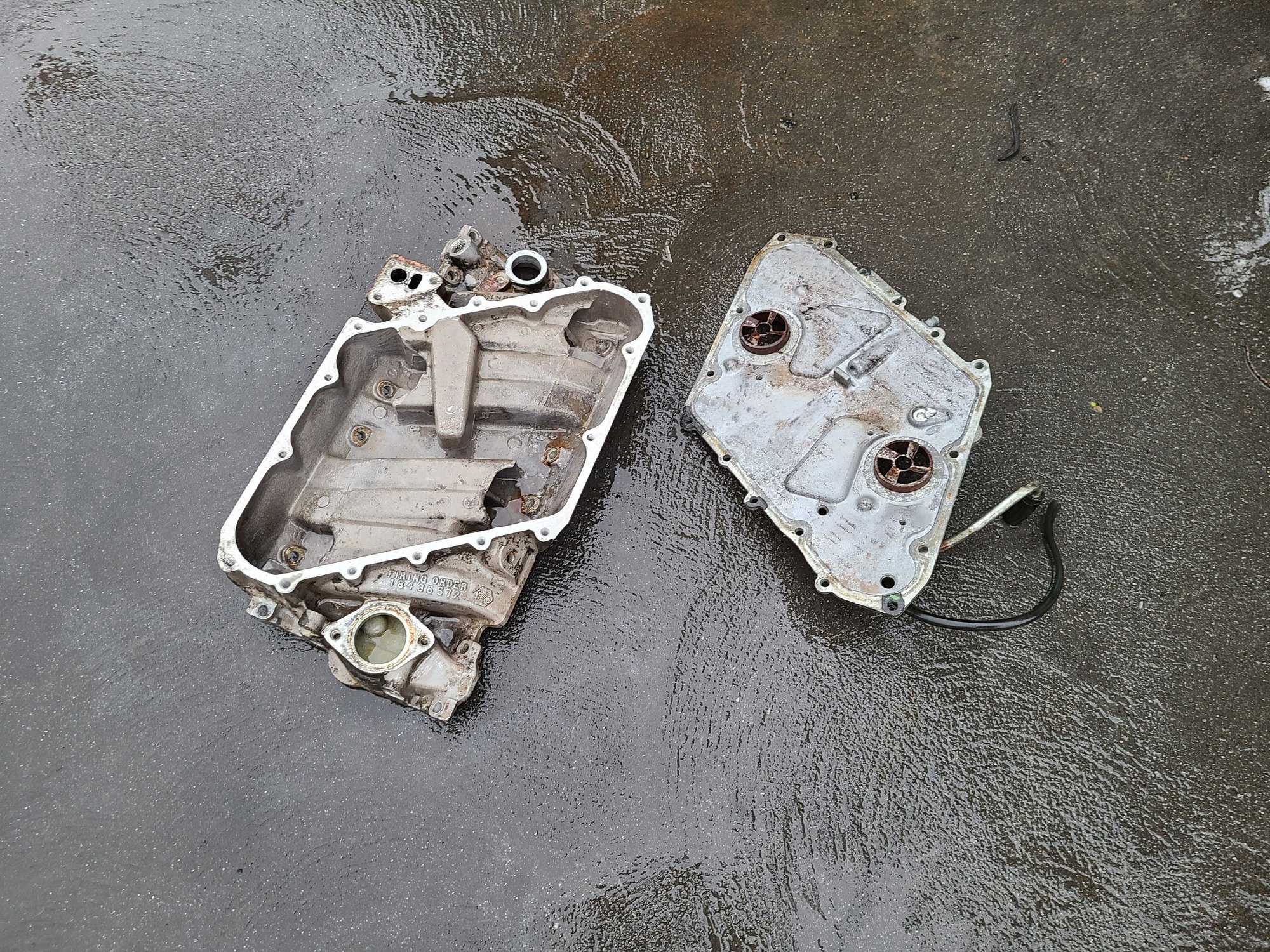

Cleaned it up.

That looks way better.

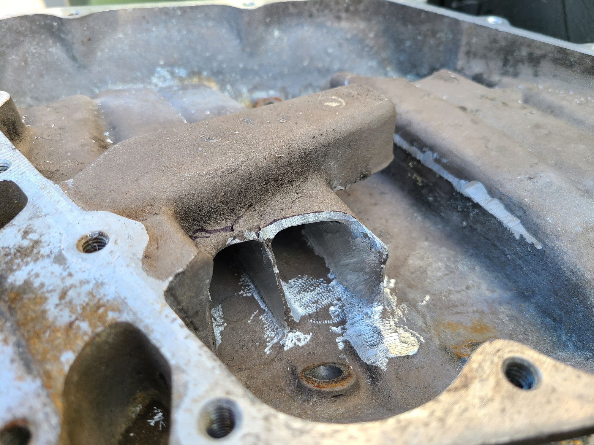

Just a dry little bit for now. So far so good.

You got that center wall pretty thin. Good start!
When you're done, I think I'd "copy" Bucc's idea and mix up some mold-able epoxy and lay a bead of it around the perimiter of the runners' mouths, to create a nice "bell mouth" radiused inlet.
I was considering it however, due to the height difference inside the plenum I do not believe it would have the same effect.
Yeah? I think any rolled inlet -even a small one, would be better than a sharp edge that will create turbulence @ the mouth. IDK...just an idea.
I guess I could give it a shot then. Darn it you've twisted my arm.

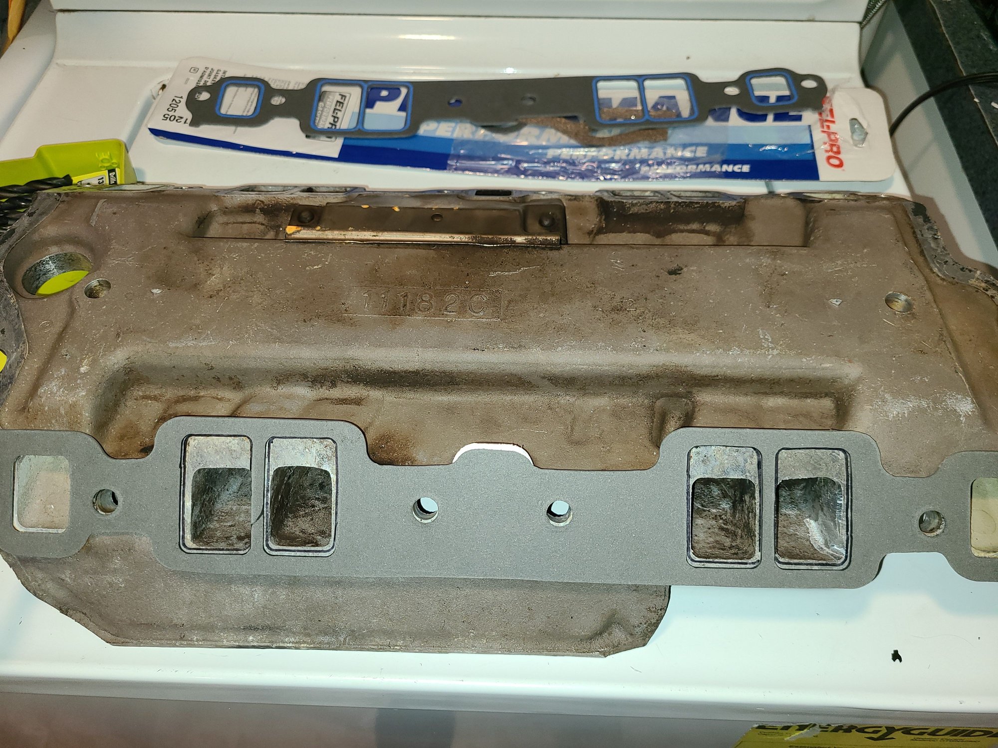

Now mind you... a 1205 (pictured) is still slightly smaller than the port on my head... I just don't think this would seal if I hog it out any larger...
