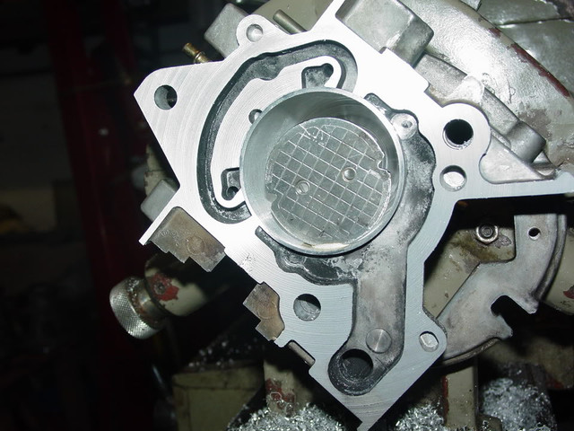

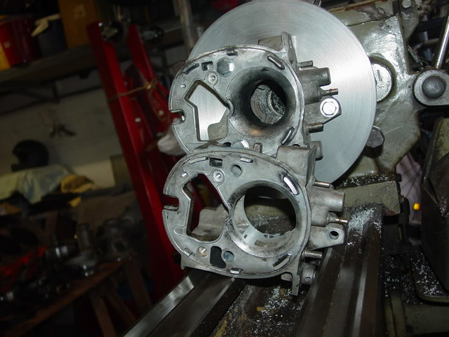

My 2.20" TB are sleeved, I'm not sure why it was thought they were not. I managed to find some pics back from when I made them!
Here is a pic of one bored big enough to accept the sleeve, compared to an unmodified one on the faceplate ready to be bored.
You can see all the windows that opened up inside the bore.
And here it is with the sleeve pressed in and ready to be bored to final size.. And a 2" butterfly sitting there for comparison.
IMO they are too big and make the pedal too touchy off idle. It cruises at 65mph with 3% showing on the TPS.
I really want to go back to 2" and see if it loses power as I'm sure it will be nicer to drive.

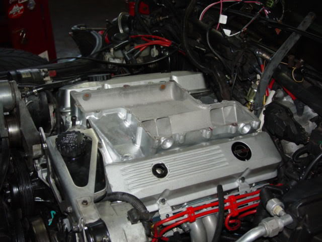

While looking for the pics, I even found a pic of when I tried the Smokeyram SY-1!

INdeed. I couldn't see how, if I windowed the bores at 2.03"...how you could go more than that and not.
Killer pics thought....awesome! I love seeing those kinds of pics from back in the day. Love it!

Looks like you were right Tom. I was sure Ben told me that they weren’t sleeved but clearly I got that wrong. We were doing dyno pulls at the time. The photos are a good record of exactly what went on.
