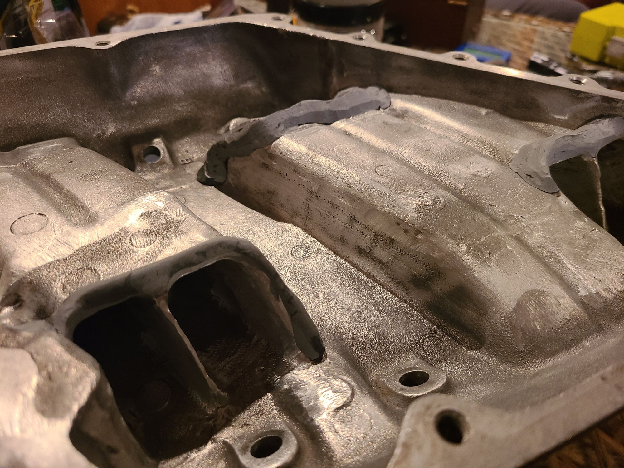

Did a little more hand blending on the inlet ports.

I love the radiused inlets. Nice work there! It all looks great. Can't wait to see the results.
