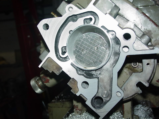

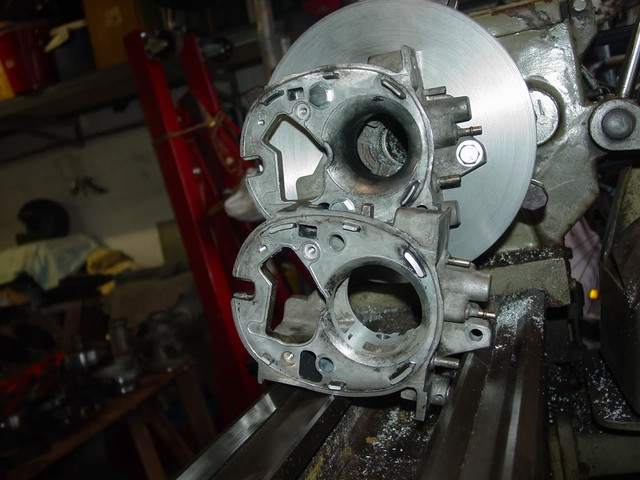

Here's a pic of one on the faceplate about to be bored, next to one that's been opened up beyond 2.2" to accept a pressed in sleeve.
The second pic shows a stock butterfly sitting in the bore of a 2.2" sleeve for comparison of size.

Originally Posted by ben73
You just need to bolt the TB to a faceplate on a lathe and bore them using a boring bar as stated.
I did mine 15 years ago, first a set at 2", then another set at 2.2" which needed a sleeve.
Never thought about the lathe. I'd have to find someone with one that's big enough. I had originally thought my friend had a mill but it's actually just a massive drill press and idk if that's a precise enough tool to bore out those. I could justify buying a lathe however.
