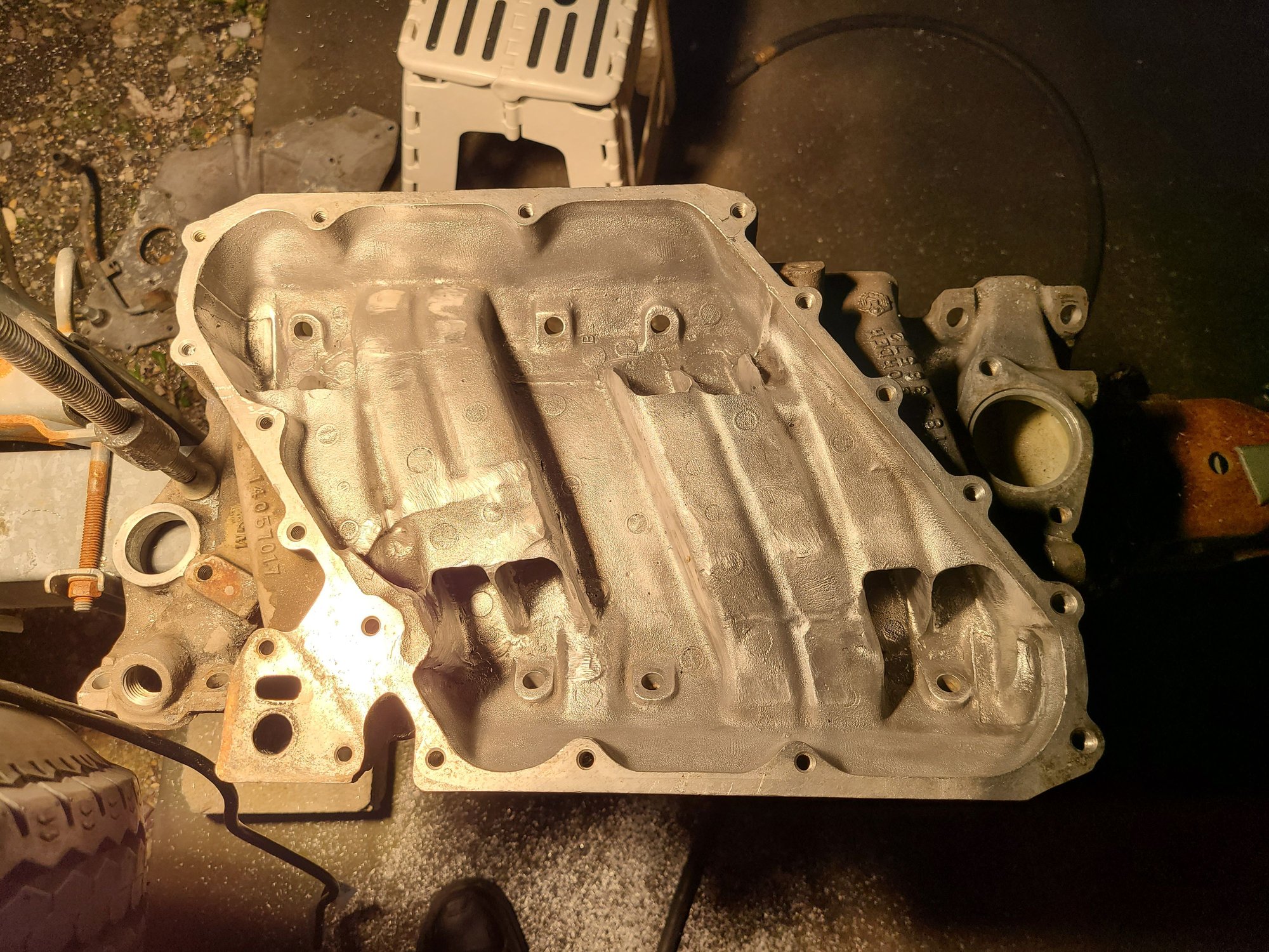

So I made some more modifications... I measured the upper lip to upper lip length of my renegade and my stock unit. I decided that I could tilt back the inlet some more...
So I started grinding... and grinding...
Around ArounI blacked out... When I came to my last text said grinding the eff out of this, race on!!! And I saw this...
Then I figured what the hell I could clean up some..
And finally more.
And then... I added in the humps.
I'm going to blend them by hand with some sand paper but otherwise, I'm happy with what I have now. I trimmed back almost half an inch from the roof of the inlet which I believe will allow more circulation inside the plenum. The dynk will tell but I feel this is the best I can do with what I have. Hopefully soon.

Race On!
...is right! He showed us how it's done. You have lightened the front of your car...Diz would be proud.
Looks good. I dig it!
