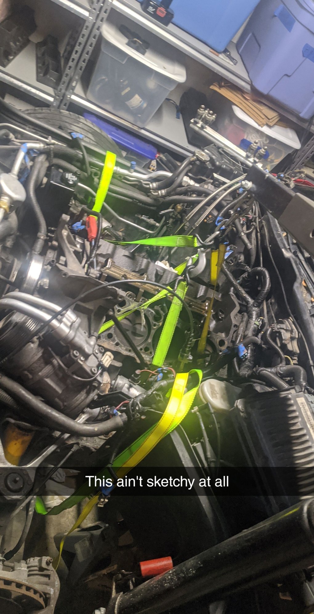

Okay here is the next major update guys. I got the engine out of the car. I used a engine cherry picker that I borrowed from a friend and then took some ratchet straps and rapped it around the engine and hooked it to the hoist. Once it was hooked up I unbolted the bellhousing from the tranny and unbolted the bottom of the engine mounts. Then I took the 4 bolts out of the c-beam. The front ones are hard because there isn't much room to get a wrench around the nut at the top but a friend with small hands was able to get it done. Once the c-beam was free I was able to take the straps off the rear end of the driveshaft. I could then push the driveshaft forward allowing it to clear the u-joint yolk then pull it out of the transmission. During this whole thing I had a jack holding up my tranny. I then had a friend lower the jack while I helped balance the tranny. When the jack was all the way down I got some blocks to help support it and called it a day. I may try and replace the jack with some more blocks so I can use my jack but for the time being that is what I got. Once the tranny was out of the way, I just slowly jacked up the engine watching to make sure I moved stuff out of the way and didn't miss any wires. I jacked it diagonally so the front came up before the back, this allowed me to unbolt the accessory drive bracket and just set it to the side. The engine then came out and I set it on a old tire to take the bellhousing off, as well as the clutch/flywheel/pressure plate. The bolt size mentioned a few posts above was correct, I only had 3" bolts but used some washers to make up for it. Any specific questions let me know.

Two hurdles I have encountered are getting the oil filter adapter and the crank hub out. I took out the two bolts holding the adapter in but it still isn't coming loose. Is there something else holding it in or do I just need to introduce a hammer to it.
Apart from that, I know the crank hub is supposed to be taken out with a special Kent Moore tool. Is there any way around this? I really don't want to spend $300 to use something one time.
For the oil filter adapter, the part the filter threads to may be threaded if I'm thinking correctly.
As for the balancer... I believe you can rent one that will work from a local parts store. put down the money use it and bring it back and get the money back. Not sure if the lt is different than a regular sbc.

The only thing holding the oil filter housing on is two bolts. After removing those two bolts a light tap with a rubber mallet should dislodge it.
On the Hub removal, this is one of the tasks on an LT1, that I strongly believe in having the factory tools. Alejandro, if you want, I can loan you my two LT1 tool kits. PM me to work out the details.
