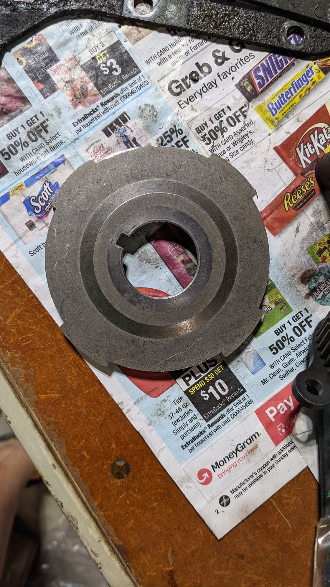

Three things this time.
What is this thing?
My crank hub doesn't have a key slot in it, I didn't pay attention to this while taking it apart. Do I need to take the key out once the sprocket is in there or how does this work?
I've tried both a shop press and the nut and bolt method for getting these new bushings into my spindle rods, I can't get them to pop in it always just ends up squishing them. Any tips?
