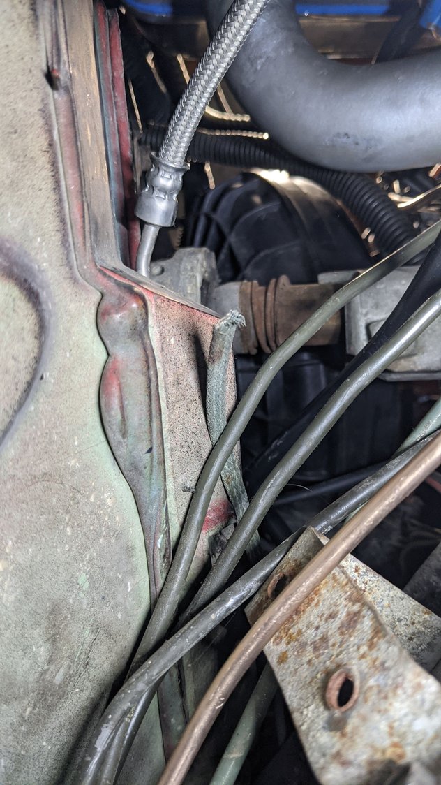

You didn't, by chance forget to detach this ground when you dropped the motor and transmission?

Originally Posted by Alejandro Guerrero
What do you mean? When I pulled the motor all things where detached from it.
sometimes people forget to or are unaware of g107 and it's not uncommon for guys to drop the tranny and stretch and sometimes sever some or all of the 3 wires that go to g107. Sometimes a wire that has been stretched can look intact but it's actually damaged. You should check the continuity of those 3 wires going to g107.
That sounds like a possibility, can I find where the other end is in the book?
Looks like the connections are:
  • Braided Ground Strap - From G107 to Chassis G101
  • Circuit 451. From PCM to G107
  • Circuit 151 From Ignition Control Module to G107
  • Circuit 350 From Windshield Wiper Motor to G107

Those pictures are a little different than mine but I may just be looking at a different page. Anyway I think I found at least part of the problem
Anybody got any idea what length I need to I can grab another? I tried measuring and couldn't get a good tell
I bought 2 straps from autozone or orielly and attached them together,
This looks like the drivers side looking up. it looks like where the grounding strap is supposed to go from g107 to g102 chassis.
What's the best way to do that and make sure the connection is good? should I sodder them together then wrap with Electrical tape or is there a special type of connector for straps
Since its a ground strap I just used a small bolt, lock washer and nut and bolted them together. Solder prob be better but the bolt works for me.
I've got the ground strap and g107 now bolted to the bellhousing, now it turns over but doesn't start and I see a small bit of smoke coming from somewhere behind the engine, it's never enough for me to see where it's comimg from. Could g107 having the other end pulled out a little like you mentioned before be the cause of this ?
