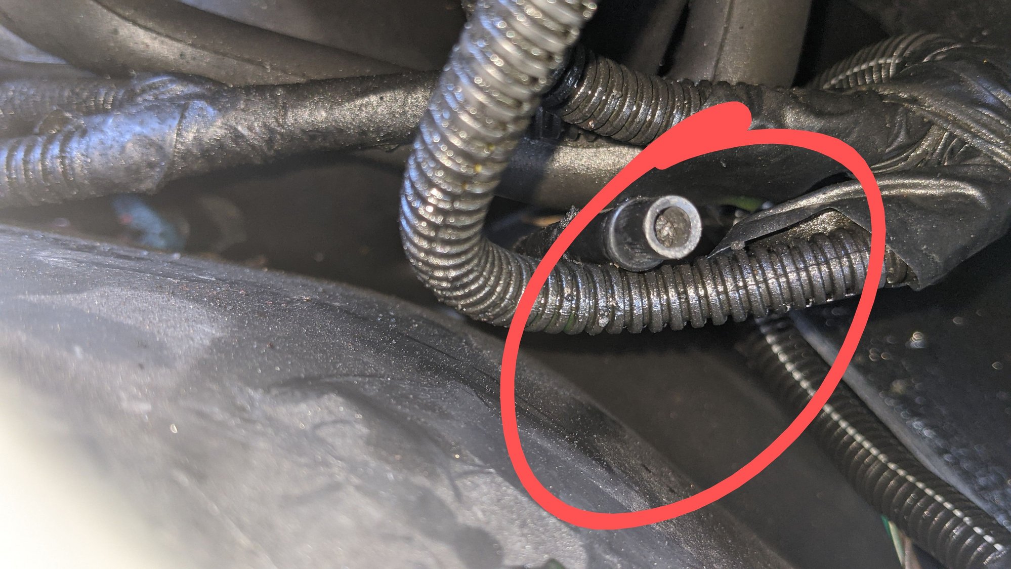

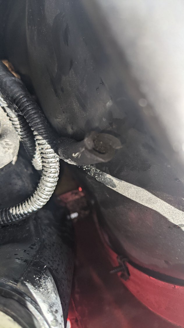

So I got under the car and saw my grounding strap had once again broken, this time the bolt hole thing came off the strap itself. Does anyone see any problem with moving it from the bellhousing bolt to one of the side of engine grounding bolts so it's easier to inspect / replace should this happen again?

I replaced that ground with this part from Summit. It's more robust than the stocker but the length was correct.
https://www.summitracing.com/parts/aww-500656
Make sure to use external tooth start washers on the each end to aid in a good connection and securing the bolt.

I don't see an issue using the block itself instead of the bell housing as long as there is continuity so the parts grounded on the bell housing will still be grounded.
I checked just to be sure by running my multimeter from the hole I am using to that bolt and they did in fact have continuity.

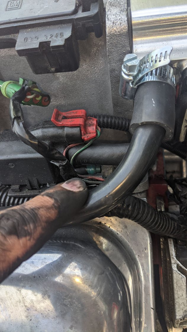

I found a problem, idk if it's the problem. This hose running from a black module that them runs to the throttle body looked like of cooked so I disconnected it and it was completely plugged with what I can only guess is burnt rubber. Amy ideas on how to clean this out

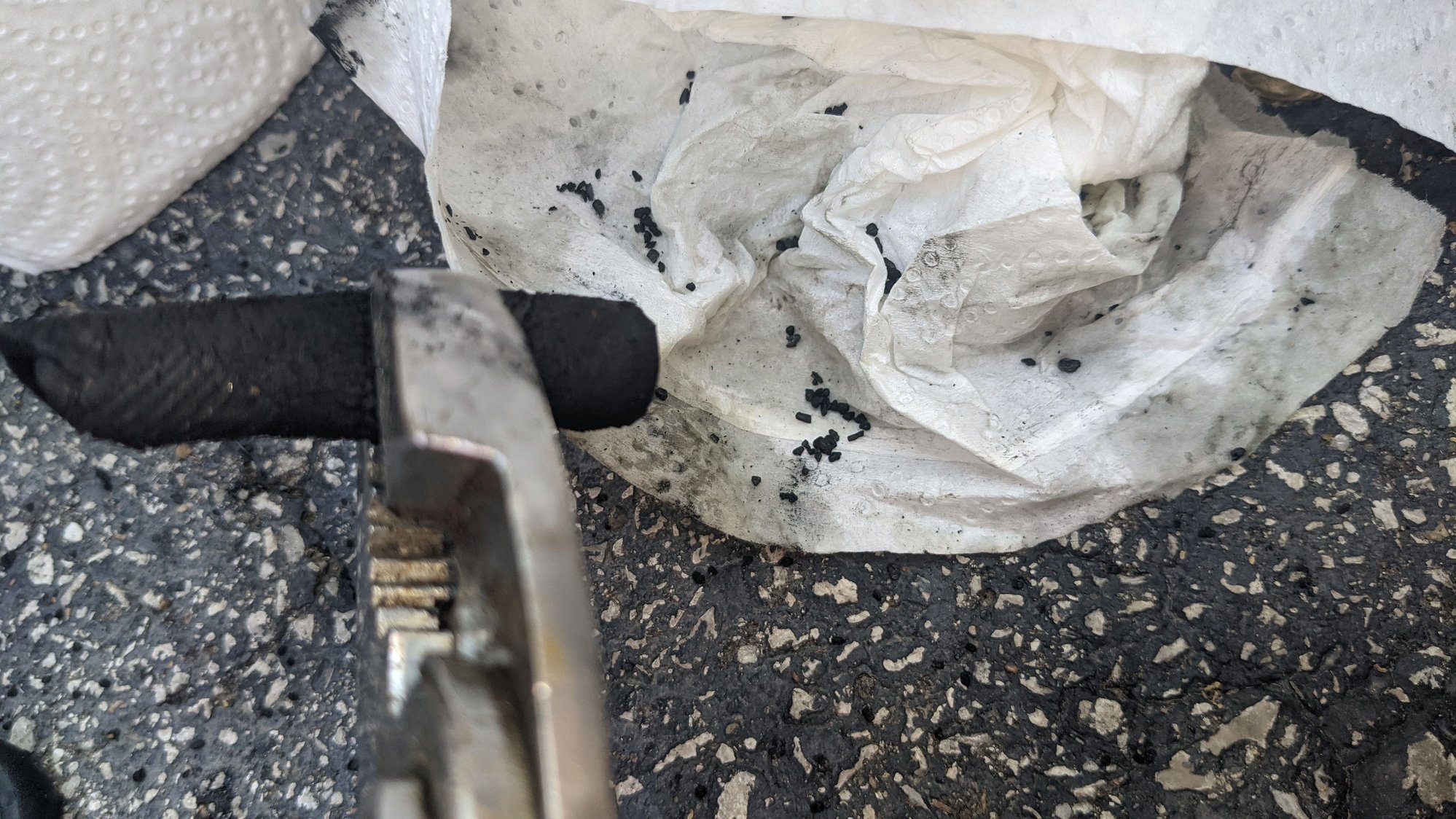

So looks like that's the EVAP fuel thing and that charcoal is supposed to be there, mom the less that hose needed to be replaced. Can I just slap a new one on or have I lost too much charcoal. If so what's the next step
