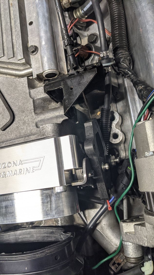

It's being held open quite a bit, any ideas?

Im not sure if the same issue, but I just fought and 'solved' my high idle problem when warm.
A scantool would show a slight throttle angle (ex. 1%)/resulting high idle, when letting off the gas slowly. If I quickly stabbed the gas, it would settle back down to 0%, it was a real PITA to solve. I replaced TPS and IAC sensors with NOS parts and no improvement.
Like you, I have the AS&M monoblade. Last fall, I noticed 2 of the screws seemed loose. The screws tht hold the butterfly to the shaft. So I tightened them down HARD.
Thats when the trouble started
My problem was that butterfly became 'uncentered' and as the aluminum TB would heat up, it would 'rub' sticking open slightly giving me that 1% throttle angle and high idle.
I made a post last week about it and forum members advised me to loosen the screws (holding the throttle butterfly blade to the shaft), then 'snap' the blade open and closed a couple times aggressively. This 'centered' the butterfly on the shaft. (its such tight clearances). I gradually tightened all the screws, continuing to snap it open and shut a few times to ensure everything remained centered.
This FIXED this very annoying hi-idle problem. Hope this helps
What steered me to this solution was when I put back on my stock throttle body and the problem went away . So I KNEW it was something in the throttle body.

I'll go through everything in here and see if it helps but I think we are having different problems. If I take the cable off it closes completly and idles just fine, it almost feels like the cable is about half an inch too short.

I think I figured out both my issues. The ASR line had a small button I was able to press that let the cable stretch out to the proper length. Then on the ground, the block was painted and there was a fair bit of paint between the ground and the block, I scraped that off and it seems to be a lot more cooperative.
