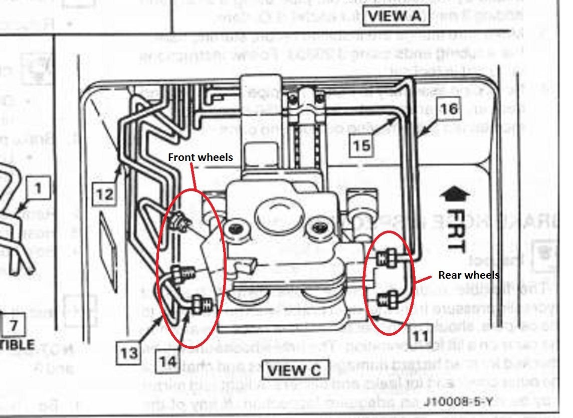

Quick question to the experts on the subject. I know I need at least one of these 10mm tees to join the front lines. Are the two rear lines the same 10mm tee with a plug in one of the ports on the tee ?

There is some info in my old removing ABS thread:

I had seen and read that one before and somehow missed the two like tees part. Thank you sir. seems easy enough

After reading thru this post, it looks like all that is required to eliminate the ABS system is using the 3 way T-fitting to connect the lines for the front brakes and another T-fitting to connect the rear brakes?
Joel
Yes or you can just use a union for the two rear brake lines. If you use the tee for the rear you have to plug one of the holes
