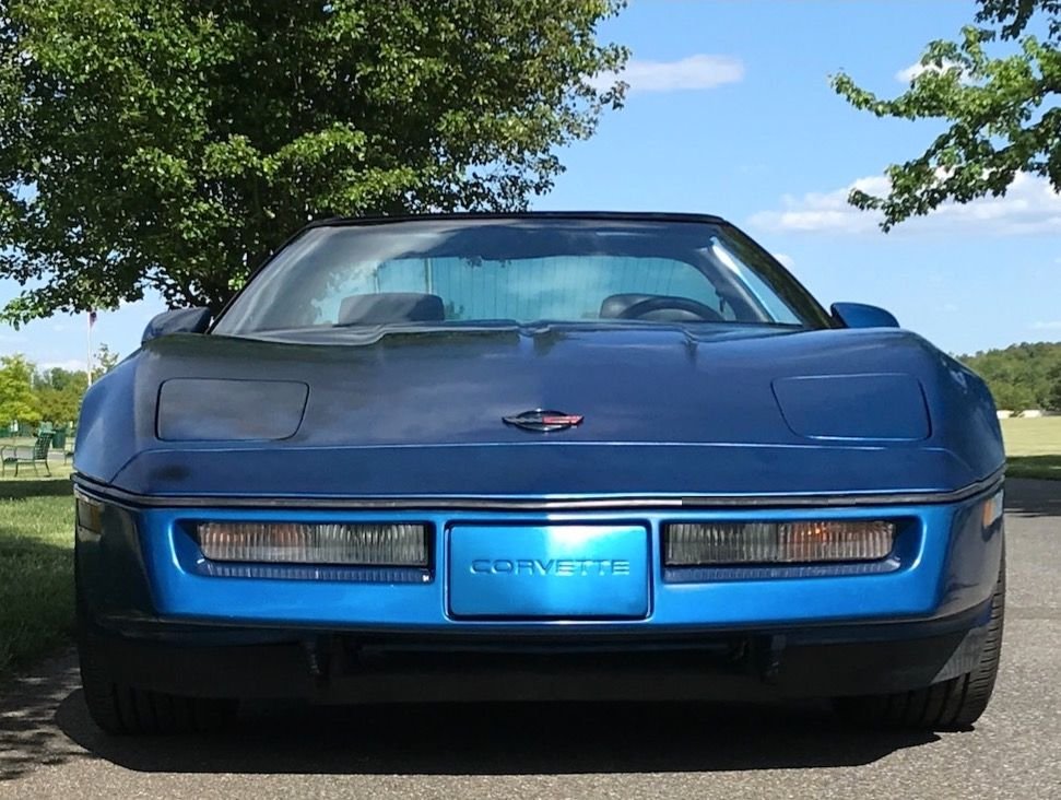

Here's a couple of snapshots I took yesterday of my old beater...

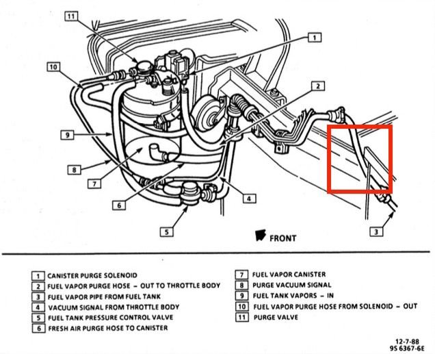

I did find one bad hose when i was looking around at the canister a bit ago. It was shot.
So I replaced that. Should likely just replace all of em in that area and be done with it. Don't think I have anything in those sizes, though, so need to go get some.
All those hoses were bundled as a serviced kit. You had one part number and it replaced everything. I have a kit for the ZR-1, but I know the vacuum line is a bit different, but most of the rest could be scavenged.
I ended up using rubber fuel line on all of it.
That diagram is actually a Vin J diagram. There wasn't an L98 diagram in the manual. Seems like it looked pretty much the same.
Hm. I hope I have it all routed correctly. I should look around for an actual L98 diagram to verify.
