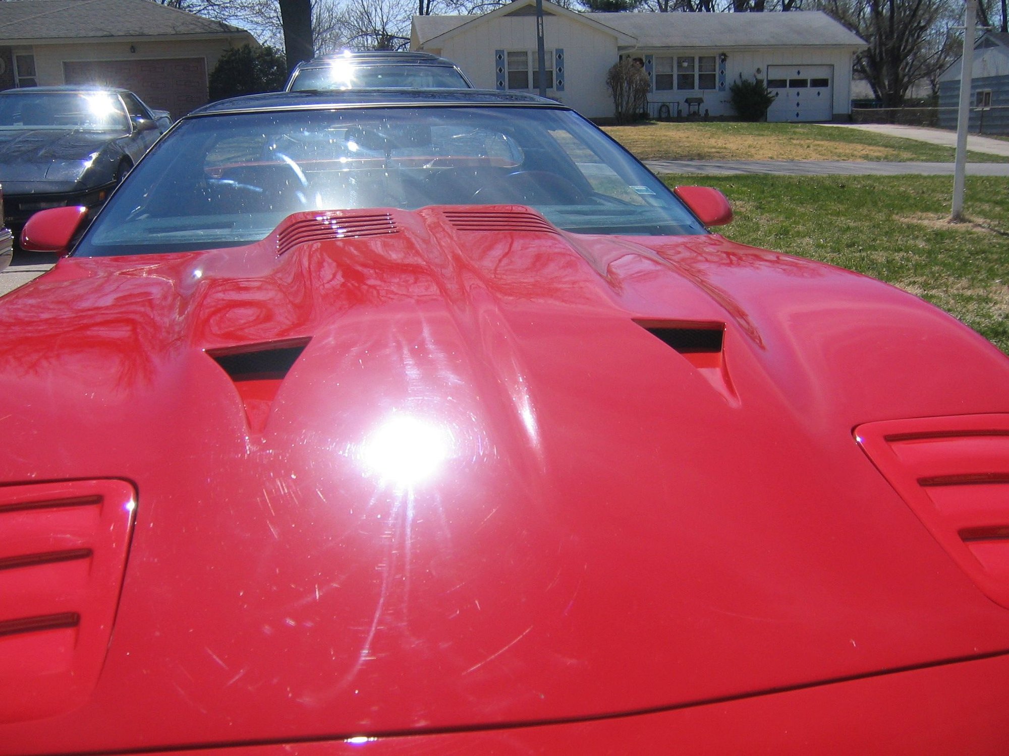

In case this "classic" from the old days (sold by Vanacors or Vanacorvette?) provides any inspiration...
That actually looks pretty darn good IMO. That's good inspiration, I've been messing around this week trying to blend it into the hood more and never thought to do a "double bump" cowl like that. Not sure if id be able to get anything usable out of the naca ducts but I do like that design more than mine. Ill see what I come up with.
Yeah, it's not the vents that do it for me either. I just like the "ribbed vents". Bet they'd look good even with a single-plane cowl.

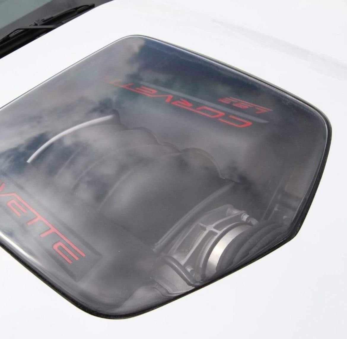

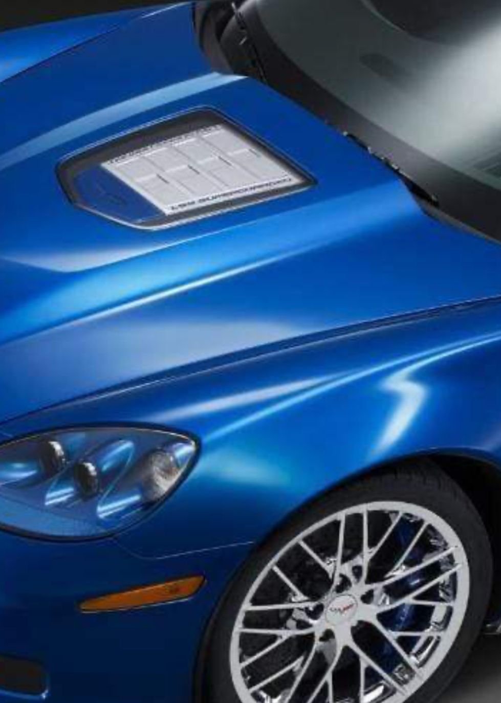

I’d love to see what a see-through hood would look like on a C4 with the TPI showing thru….
