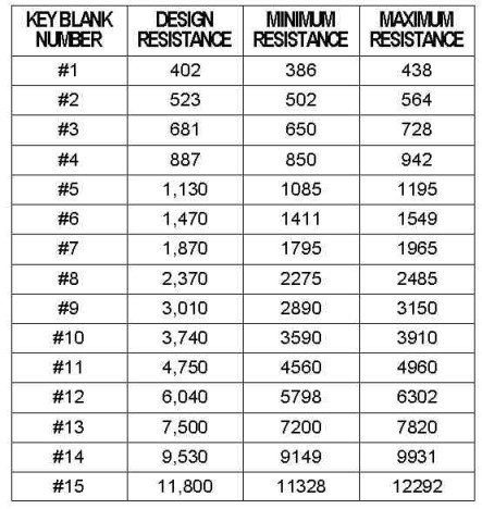

Step 1 - Figure out if it's a VATS issue. If it is a VATS problem - the absolute BEST way to solve the problem is to have a programmer reprogram the PCM to eliminate VATS entirely. Once done, your problem will NEVER reappear. I suspect that you don't use your car much in the Jan / Feb timeframe - so that might be a good time to do that work. In the meantime, measure the resistance of the "nub" part way down on the Ignition Key. I've attached a pic of the sesistor measurement and a pic of the table of what the resistor values should be. You can simply buy a resistor and plug it into the harness and that will hopefully eliminate the ignition key "sensor" that has been know to be rather "problematic".
VATS Resistor Values

I check both my keys and found one key reading 3010 and the other 3005 so it would appear I have a #9.
