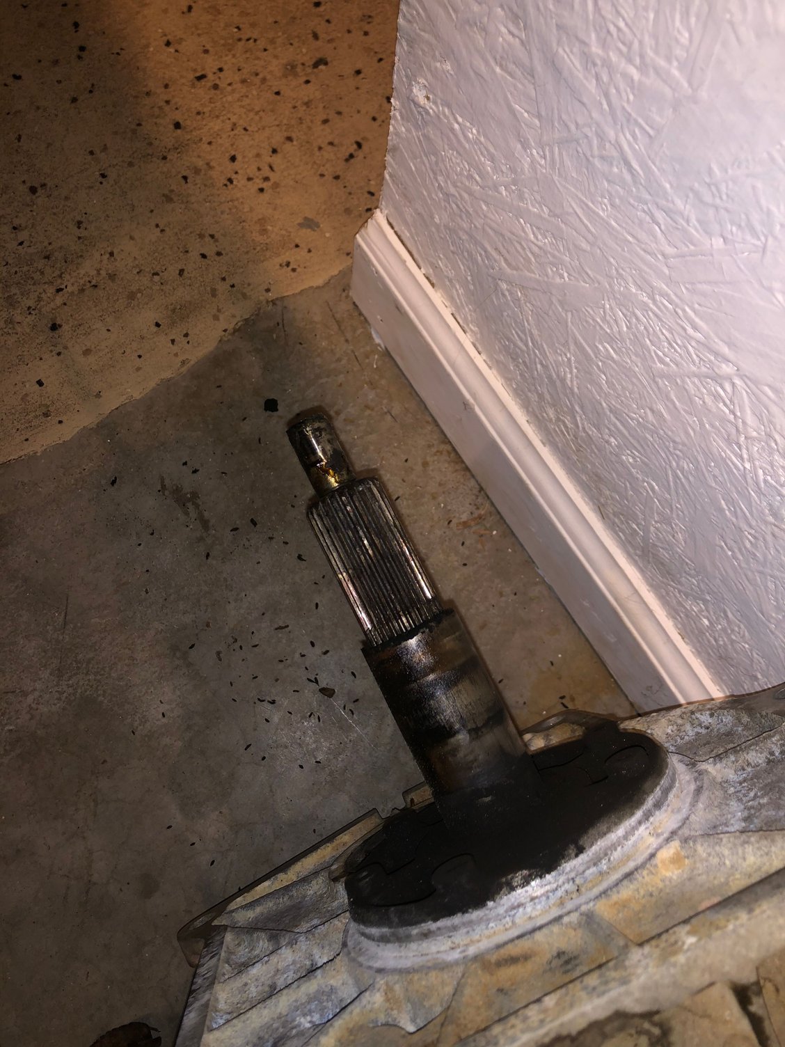

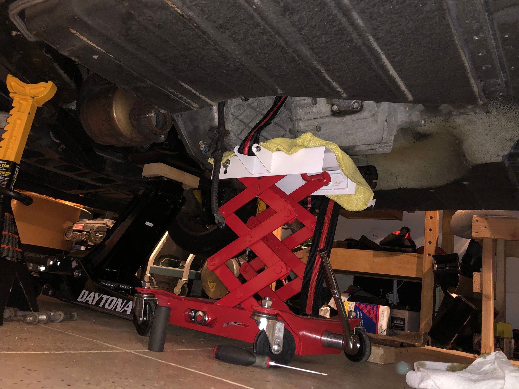

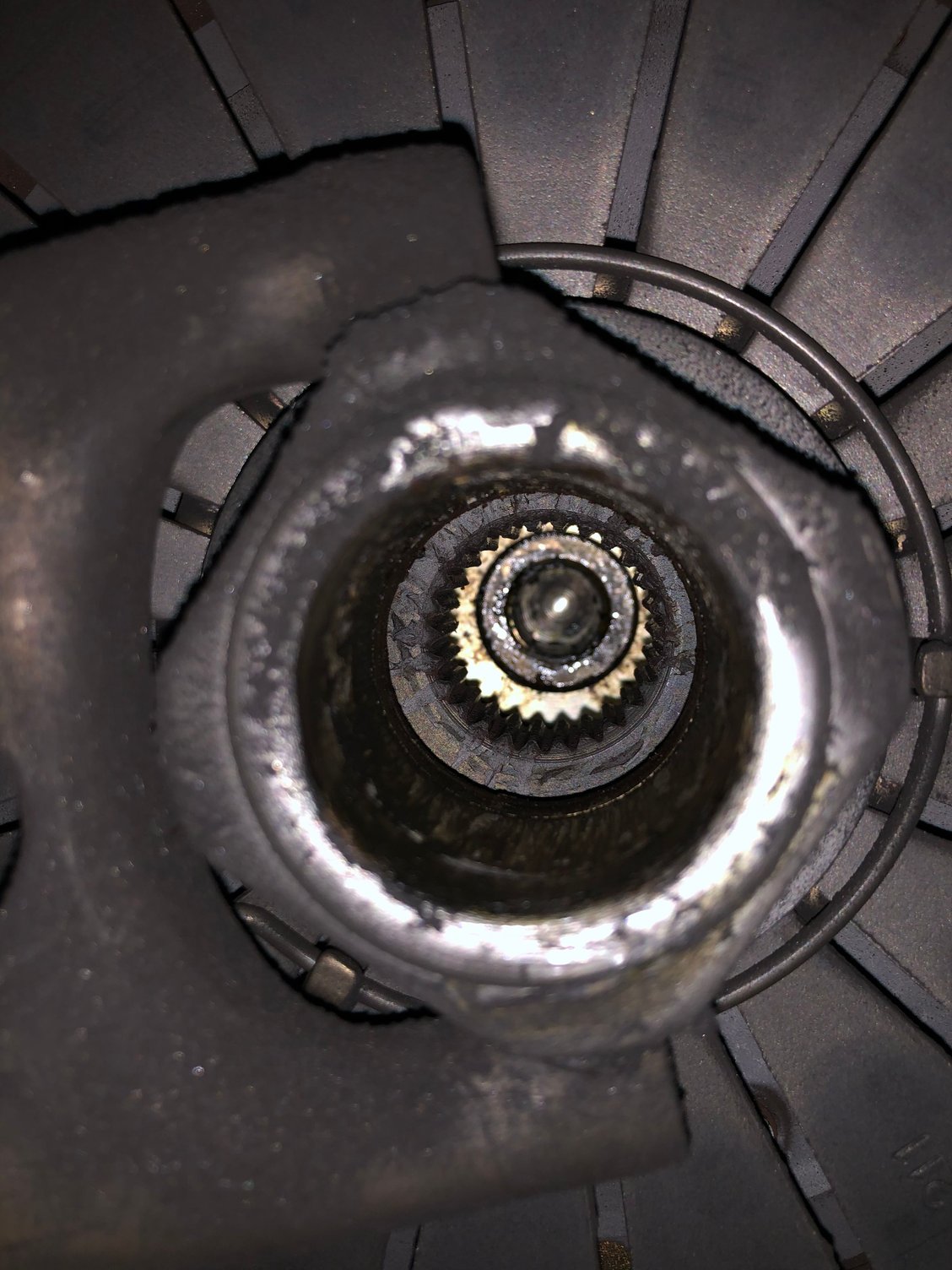

Update: finally got the trans pulled. Most annoying part was getting my corsa off in one piece (it fought me at the passenger cat). I got 20” of lift measuring to the pinch welds. That is plenty. I am nice and sore after all of that!
Will post more after I get the bell housing off. Someone definitely has been in there before, and see if you can spot their first mistake (hint I know why my pilot bearing whirrs).
Just fits!!!
Setup to pull trans.
Slid out the back no problem (had to tilt)
Hmmmmm
Hmmmmm, hard to see but that is the grooved bronze bushing

Glad to see you got the beast out. I have to say I never saw a pilot bearing that looked that bad. When you install the new pilot bearing make sure you install it dry in the crankshaft bore. Do not put any lube on the input shaft either, when reinstalling the transmission.
Maybe the last guy who did the job lubricated the bearing and caused it to prematurely fail. Bill Boudreau told me to never use any grease or lubricant on the pilot bearing or it will fail.

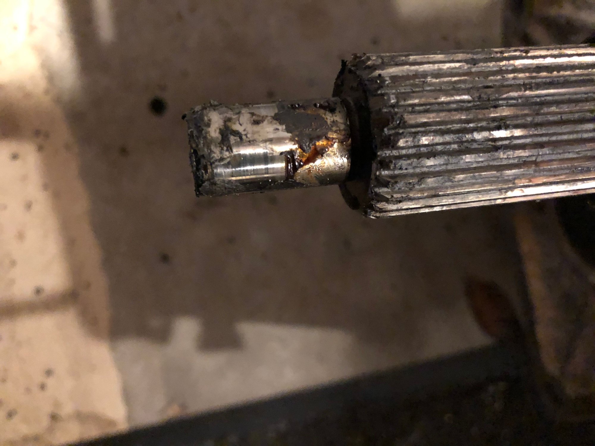

Ding ding ding. Hard to tell from the photos but the pilot bearing/shaft are caked in grease...and it's a bronze oil-impregnated bushing, NOT roller.
Yeah, that would definitely cause problems. Is the end of the input shaft still okay? That would really suck if it's jacked up.

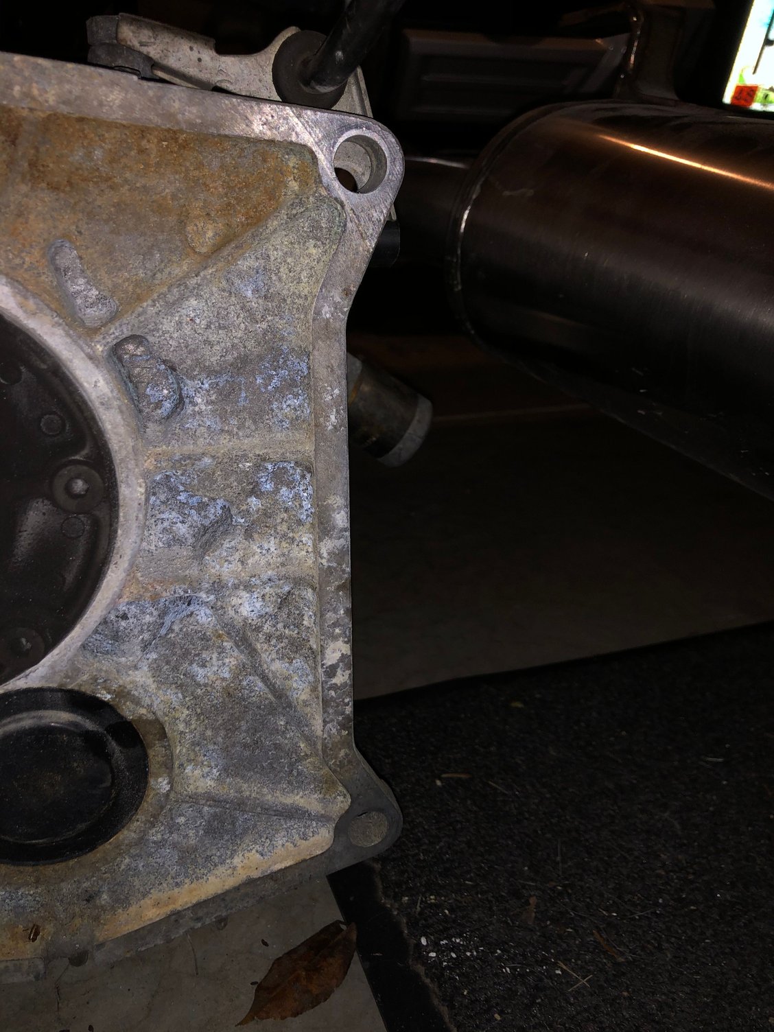

Seems to be fine...have some corrosion to clean off of the case so that the surfaces mate true (could also contribute to pilot/align issues and all could be contributing to shudder by causing uneven clutch wear [please see zfdoc comments above #21,cannot wait to get the bellhousing off])
Before
Quick wipe with paper towel (can feel no roughness with fingernail)
Have some corrosion to clean
More
