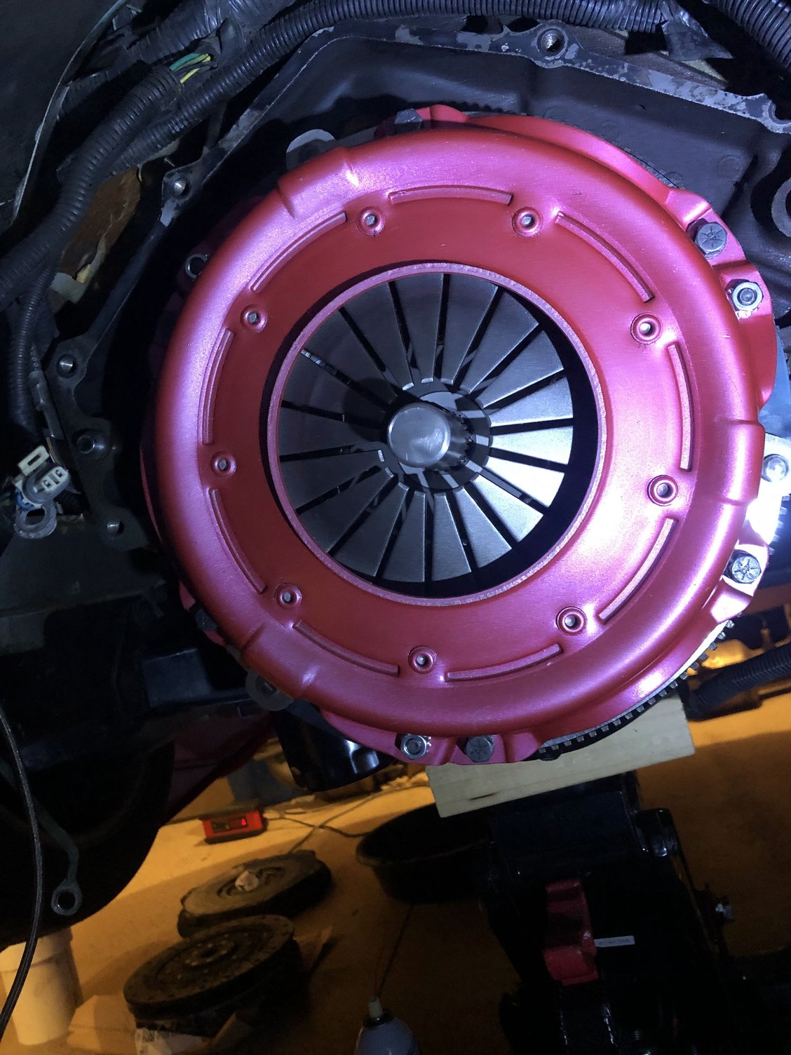

Finally got all the parts a couple of weeks ago, ZFdoc parts/shifter mods as well, and got everything setup and stitched back together (minus the interior). Things went *relatively* smoothly, I did take my time as this is my first clutch and this was a "conversion" to the RAM setup, and I had to redo some things as I went. Hopefully you like pics and vids because here comes a bunch/big post.
After being frustrated with pilot bearing removers (too big or broken), the slide hammer I rented was found to thread perfectly into the soft pilot bearing and allowed for easy removal...use at your own risk but worked great!
Cleaned up with maroon scotch bright pads. Shows stud and countersunk bolt.

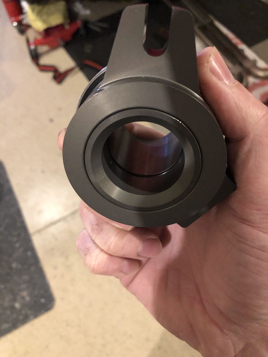

RAM hydraulic TO bearing, note rubber o-ring inside sleeve
mockup on transmission

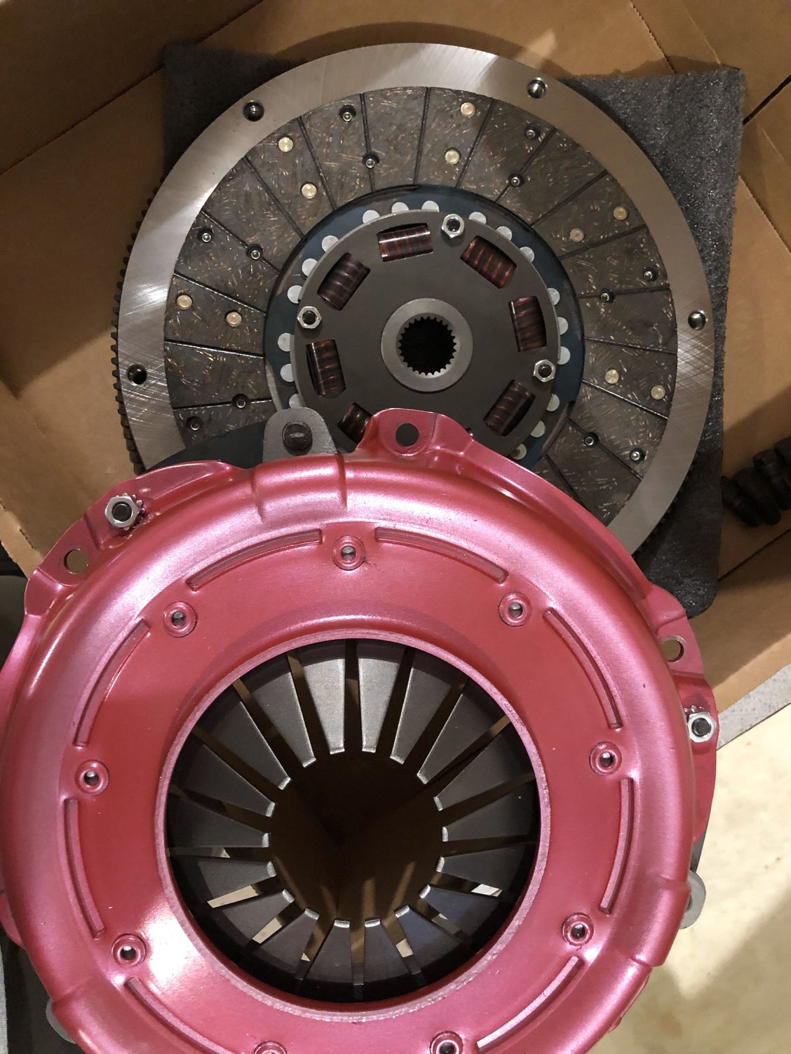

RAM clutch
flywheel and pilot bearing installed
clutch installed. Zfdoc's loaner alignment tool, thanks Bill!
bellhousing installed for measurement of face to clutch finger measurement with caliper

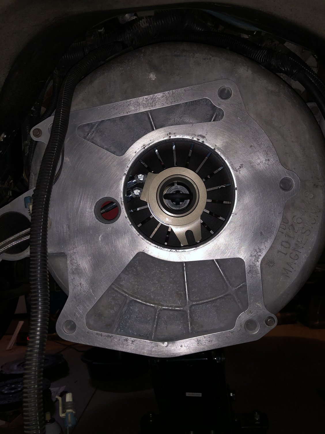

Mockup with provided shims (took all of them) to make sure of correct gap between bearing face and clutch fingers with TO bearing fully retracted (too small and you have short clutch life, too big and clutch won't disengage or TO bearing will pop c clip at end of sleeve). Also note mark on stud which indicates where to trim back stud to prevent any chance of interference with PP.
Ready to install transmission. Aluminum spacers were removed, surfaces cleaned of corrosion with scraper and maroon scotch brite. You can see some left over pitting from the corrosion, but the surface is flat and smooth.

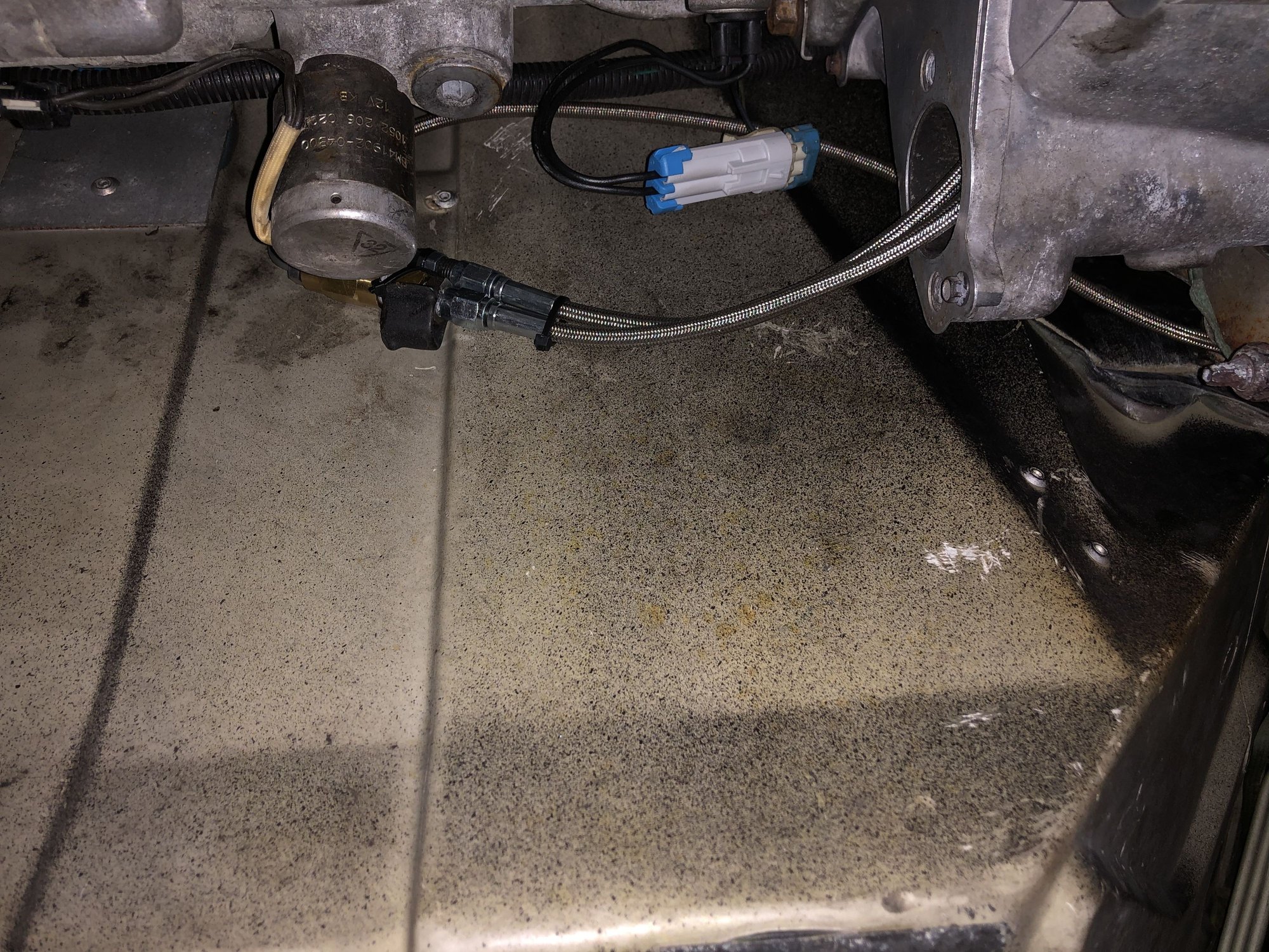

Hydraulic line connections (holy adapters batman). Moved the lines up from this position to keep away from exhaust after bleeding and keep from flopping. NOTE: the bleeder provided is terrible, because it threads directly into the loose nut at the end of the hydraulic hose. This means it leaks like crazy at that spinny joint, and of course my vacuum bleeder would not work. Luckily I have a 12 year old son who helped me bleed it the old fashioned way. It should come with an adapter that screws into the end of the hose with the bleeder screw inside of that. I swear that the adapters would not go another way...
final location of hydraulic lines
Do not put the hole here, mostly a waste. Should be closer towards the mating surface with the trans (hard to get an angle to the stud/TO bearing). Rubber cap on way.

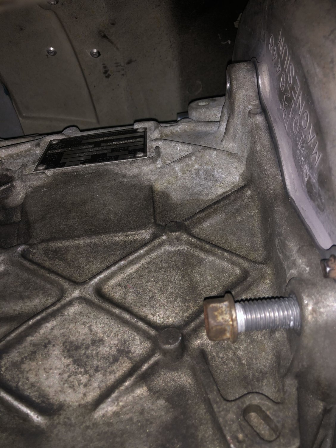

At this point I had a problem. The transmission when installing would not push in the last quarter inch no matter what I did. Before I broke something I decided to "see" what was going on, so ran out and picked up a borescope since I couldn't see well enough from my stupidly cut hole in the bellhousing and sure didn't want to poke another hole. I suspected that it could be something with the TO bearing binding (sleeve to trans collar) since it should have already made its way at least partially into the pilot bearing, and I wanted to be 100% sure the TO bearing was on the stud. On a hunch, I setup the new toy on "record" and pumped the not fully bled clutch. here is what I saw:
Pumping the clutch (I had a bolt loosely installed to prevent the trans from sliding way back) did the trick to completely seat the TO bearing, and it slid together just fine (not sure that was the holdup but it worked!).
transmission mated. At very top of pic can barely see bolt with cut off head used as guides (x2). Careful not to make it so after install you cannot get the guide bolts back out!

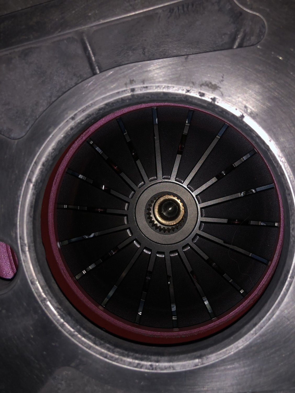

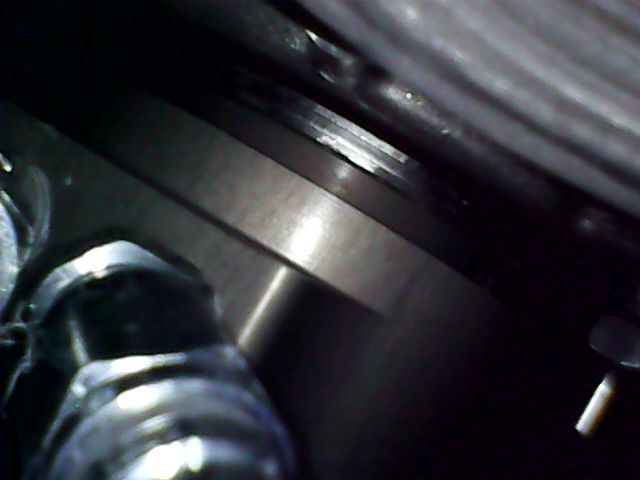

Trans fully installed, hydraulic connections and view of TO bearing back to ensure amount of free space is approximately correct to spec (should be .135-.2, which you can see "about .2" between the shims and bottom of the TO bearing). (borescope)
view of stud with TO bearing (fully installed) (borescope)

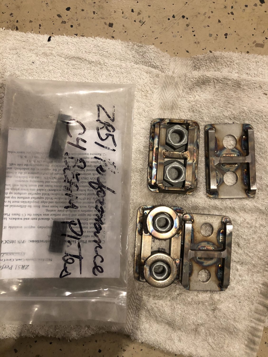

ZFDoc beam plates, with driveline alignment spacer/helpers (didn't expect that!)
C-beam beam plate installed (trans). I think I am going to regret following the directions to put window weld on there (there was no goop when I pulled things apart and it was fine). Plus regardless of trying to use gloves...my hands are still black with urethane.

One last tip. When reinstalling the ZF - if you get it close - but it just won't go in that last 3/4" of so - with a couple of bolts holding the trans "in place" (read that as keeping it from moving backwards) - and with the trans jack still in place - you can try to press the clutch pedal a bit to take a bit of the pressure plate pressure off the disc- that will allow the disc to move ever so slightly, which can make the difference when your clutch disc alingment is off a few thousandths...
I will say - having a mechanically competent friend around for the removal and the reinstall is also helpfull !!!
HAVE FUN !!!!
ZFDoc's site/instructions had some of that great info on the ball stud and the trick with the vice grips + a screwdriver to pull the shifter wedge. Hopefully I don't need to drill and tap but if so, so be it and good idea. Unfortunately I do not have mechanically inclined friends, but I am sure someone would assist with manipulating the trans if I get stuck. Maybe I am a masochist, but a lot of this *is* fun for me, although the frustrating parts are always that "one bolt" that gives you hell and makes it take 5x as long as it should have to complete!

Lots of good input here. Having done this myself using just jackstands and a floor jack for the transmission (not even a trans jack), it is possible. I think you'll need to slide the transmission off the jack and maybe onto a piece of cardboard or thin plywood before you can get it out from under the car. It was all pretty straightforward for me, but I think I had my son helping me by operating the jack while I pull the transmission off the bellhousing. You have get the correct angle for it to happily slide out, and doing that all yourself would take forever*. BTW, when you let the engine lean back to do this part, make sure your oil pressure sensor at the top rear of the motor doesn't hit the firewall.
I don't think hot spots are your problem. I think one thing you most likely have is some form of misalignment between the trans and flywheel: either the trans is at a slight angle or it is off center. That's where the whirring noise is coming from at idle/neutral with the clutch engaged. Your chatter in 1st and reverse are very possible caused by the same thing, and/or the pressure plate isn't even (that's what Bill fixes).
I think you're unlikely to find an OE INA-branded bearing at any price, but if you do then that's what you need to use. Anything new is made in China, regardless of brand. That alone would be enough to make me consider that RAM push-type conversion kit. OTOH, if you pull it and by some miracle the OE bearing is still in there, make sure it's still good (maybe as Bill to take a look) and reuse it. Even better if the pressure plate is usable: I would definitely have Bill true it up unless you are sure it's an OE piece. I wouldn't reuse the DM flywheel if that's still in there, because they eventually can have issues (they do have moving parts, after all, and there's a procedure in the FSM to inspect them for failure of those parts). But for a street-only car where speed doesn't matter, it's probably good to use a heavier single-mass flywheel (~30lb) instead of a light aluminum one (~13lbs). I would do the shim kit for the countershaft to reduce rattle. For a stock engine, I would use an organic disk. Anything else will be less street friendly.
*Unless there's a fancy-*** remote-controlled trans jack out there, but you won't have that/

... I think one thing you most likely have is some form of misalignment between the trans and flywheel: either the trans is at a slight angle or it is off center. That's where the whirring noise is coming from at idle/neutral with the clutch engaged. ...
I have read some about that as a potential cause. Would that mean I need to consider my input shaft bearing compromised if so? Is checking for lateral play enough to verify? Is it possible to DIY the input shaft bearing? Regardless I will do the pilot bearing.
EDIT: Didn't expect this thread to take a diagnostic route , but thank you everyone. FWIW, you can hear the whir I am talking about in this vid in between small blips. Car not warmed up so did not rev...testing out the new exhaust early this year. Apologies I appear to have deleted the orig so the quality is low (emailed):
I think whether that bearing is shot or not will depend on how much running was done in this condition. I don't know how to inspect it or how hard it is to replace. I wish I could tell you. ZF Doc knows, and I would send him the same clip. I definitely would agree with replacing the pilot bearing with the fluted bronze oilite one. It's cheap and easy to do while you have the transmission out.
Yeah, I do think this likely caused by the misalignment issue we're discussing.
