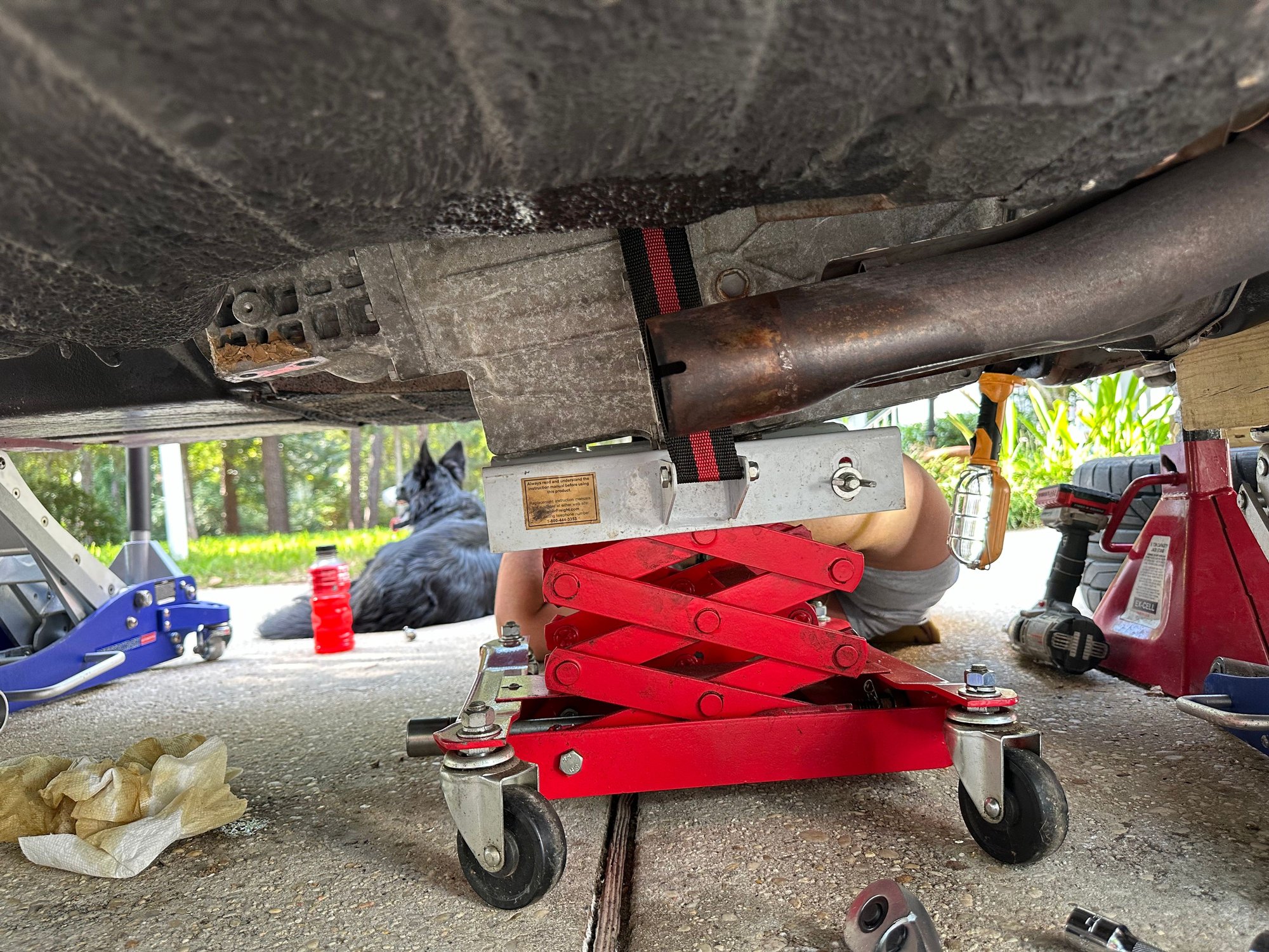

Replaced my clutch last fall in the driveway. Amazing how high the car needed to be jacked up. The big challengers were lowering the transmission to clear the shifter in and out. And for me removing the exhaust cats from the bell housing with the fixed brackets, especially the drivers side.
I ended up making my own C Beam captured nut bracket. It’s was a puzzle for sure getting the drive shaft out through the C Beam.

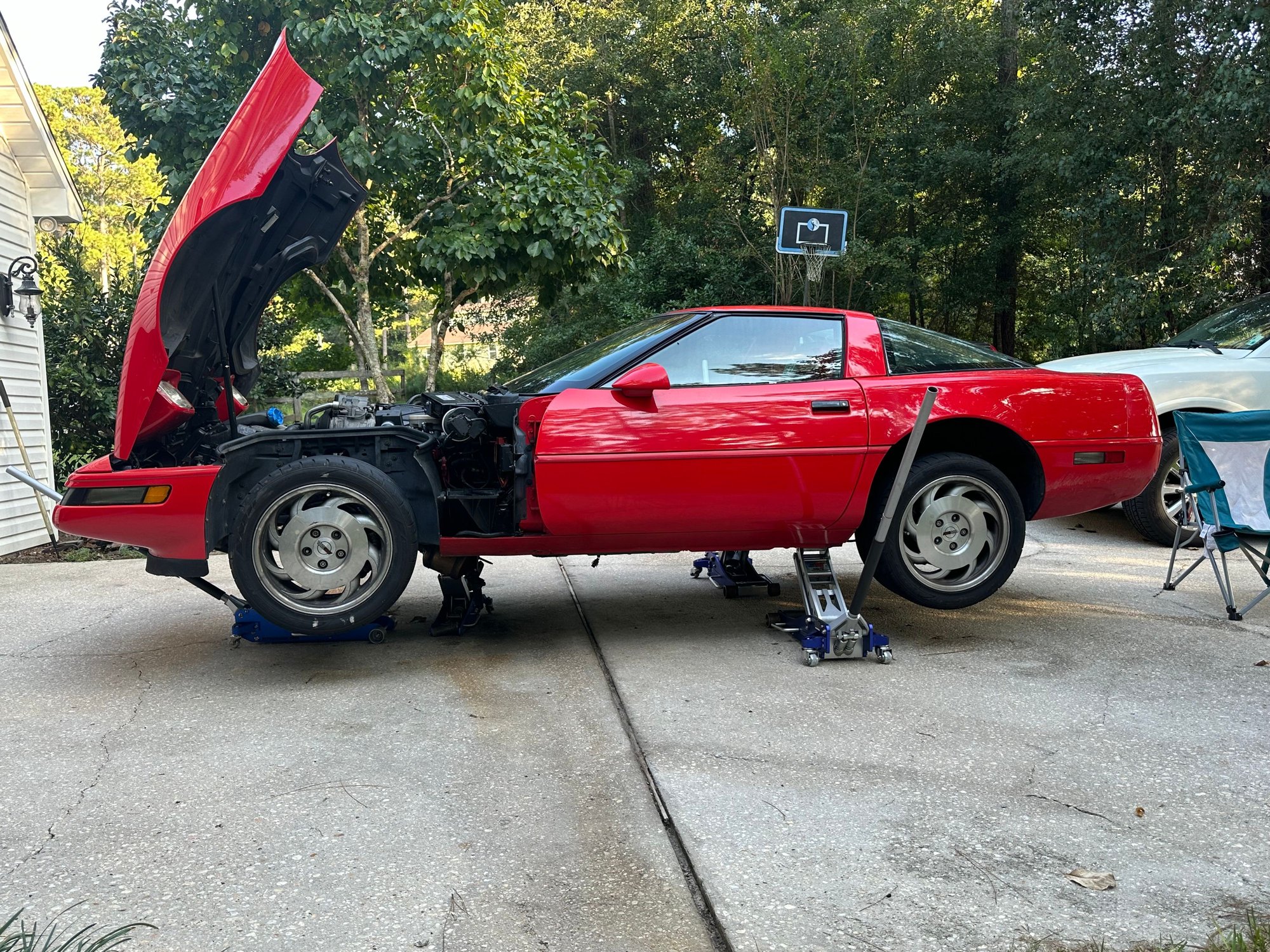

Update: I have finally installed and driven the new clutch setup.
Well, it was somewhat of a long road...a little over a month to get this job done. As I previously mentioned, aside from converting to a Ram clutch/bearing setup, I also did the ZF doc shim for the transmission, replaced the rear main seal, oil pan gasket, and filter stand gasket. I tackled all of this entirely on my own in my garage using jackstands (6-ton) and homemade wooden blocks for the rear tires.
First impressions:
- The clutch effort/feel is light compared to the factory setup. I would estimate 30-40% lighter. Using an endoscope, I confirmed proper operation of the hydraulic TOB. The slightest touch on the pedal translates to movement on the TOB. I will bleed the system again to see if it firms up a bit more, but so far everything seems to be working as intended.
- Shift smoothness seems to be very good. I did switch from Redline MTL to Valvoline Synchromesh, so I don't know if it was the fluid or the clutch that made shifting better. Maybe both.
- The awful clutch chatter I had with the OEM stuff is GONE! Backing into my garage with the sloped driveway was smooth as it gets. Taking off is smooth as it gets. The car doesn't shake itself to death anymore.
- Taking off now is quite different. This clutch (organic disc) has an extremely smooth engagement. Although this may sound great, it feels a bit weird. There is no bite or positive feel to it. There seems to be a disconnect between my foot and the clutch. With other clutches, including OEM, you can tell exactly when the clutch engages...not with this one. Perhaps this is due to the hydraulic nature of the system.
- Gear rattle or gear roll over noise. WOW! I fully understand why GM used the DMF on these vehicles. It is absolutely awful at low speed/high load. I did the shim replacement, and I don't know how much that help, but I find it hard to believe it can be worse. I also have the rattle at idle...not super loud, but it is easily detected. Mind you, I still have the rubber boot off the shifter and so is the trim surrounding the shifter. So, I expect the cabin noise to come down significantly, but I am positive it is going to be louder inside the cab than before.
Overall, the job is not difficult, but it does require preparation.
Ric
