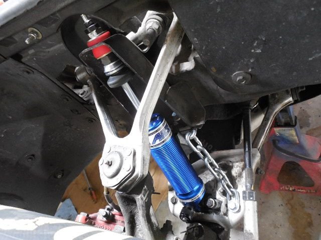

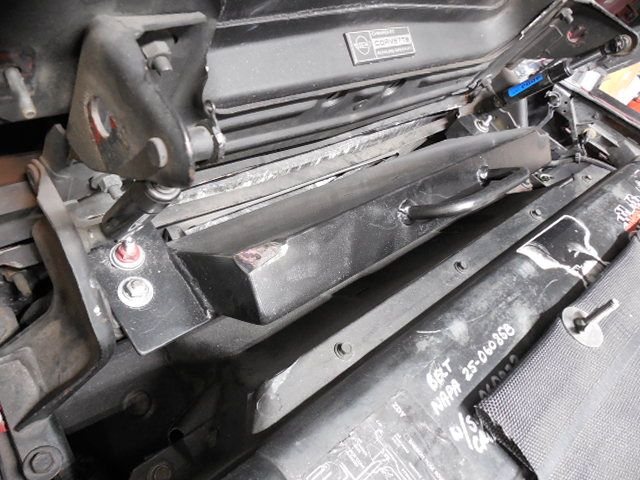

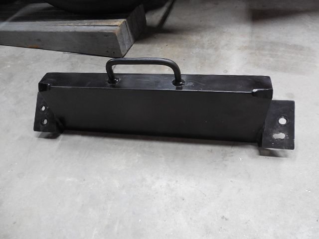

..... So far , so good ! ... the car stayed earth bound with the new shocks and ballast ... picked them up a couple of inches and for a short (3-4 feet) distance ... It is hard to tell how much ET the extra weight cost me because we were running into about 15-20mph headwinds all day ... the car did go 1.367 60' and 6.651 at the 1/8th but the air was terrible 2400' DA 58% humidity with over 100 grains of water ... the race is being live-streamed on SFG Promotions Facebook page ... my first round pass is at about 33:00 mark ... I didn't have time to look for others , had to get some shut-eye ... todays weather will interfere 100% chance of rain but it won't last long .....

..... OK , Sunday's weather threw everyone for a loop trying to come up with a dial-in ... only new arrivals were allowed a time run ... the rest of us had to "wing" it ... the temperature for 1st round was about 30 degrees cooler than Friday ... 52 vs 86 , the wind was blowing about the same speed 15-20mph BUT it was a tailwind on Sunday vs headwind on Friday , and the DA was in negatives ... -553 vs +2438 on Friday ... I dialed a 6.52 and ran 6.476 , lucky for me , my opponent red lit ... 2nd round the temp was up to 68 and the DA was +658 ... I dialed 6.49 and ran a 6.52 but my Jack Roush sponsored Maverick opponent was a bit slower off the line and ran .003 under his dial to break out ... 3rd round weather was pretty close to 2nd round ... but it was my turn to go red ...
..... Through it all , I managed to keep the front wheels mostly on the ground , doing a short wheelie both in height and length ... the double adjustable shocks and ballast get all the credit .....

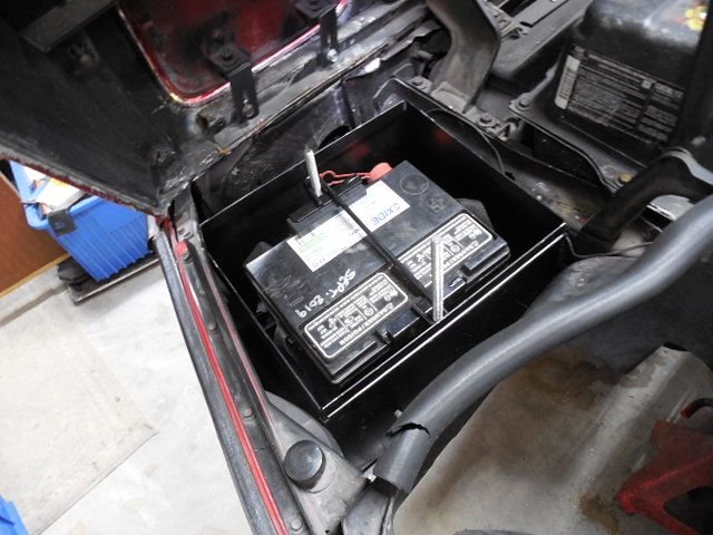

..... I'm going to try a slightly different approach on the ballast this weekend ... I have mounted a 35# battery in the fenderwell on the driver's side in front of the axle where the headlight and charcoal canister used to reside and removed the 65# "briefcase" ... I'm thinking that the double adjustable shocks and ballast battery (it is fully functional) will do the job of keeping the front end down ... We shall see ! .....

..... Whew ! ... What a weekend ! ... The extra battery for ballast was more than enough to keep the front end near earth ... in fact , I'm sure that the double adjustable shocks alone would have been enough to calm down the wheelies , but the extra battery capacity came in handy to keep the radiator fan running in an effort to cool things down in the staging lanes in later rounds ...
