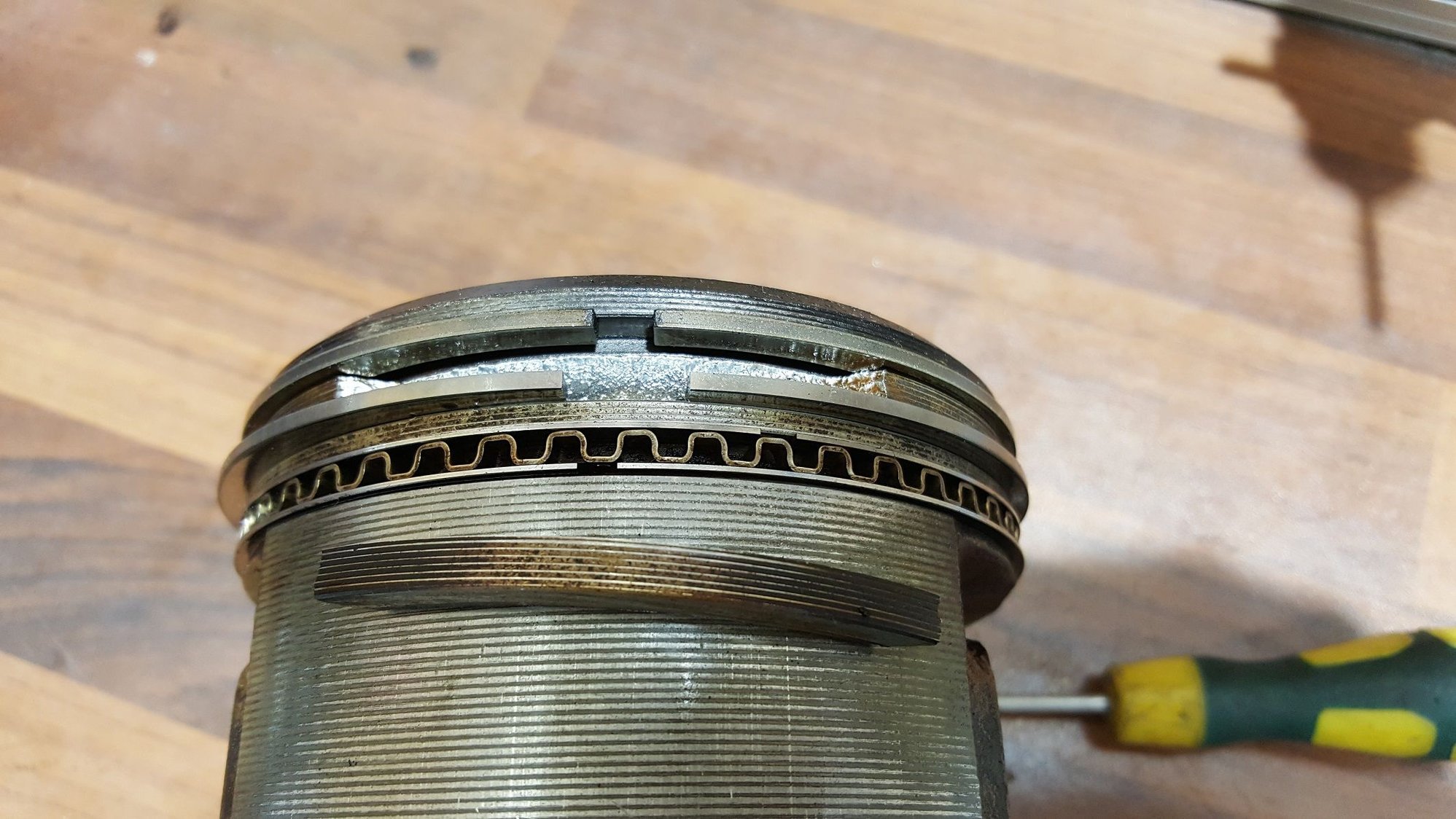

I found an old log of the event/pass when I cracked a stock cast piston: https://datazap.me/u/tequilaboy/crac...4868-4915-4782
It broke near the top of third gear around the 1/8 mile at about 92 mph. The dipstick popped and created a big smoke show, but at least it didn't oil down the track. You can see the O2 drop just after the failure before the throttle was lifted. Power was down considerably in 4th gear, but still trapped around 115 mph.
Unfortunately, this failure was self-induced. While experimenting, I had botched the indexing into the main spark table and (unknowingly at the time) ended up with about 36 degrees advance which was much more than intended. Just to reiterate: be careful with the timing.

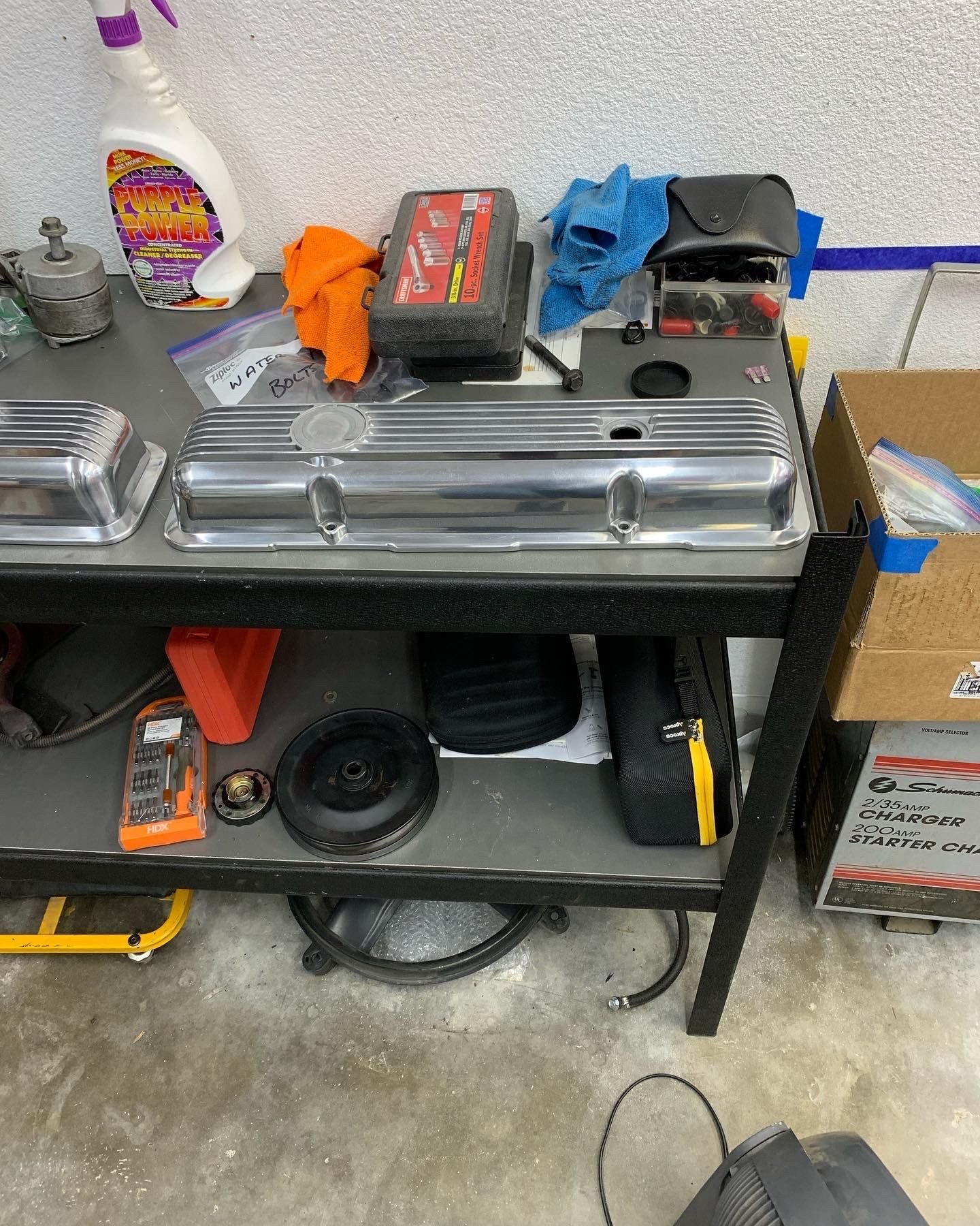

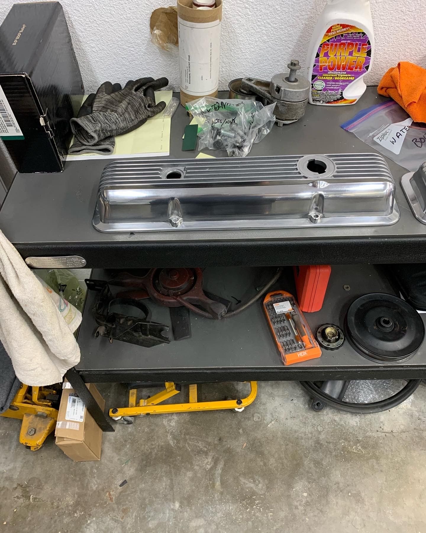

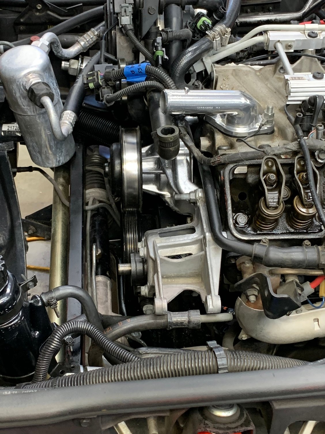

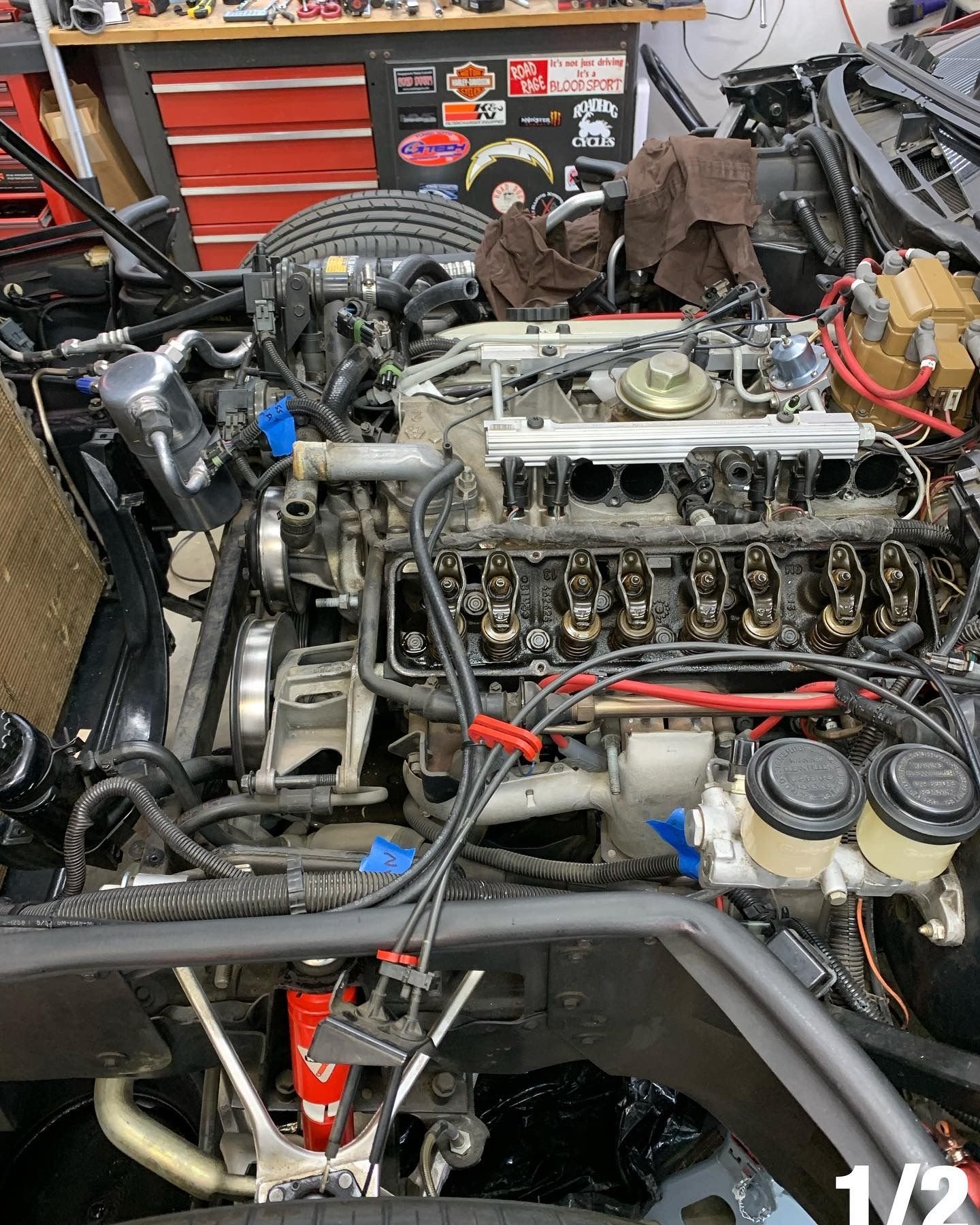

Man I forgot to post up on this thread. Things were going slow however , I manage to strip the motor and slowly building it back up.
After that I replaced the crank seal since I was there and it's good insurance. Ended up replacing the harmonic balencer since my orginal was starting to show crack rubber. Then install the high flow water pump.
I also repolished my valve covers cuz 1 of them had some imperfections I didn't like.
Today I was fighting with the manifold trying to get the old gasket material left on the intake manifold. Ended up pulling the fuel rails to get in there. I did get the runners on and torque down.
And to satisfy my curiosity I had to see what the plenum and valve cover look like to end my day with a smile. Will be installing them tomorrow.
I have a new Doctor who was straight up with me. He dealt with people with my level of surgery and pain management. Pretty much told me that I should have overcome all the issues that I'm still experiencing early on after surgery. He recommended more physical therapy but I opted not to do it. I'm kinda tired of PT and I decided to just get back into working out like I did before my back started going down hill. .
Currently working on exercising, cardio and pushing iron 5 days a week. Its challenging, it hurts and I"m pretty much done for the day after I complete a 2-3 hour workout. It's only temporary till my muscles and back gets use to the routine. So that is what I have decided to do to improve my back and functionality. Feels like old times again.
Unfortunately, I'm down to the weekends working the vette. I'm able to substain more than a few hours easy now when working on the vette. Seems like things are starting to get easier and that I'm grateful for.
My goal on the vette for now is to get everything back on and fire it up so I can check for leaks. Next will be working on getting the radiator in, alternator, smog, belts etc,, to get her fired up.

We are officially done with the top end. The heat has slowed me down. Last 10 days has been brutal. Reach 111 degrees at one point, but basically over 100 degrees.
Next goal is to get the radiator installed as well as the smog pump and alternator. I want to do a fire up before I actually start on the Procharger, so I can ckeck for leaks. Beside I need to check fuel pressure because I replaced the bolt in the adjustable FPR. Why, don't ask..LOL

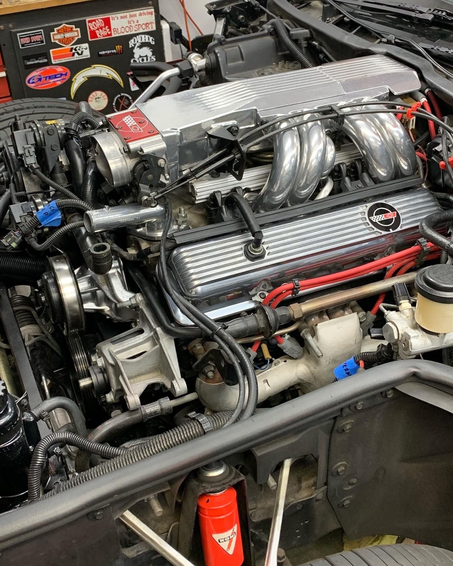

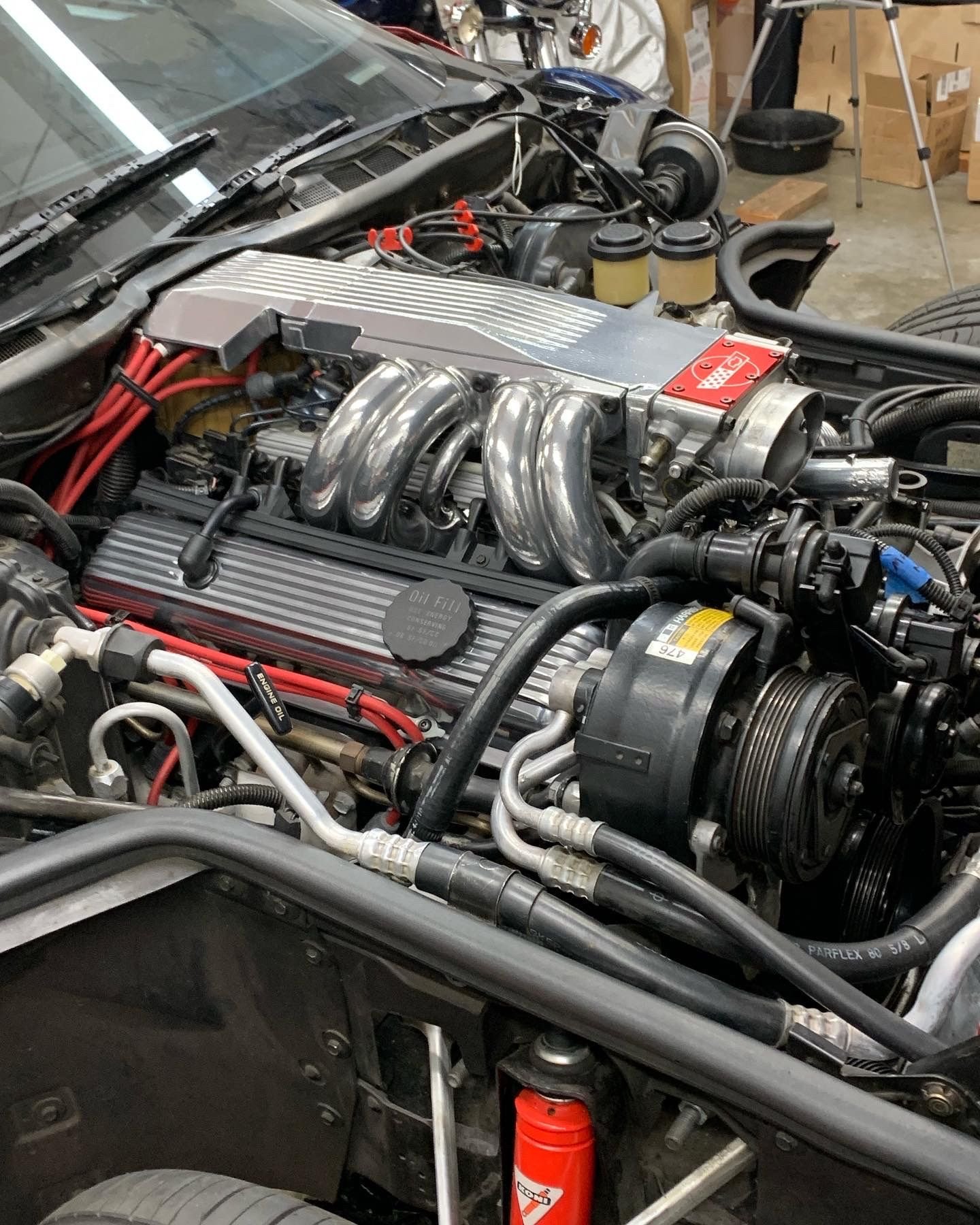

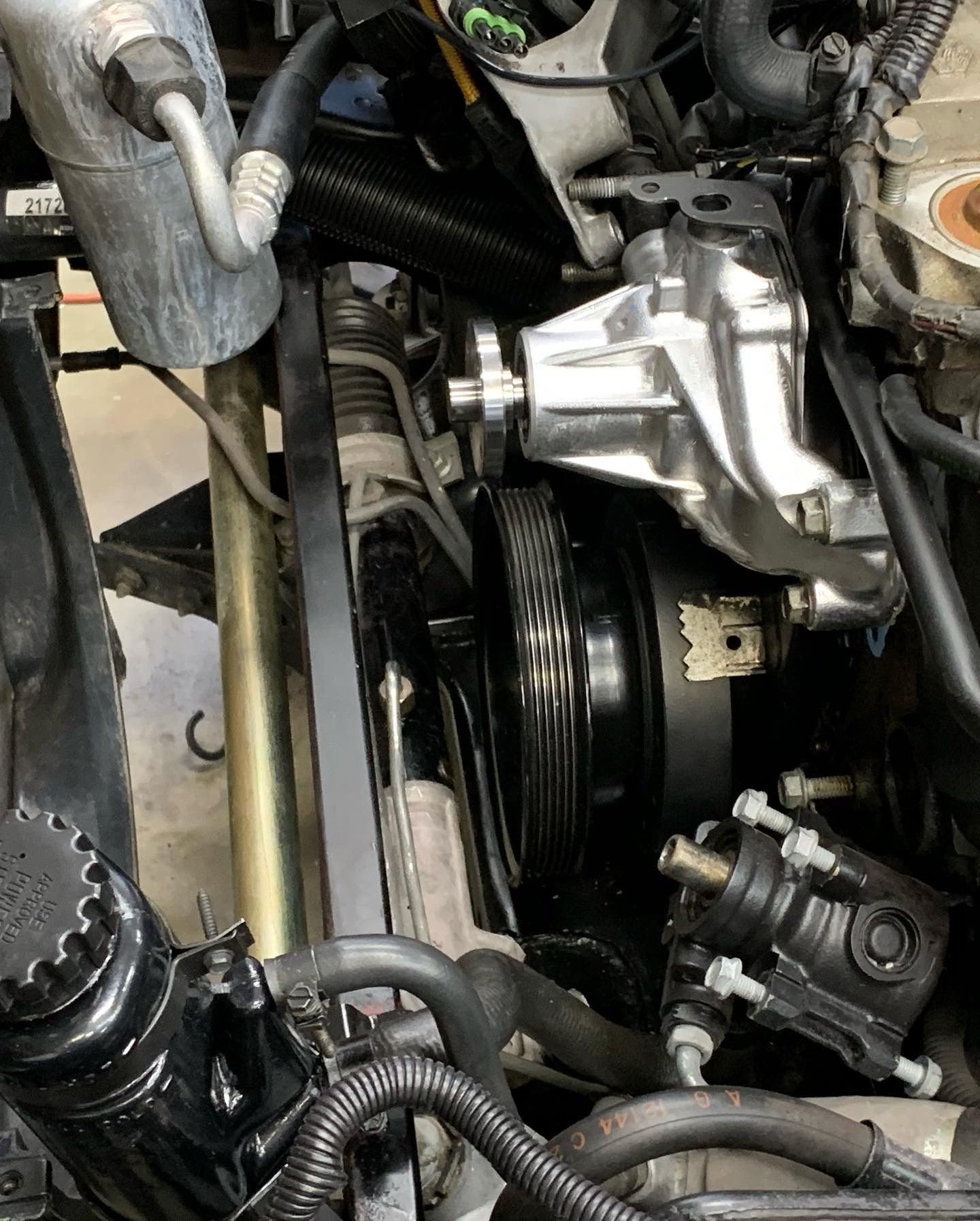

Well, I'm getting closer to a pre-start on the vette to check for leaks or issues with the current mods I have done. Coming along very nicely.

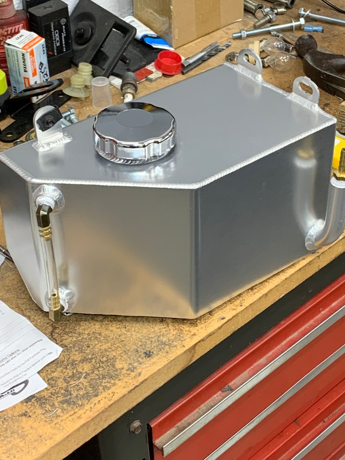

Radiator is in. What a pain in the *** that was to fit it in the stock location. Fought me all the way.
All the vital components are on the vette.
Can't wait to get rid of the current alternator and smog pump. Smog pump I'll get to throw as far as I can and I have a real nice alternator replacement.
So I'm down to a installing the belt and top coolant hose. Add coolant, power streeging fluid and I'll be ready to fire it up.
If all goes well then finally l'll be working on putting in the supercharger kit. Been a longtime coming, but projects start off simple, but seem to get added stuff along the way. LOL
An added bonus to keep it in the aluminum theme with a aluminum coolant tank.
Hope to have more progress soon.
