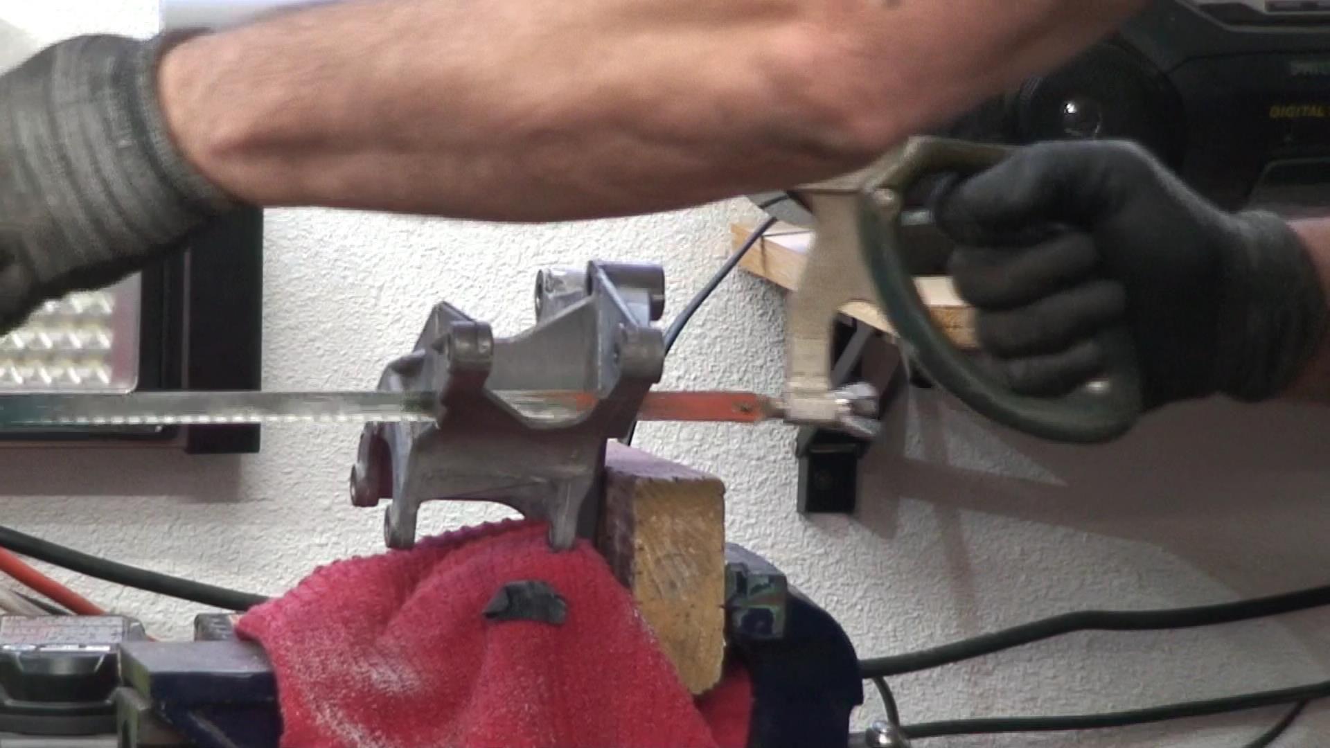

i have reached a point where It’s all supercharger parts going forward. So there has been a little progress on it. Pulled the smog pump and alternator. Then removed the power steering pump and bracket.
After that I cut the alternator tabs off the bracket as per Procharger instructions. Its to make room for the supercharger. The alternator witl not be going back in its original place. Smog pump now deleted.

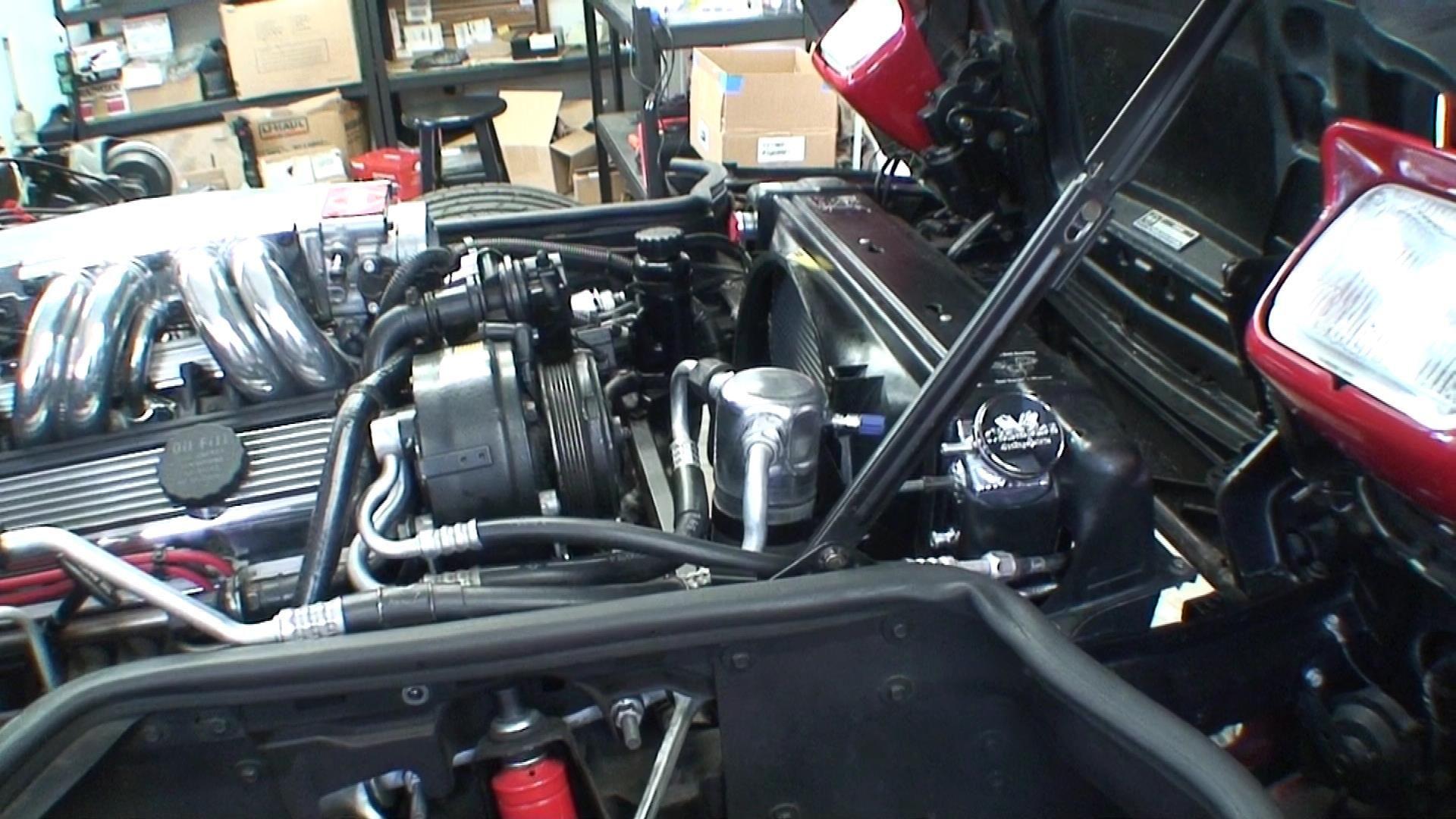

And one last look at the way the engine bay turned out:

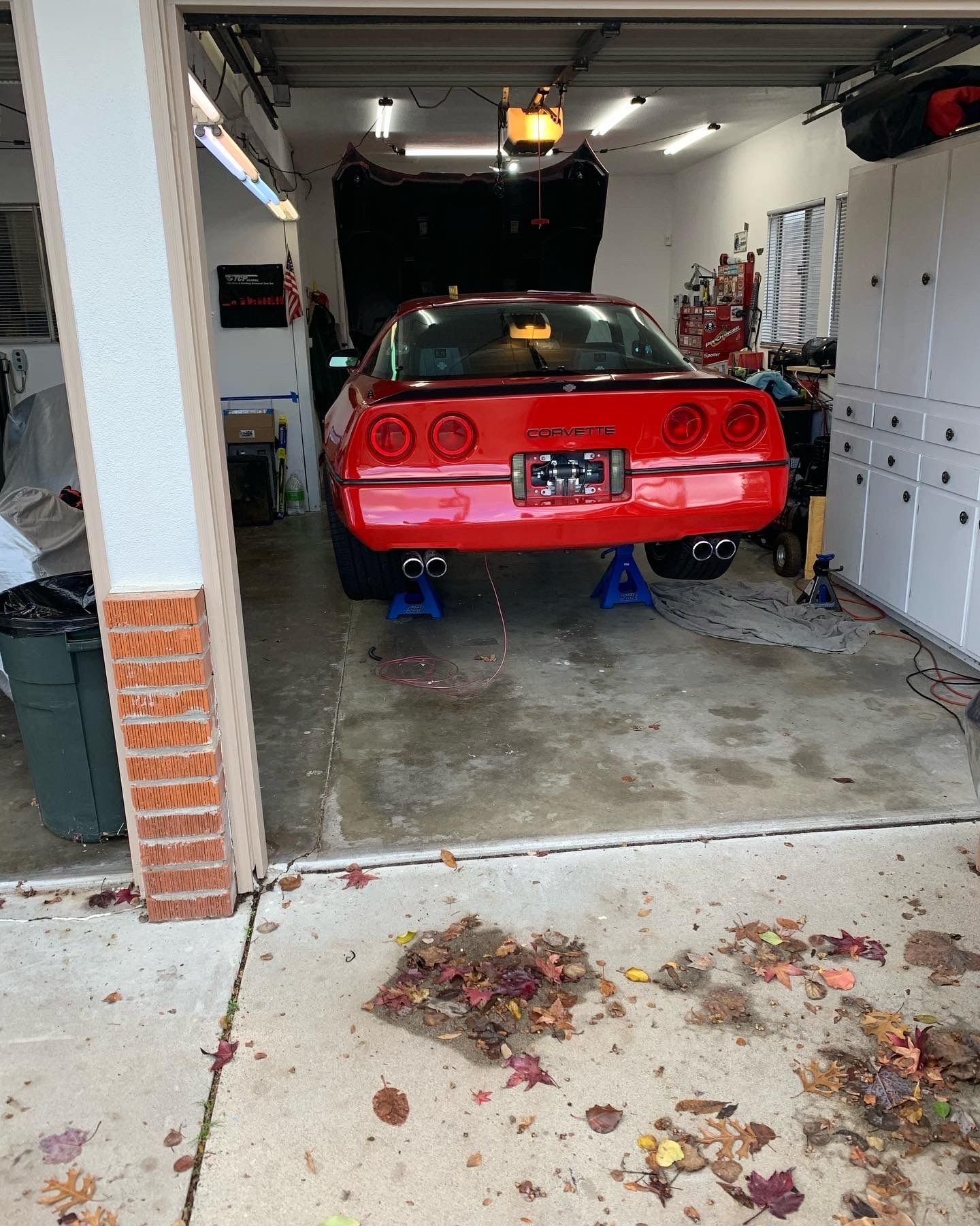

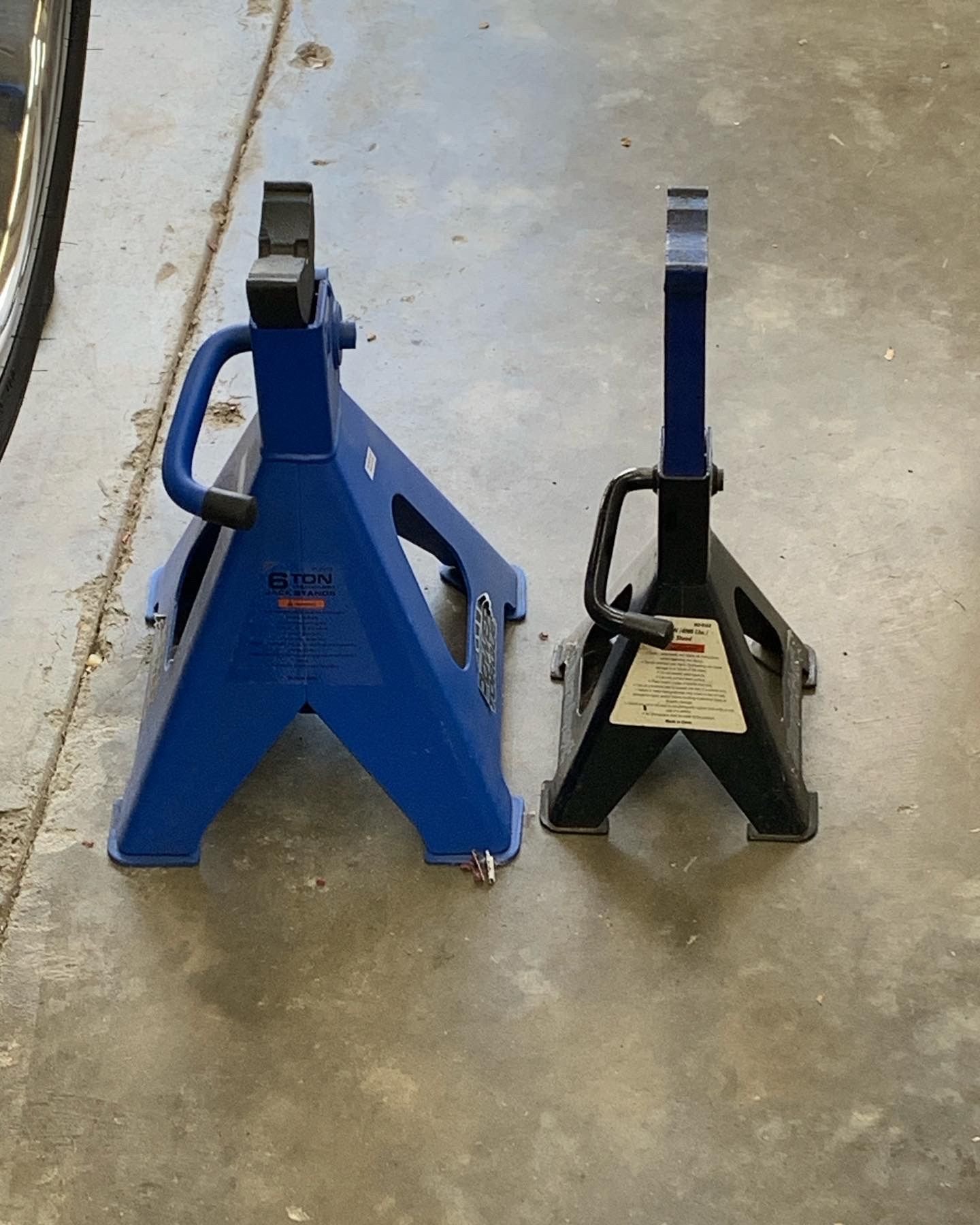

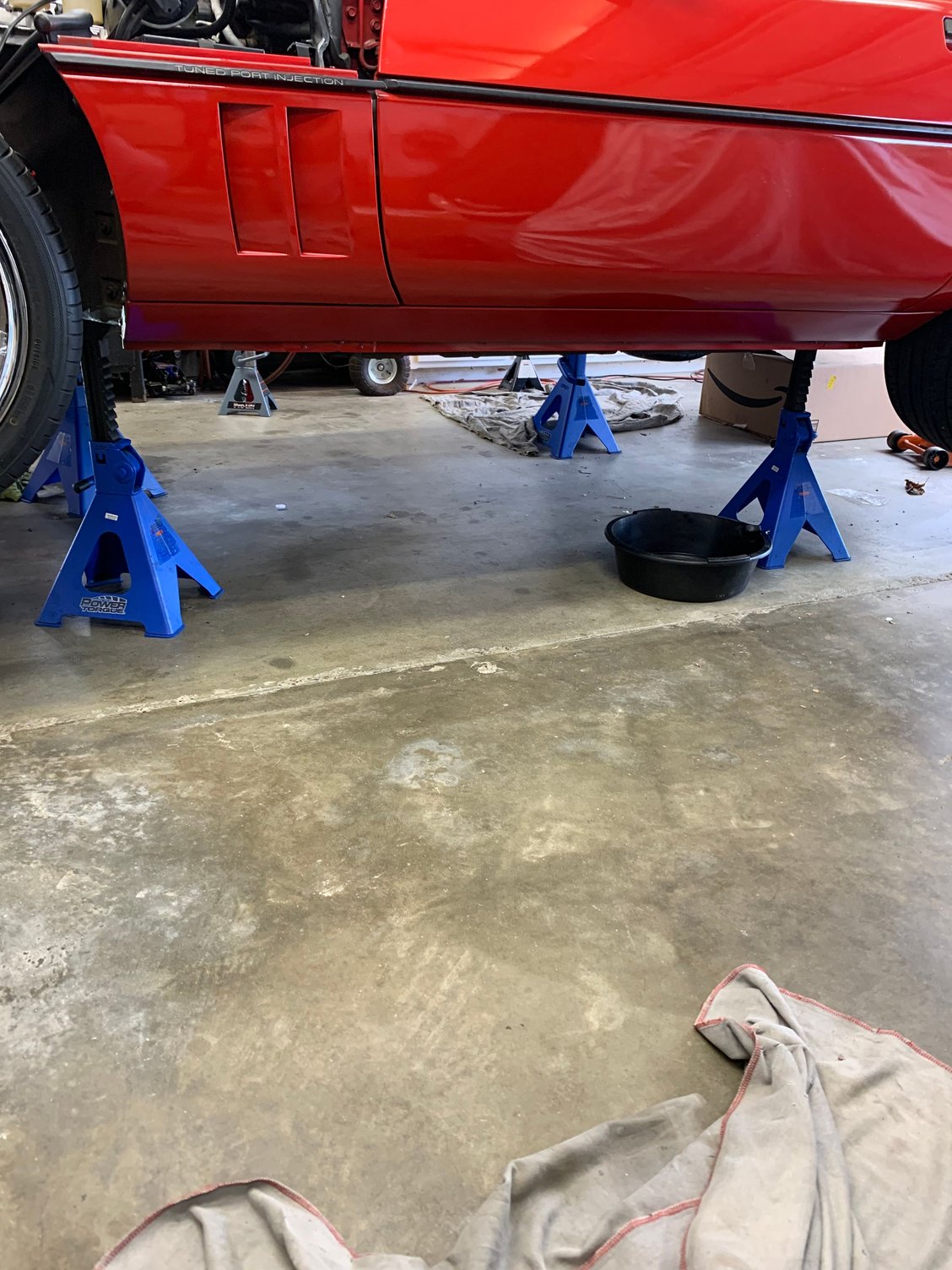

A little progress since I last posted. I'm going to be working underneath the vette so decided to jack it up in the air more.
Size does matter.. LOL
FMU has been installed:

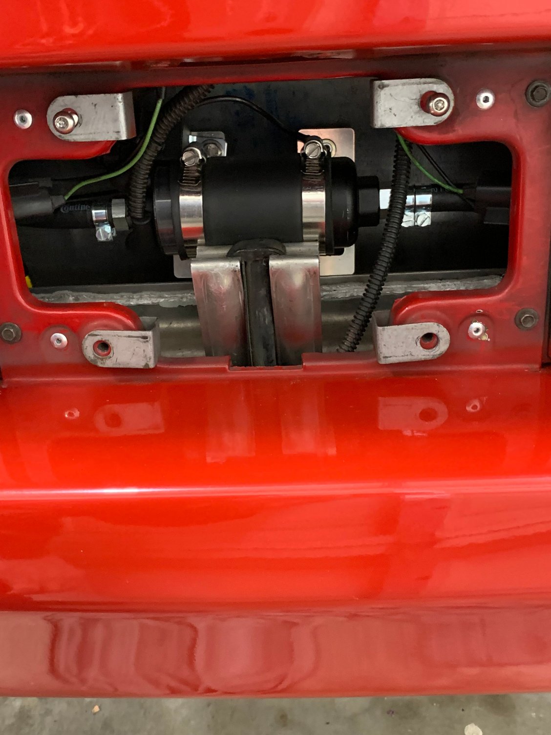

And the external fuel pump is also installed:
As you can see the hood open I have literally 1.5 inches..
That should be enough room to work underneath there with my new low profile creeper..

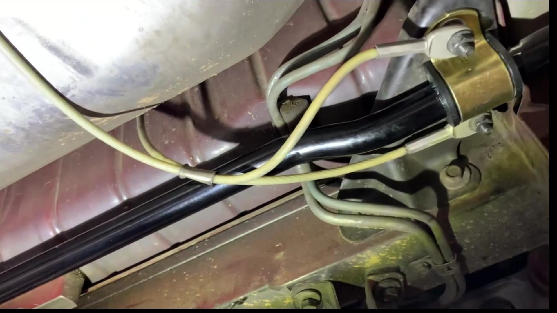

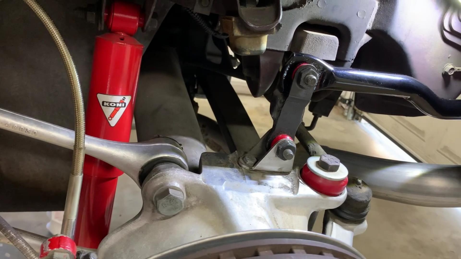

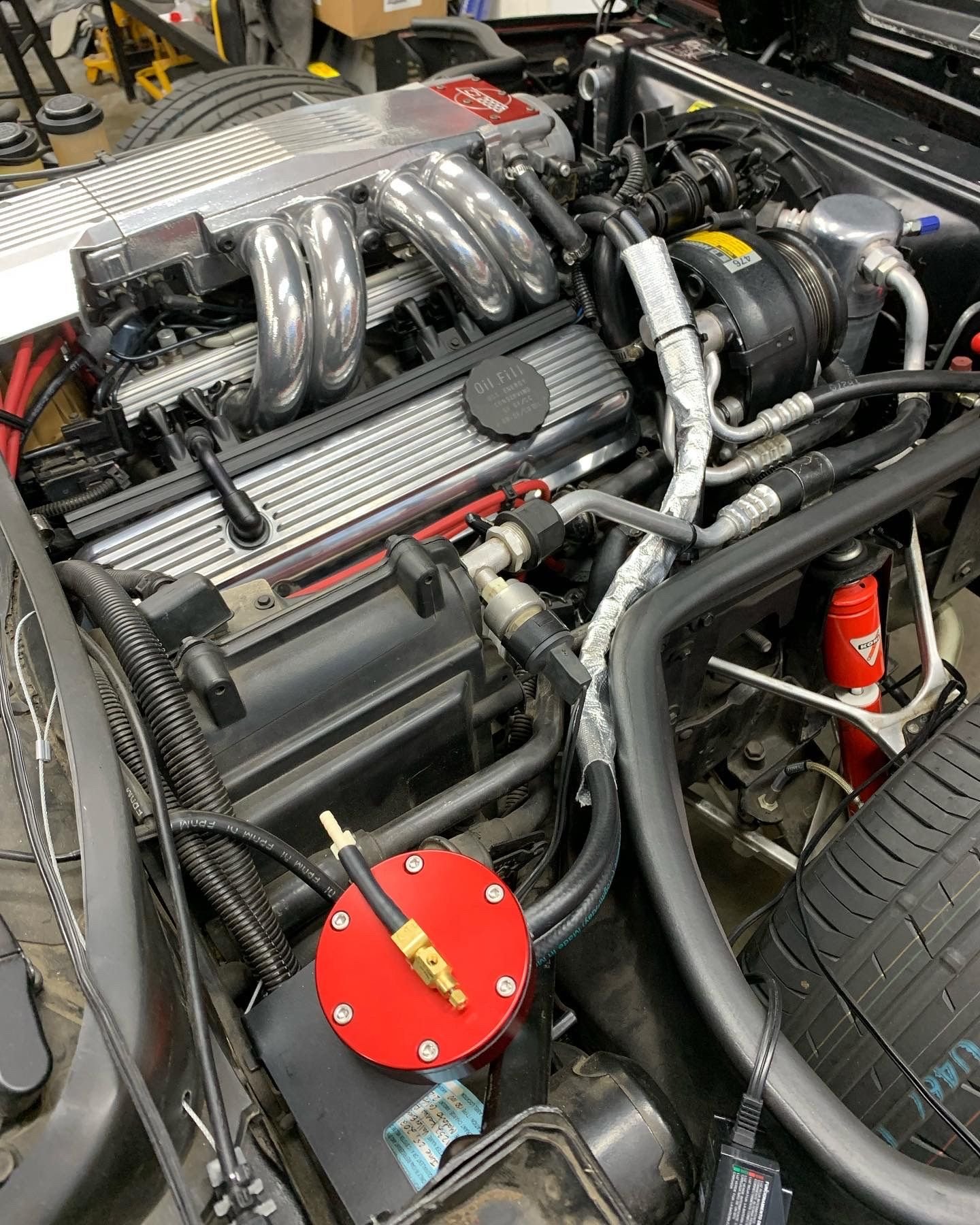

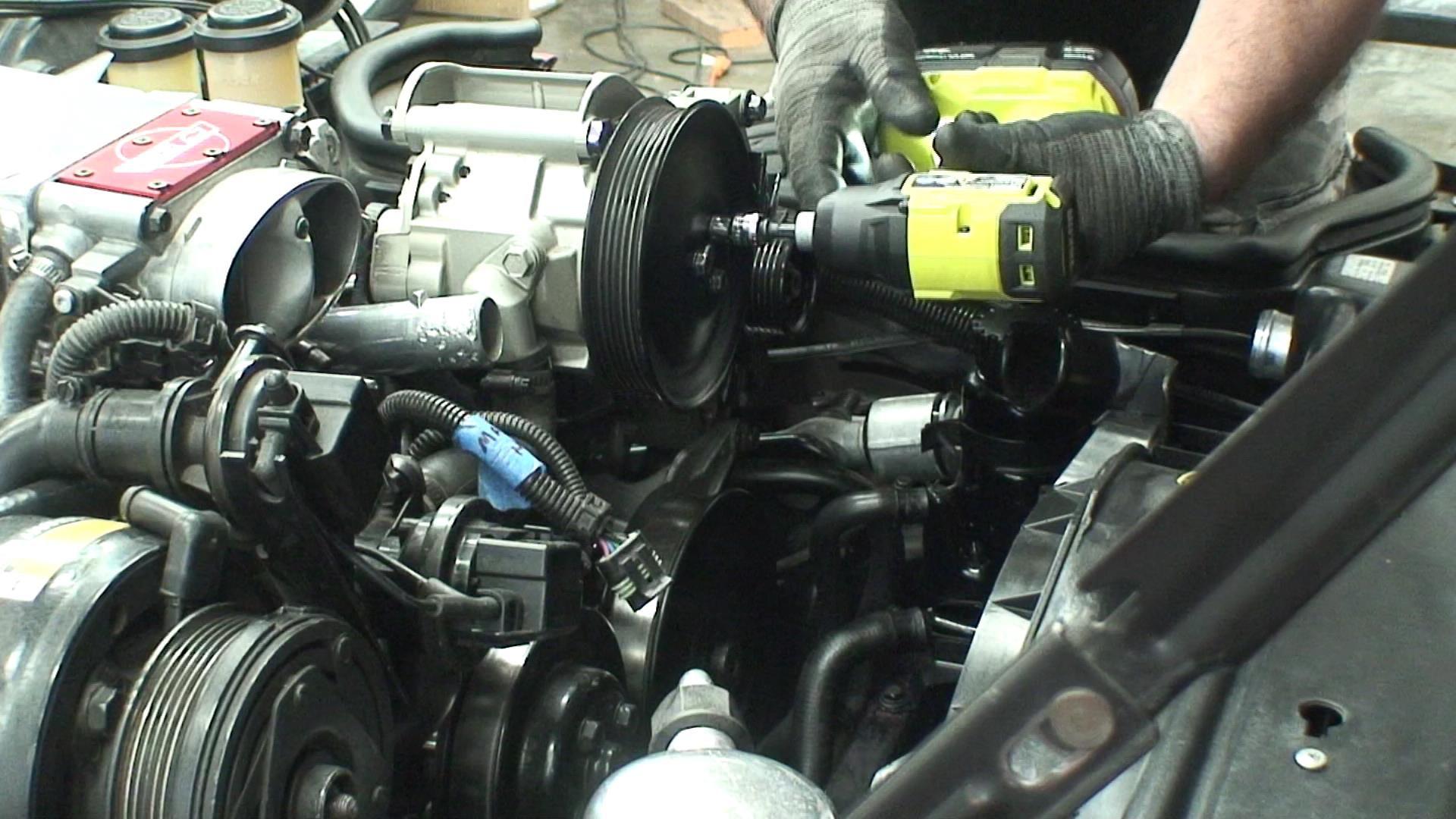

We are starting to pick up steam.
Alternator and smog pump removed.
FMU re-stall:

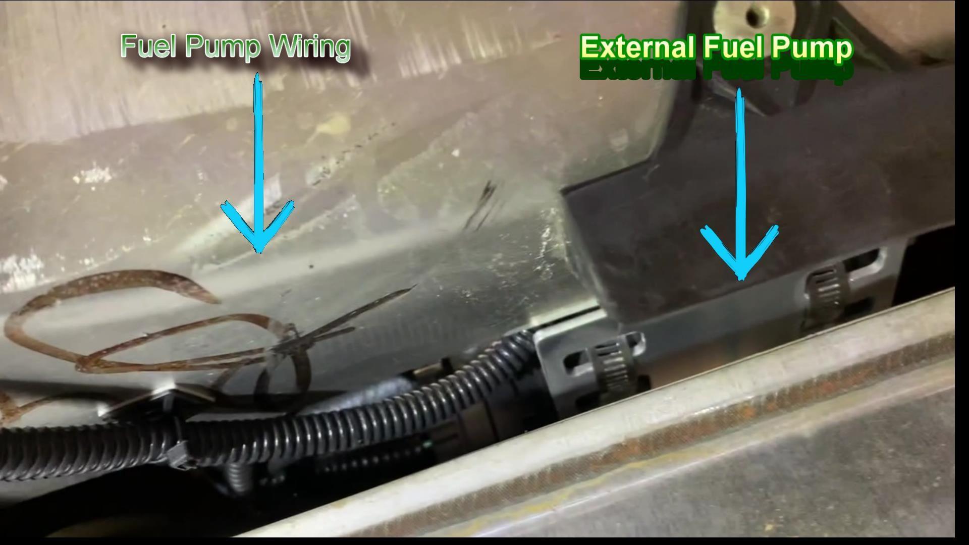

High flow fuel pump wiring is completed.

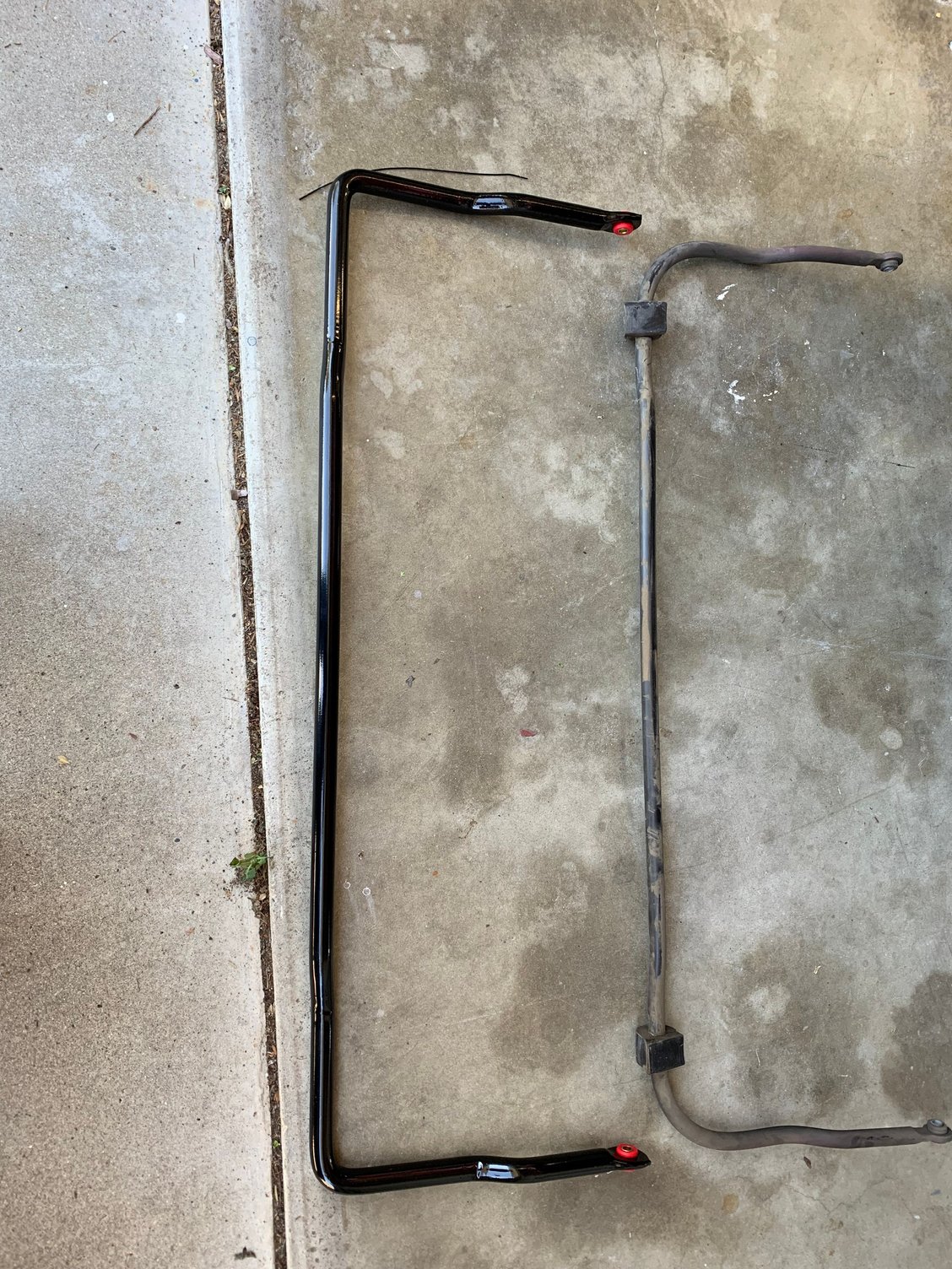

Sway bar completed:

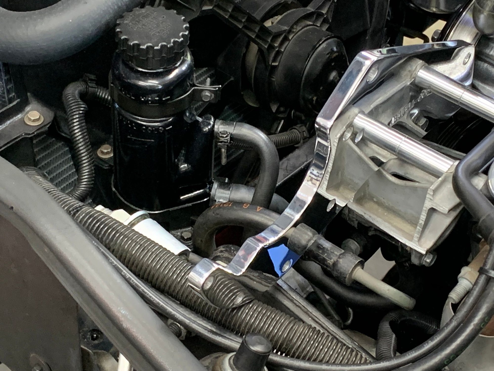

The supercharger bracket is on:
I just pulled the starter, however the oil pan is fighting me ATM.. As soon as I can get it off then I'll modify a supercharger return line.

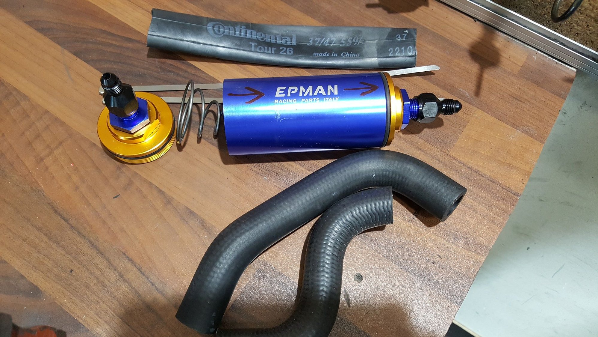

I also added an oil filter to the oil hose going to the supercharger.
It prevents impurities from entering the supercharger and blocking the oil nozzle.
I bought a broken supercharger and rebuilt it.
It was broken because the oil nozzle was blocked and no oil could flow into the supercharger at all.

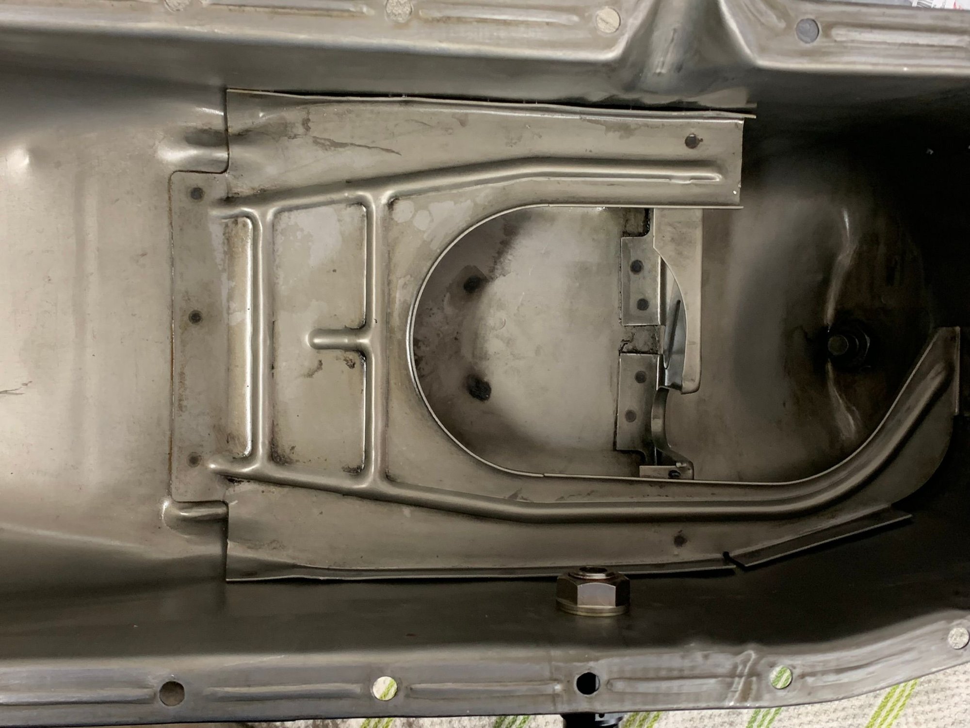

I also finally pull the oil pan after fighting with it and will be tapping in the supercharger return line this weekend.

I strongly recommend it, the filter is a cheap insurance that the supercharger gets enough oil and the nozzle doesn't get blocked.
I bought a case like this and the motorcycle oil filter fits well inside it and it is easy to change.

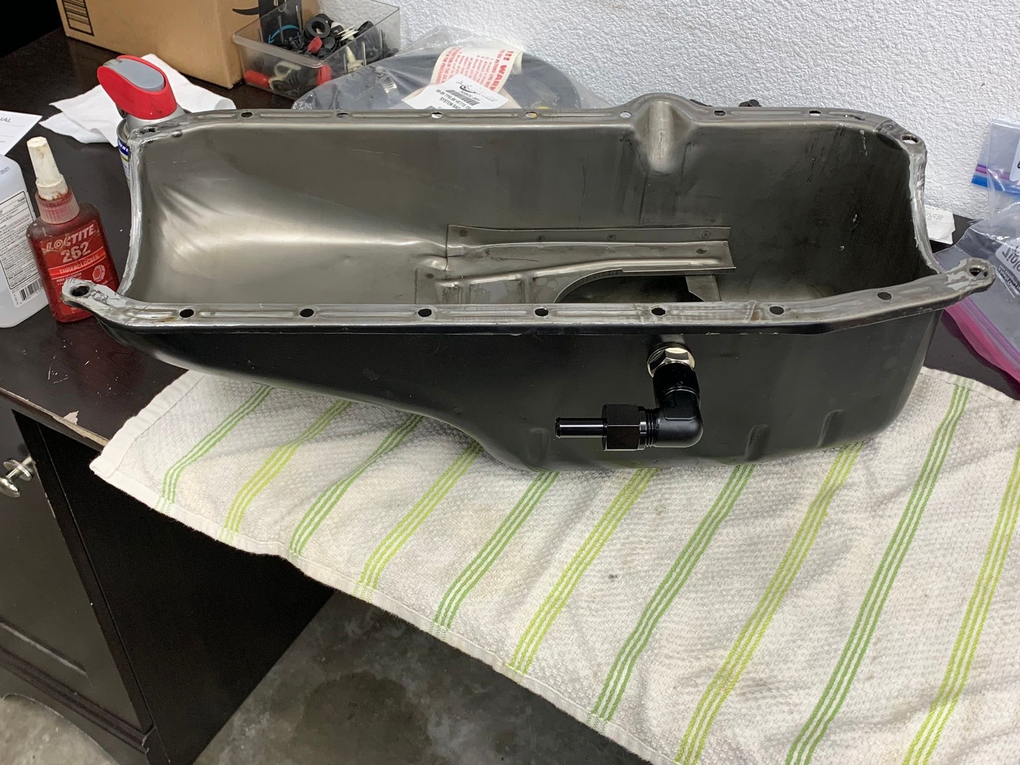

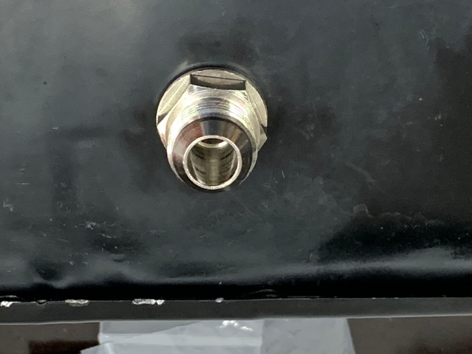

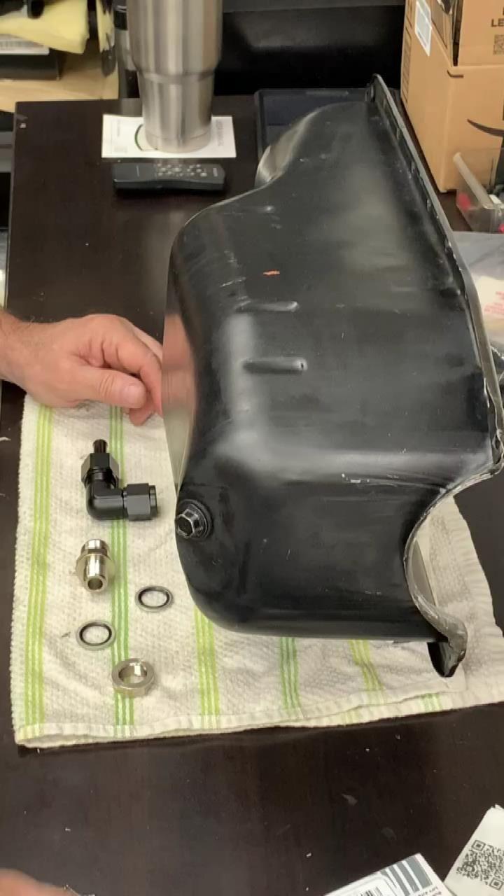

So I got the oil return line plumbing done on the oil pan. I went with a oil pan return/drain plug adapter rather than going the route that procharger recommended (with the pan on).
More work having to pull the pan, however it is a cleaner install.
Now that this part is done I'm sure it will be easier to install than it was to uninstall it.
Once I get the pan back on I can move on to the rest of the plumbing and get ready for the supercharger install which I'm so looking forward to see on finally.

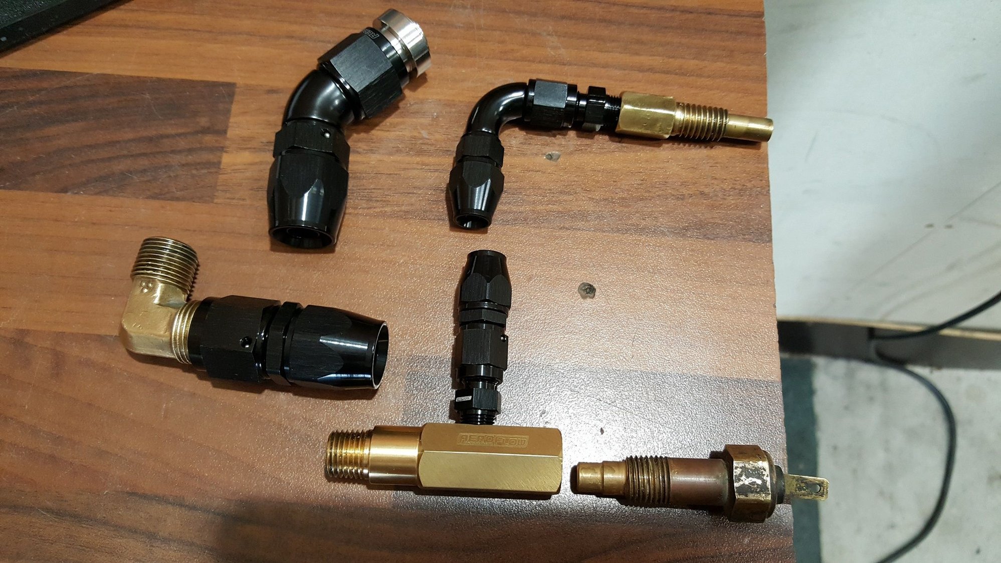

Had a small hiccup with the supercharger oil feed line setup. The sensor above the oil filter (Procharger recommends tapping into) ended up being too wide for the Procharger t-fitting and not able to go that route unless I got a different t-fitting.
Even if I could have made it work the length of the extension pipe, t-fitting and sensor would have put me to close to the firewall. I didn't like it to begin with, but it didn't hurt my feelings to go a different route for the supercharger oil feed line setup.
I opted to go with a GlowShift oil filter sandwich plate adaptor with oil ports. A slight modification will need to be done by enlarging one of the oil ports to a ¼ npt in order oil line and fitting Procharger provided.
I order the sandwich plate but I have not receive it yet. For some reason it’s was a good 2 week wait. Should have it next Tuesday.

I built the oil feed for the supercharger like this:
I bought an adapter for the oil pressure sensor, which I had to drill a little deeper to fit the oil pressure sensor.
https://aeroflowperformance.com/afga...ge-1-4-adaptor
This is how I made sure that clean oil goes to the supercharger and I didn't choose any other outlet. Make sure that your output is clean oil and not dirty oil that is just going to the oil filter.
And so I added a filter before the supercharger so that the oil nozzle of the supercharger does not get clogged with dirt under any circumstances.

i went to lowes and found some brass plumbing fittings that fit, looked like what MrBigDee did.
i did not have a need for a separate oil filter on the oil feed line into my p600b.
ita my understanding whats coming out of that fitting (for the oil temp sensor) is already filter oil from your oil filter.
The extra filter is prob a good idea, but i never had that nozzle clog on me with the way i was doing it. I was always checking it too
