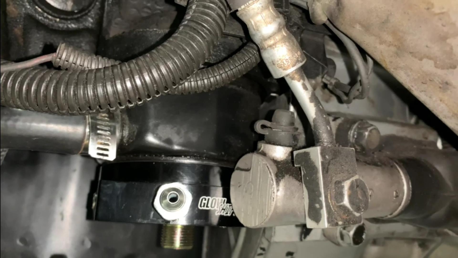

i went to lowes and found some brass plumbing fittings that fit, looked like what MrBigDee did.
i did not have a need for a separate oil filter on the oil feed line into my p600b.
ita my understanding whats coming out of that fitting (for the oil temp sensor) is already filter oil from your oil filter.
The extra filter is prob a good idea, but i never had that nozzle clog on me with the way i was doing it. I was always checking it too
Thanks for your input dizwiz24. I probably should have gotten off my a$$ and went down to Home Depot and see what I could of found to make it work. I think what was chipping at me is the tight area I had to work with. It’s bad enough the C4 Corvette is already plague with the lack of space to work with, mostly everything you can think of. LOL
The sandwich plate will makes things more convenient and accessible. I too will be monitoring that supercharger oil filter quite frequently.

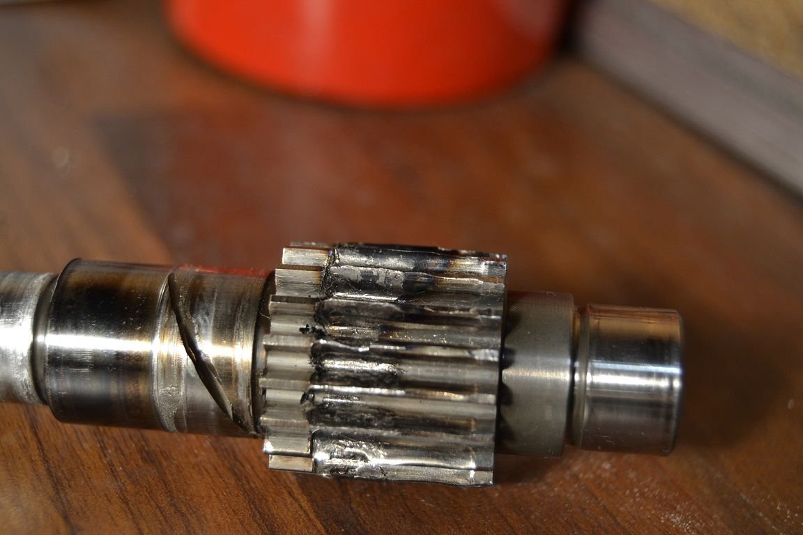

When I bought my own P600B supercharger it was broken, the cause was a nozzle blockage and therefore a bearing damage.
When the shaft bearing had failed, the impeller was damaged next.
True, even if the oil coming through the oil temperature sensor is clean, I would like to be doubly sure that the oil is clean when it comes to the supercharger. That's why I added an extra filter before the supercharger.

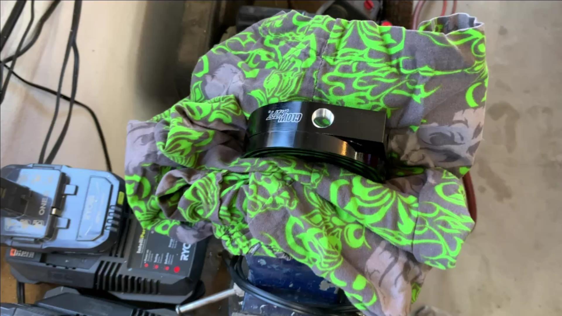

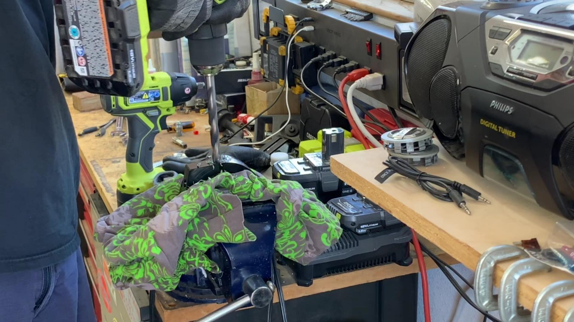

I did get some work done while I was playing. I had to drill and put new threads on the sandwich plate adatper to prep it for the Procharger fitting.

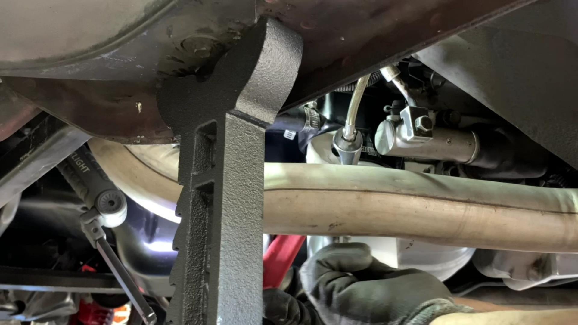

I did get the oil pan back on and what a PIDA this was. This was quite a battle and beat me a few times. I think the worst part was trying to hook up the coolant tube that connects underneat the AC compressor. What the F'k was GM thinking. But the pan is on and the supercharger oil return line is completed.

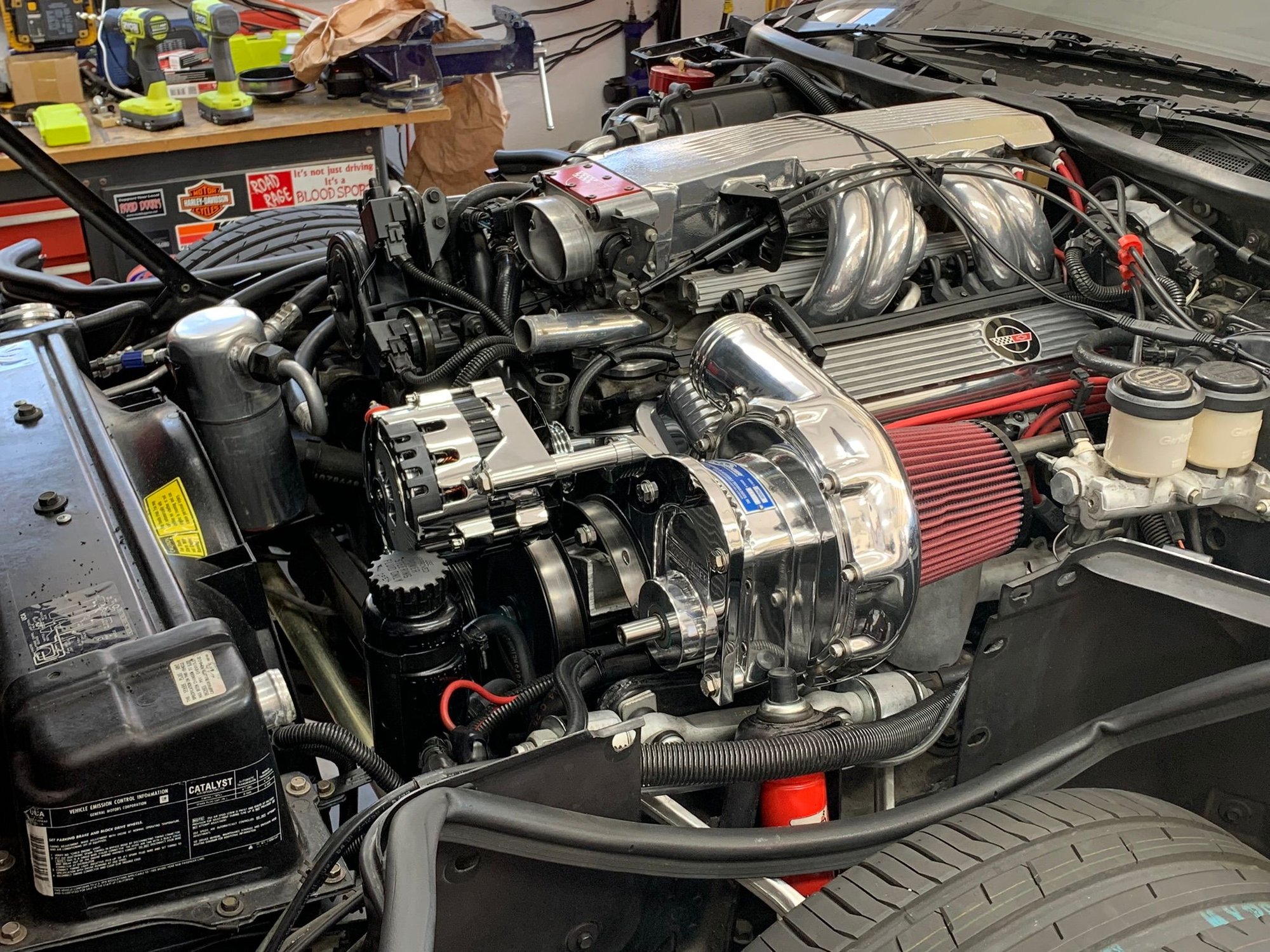

The bracket arrived and I guess my coffee break is over. Hate when that happens.

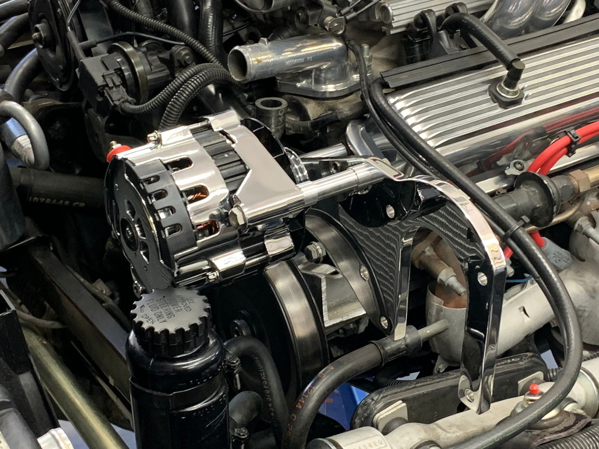

First up was getting the bracket and alternator on.
Soon after that You'all know what follow:
I mock everything up so I could route and attach the oil feed line and return line.

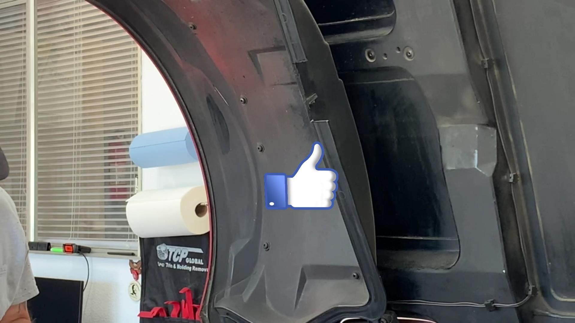

Next I cut off a portion of the fender so the SC would clear.
After that I was able to attached the SC permanently.
All set here.
I'm in the process of editing the YouTube portion of this installed. Should have that up in about 1 week or 1 1/2 week.
Now it is time to move onto the Procharger Intercooler which is the last peice of the puzzle on this install.
So thrill that the SC is on it's been a long time coming.

  #75
MrBigDee's Avatar
MrBigDee
Joined: Nov 2015
Posts: 376
Likes: 102
Great!
It looks great and I also remember that installation point myself.
