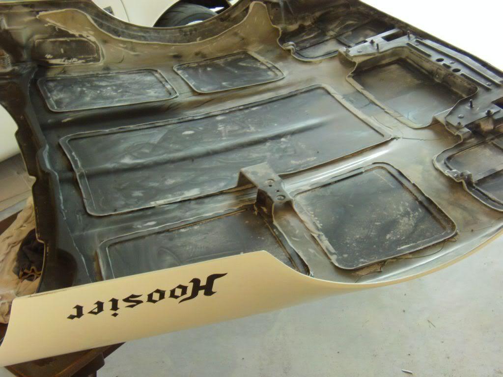

I have a thread on that I can try to find. It's messy but not difficult or time consuming and it's free. I had a few versions of it, one left the strut in place. Another version I did I moved the strut for more room on that side for coolers I think. It has been awhile. Also check the weight thread it's probably listed there.
https://www.corvetteforum.com/forums...-and-info.html
'88 stock hood with everything - 110 lbs Source
'88 stock hood, no headlights/underhood lights - 80 lbs Source
'88 hood w/ structure removed - 64 lbs Source

Sounds fun! In the picture above the hood still worked like stock. After awhile and hunting for less weight I did go to hood pins. There is a lot to do on these with so many small parts.
