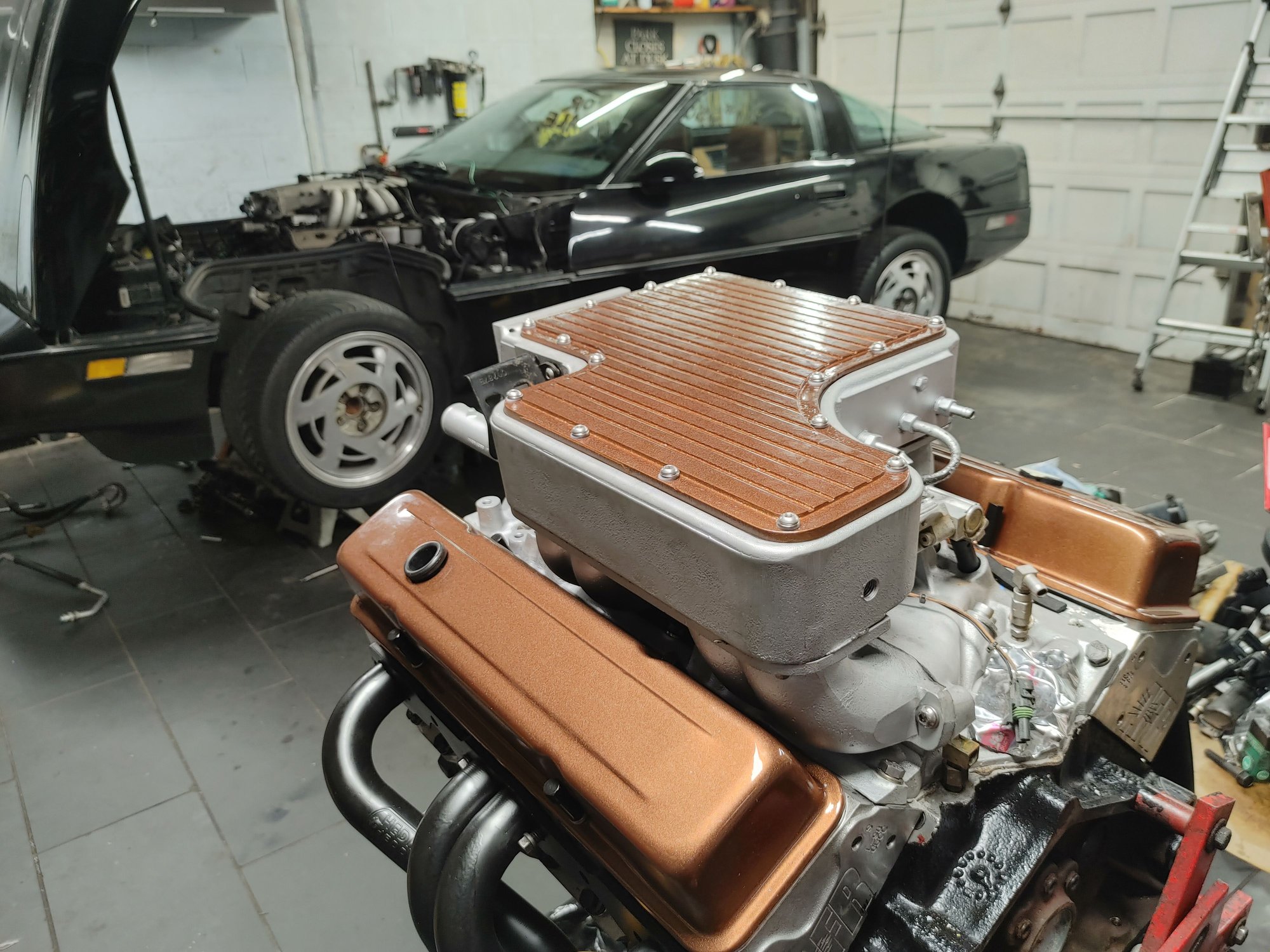

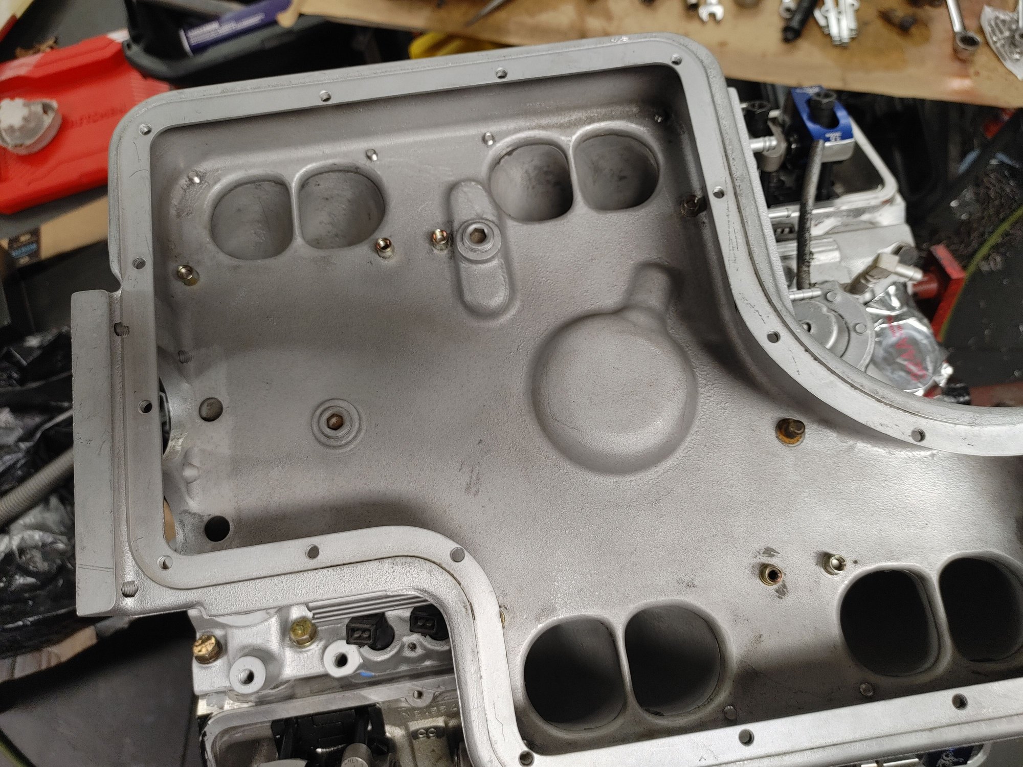

Big week ahead. Transmission is ready to come out tonight and new engine in by week's end so long as the bell housing registration is with in 5 thou but I'm shooting for 2.5 thou. The intake needed lots of thread repair, spent a 1./2 a day on that alone.
