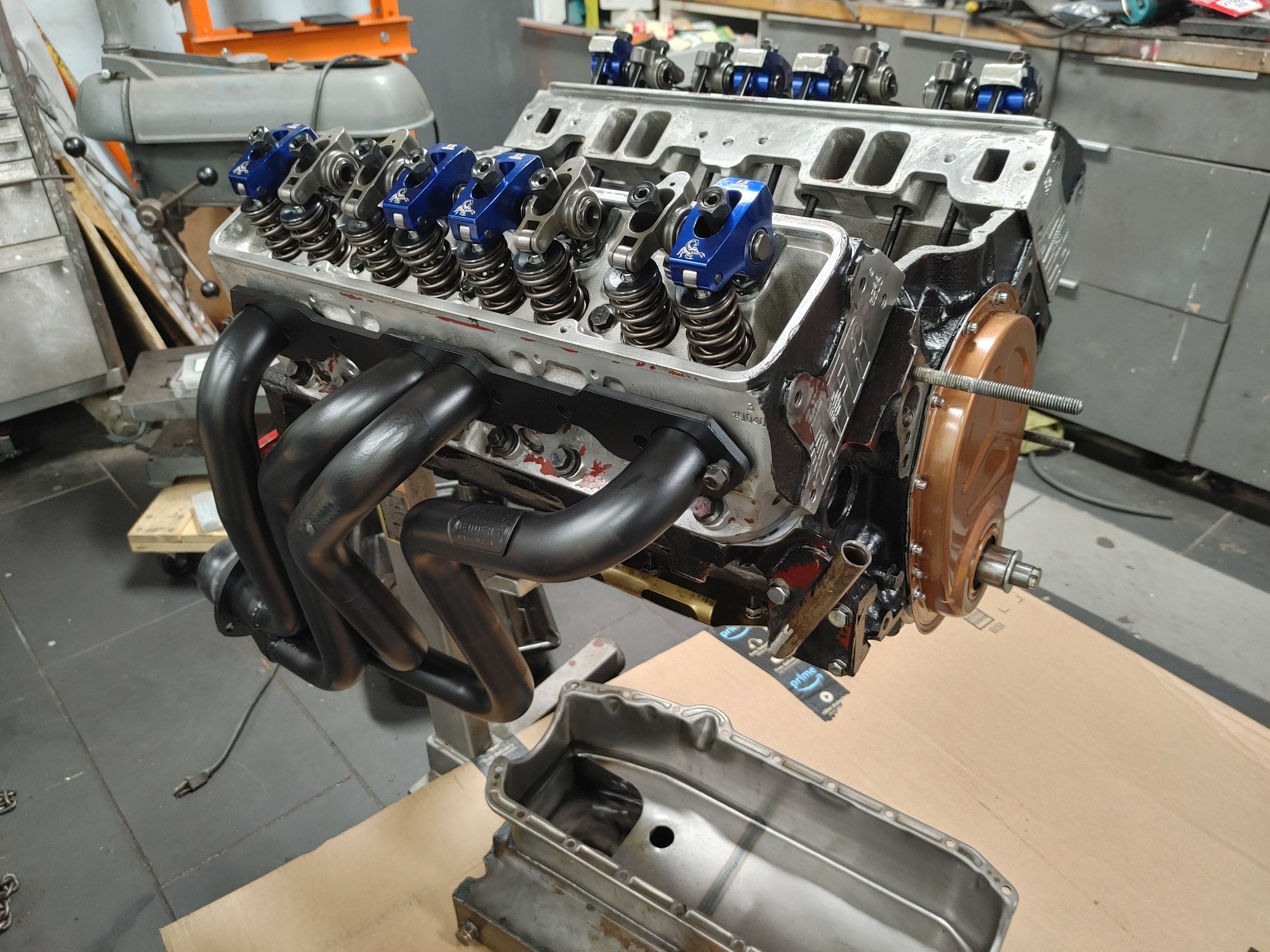

Hey, please allow myself to introduce myself.... I'm Giovanni and I'm Building a fun C4 for DE road racing. I dont know... what I dont know.... so lookng to get up to speed quick. First track day is May 30th 2024 and car must be fully shorted for the 'Empire Cup'.
What I'm stating with is a 1988 Z52 4 speed with an rotational clanking engine noise. Noise remains with the clutch in so I'm thinking it's in the engine. Dragged the C4 home for a great price on the coldest day of the year around the holidays. It was the best Corvette I could find for the job having been the right price and already too far gone to ever be a nice / valuable car.
I dont know much reguardng C4 suspension, safety, transmssion, cooling, and other mods needed to be sucessfull at DE
My plan so far....
SBC 406, Lngenfelter intake, mild cam (engine was in another car and perfromed great on the track, see pic below)
Power steering oil cooler
Bilstein Shocks. Lower B5 Z51's on the rear
OE 17 wheels wth R compound tires
Lower the rear end 1 inch
C5 front brakes
EBC blue Track pads
Convertibvle brace
Delph 0119 fuel pump, (enough for 500HP ?)
Headers, X pipe, Borla's . (Some DE events now have noise restrctions)
My goals:
-Under a minute at Limerock Park this year. In 1985 an 1984 C4 did it 1:04 with a good driver. I'm hoping I can get to 59.9 wth double the HP and better tires.
-Under 0:58 next year.
I know the engine is up to track duty...I tracked it for 3 years while installed in a '76 Jaguar. And just took it a part to rebuild and it was in far better condition than I feared.
The detals on a 406 block, Scat rotatng, mild cam, LPE intake, Short travel Johnson Lifters, full CNC AFR 195's, Northstar DIS, Custom '7730 tune. basic 7 Qt Sump and windage tray. - No joke, I was able to just barely keep up with a Supercharged C5 LS1 on the streighs in a 3800Lb car , I have video so dont flame me please.
Engine in it former home.

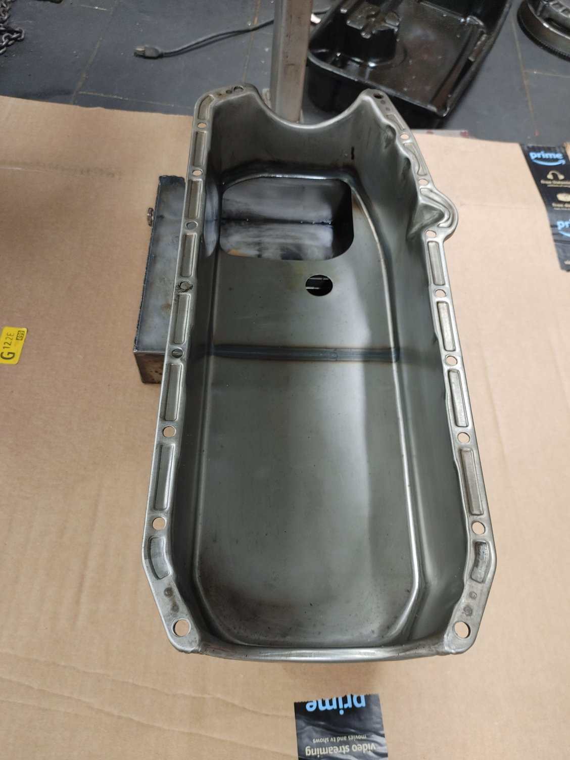

  • I think you're engine is probably fine for this. I hope your pan is not a Canton, because they have a bad habit of having baffles fail or generally just not working well. Kevko makes a great 7qt road racing pan. I had that one plus a real oil cooler, and the oil never overheated on track, even on hot Texas days. If your pan is a Canton, then I recommend a warning light to alert you if pressure falls in a corner or during braking.

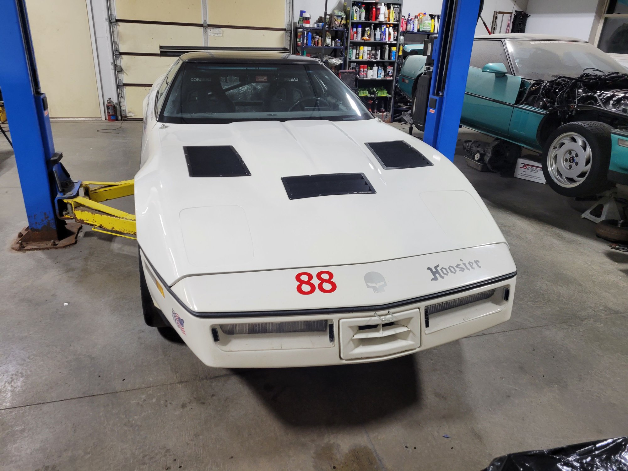

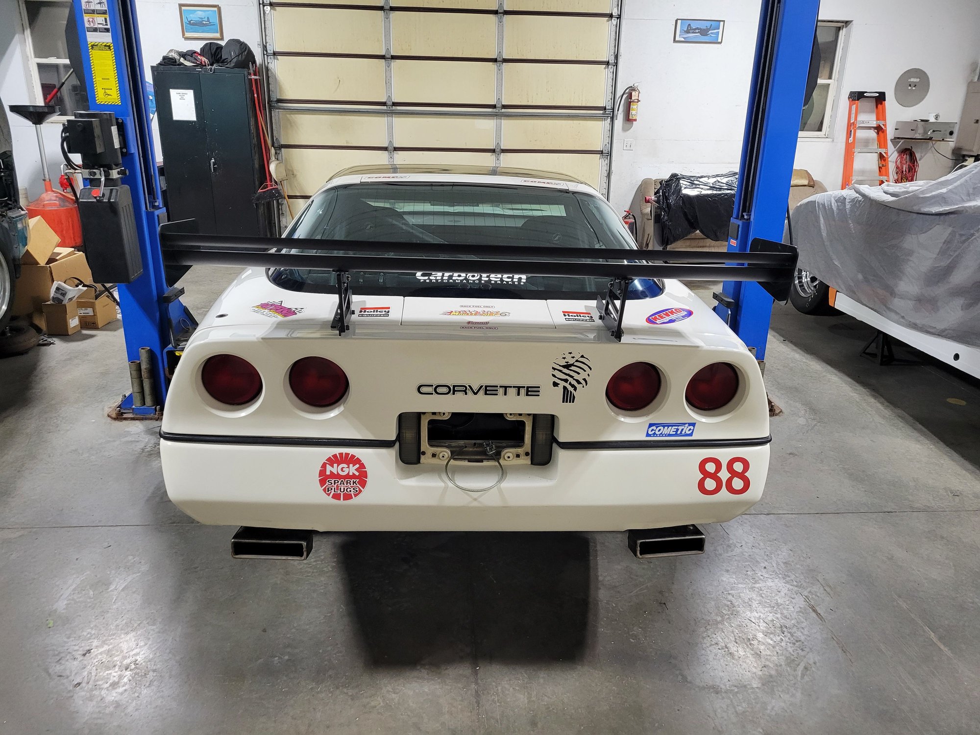

Just curious what is DE road racing?
I have a 1988 that is moderately modified for road racing and it works great.
A few pictures are attached.

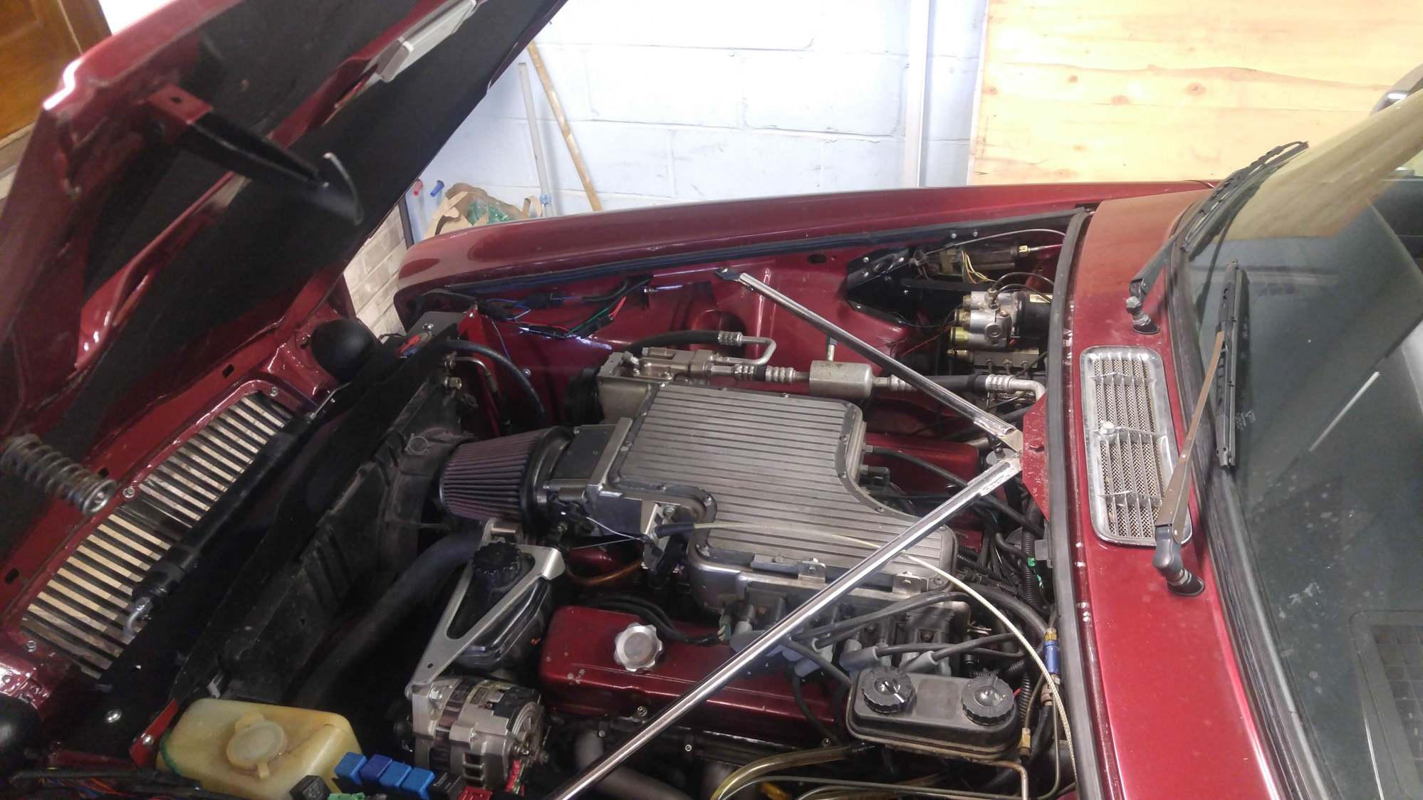

I have the 1227730 tuned with the harness from the Jag. Even has a Northstar DIS and ready to run electric fans too. The 1227730 will run a Northstar DIS quite well.

I got the SuperRam back from the sand blaster today and I got some valve cover that clear so looks like engine is going in this weekend so long as the bell housing registers correctly.
Few Questions.
1. Will engine go in wth headers attached or will I have to install them from the bottom?
2. Wll the pan with the kick out as show work or or is there some interferance issue I need to be concerned with?
