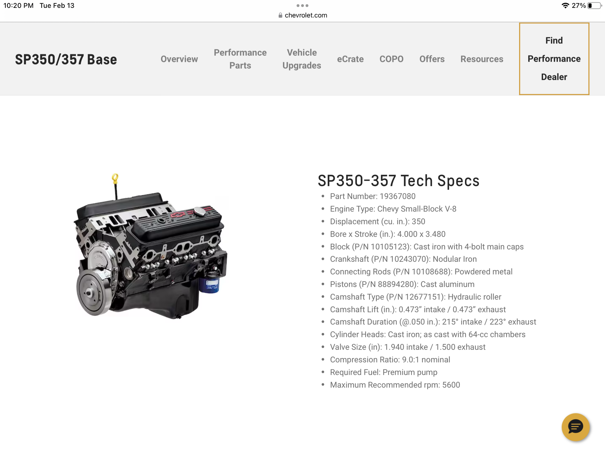

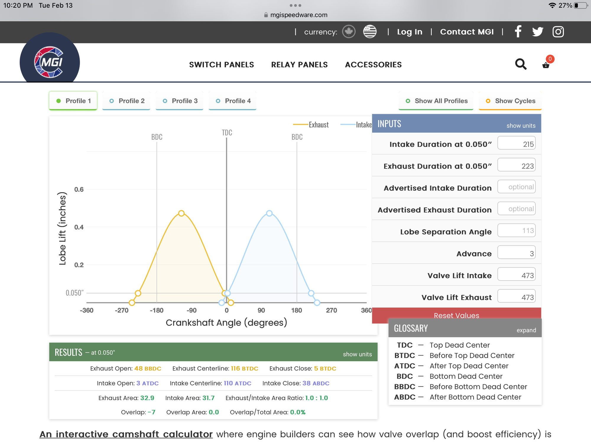

Any issues using this crate engine in the 85? It’s a one piece rear seal engine and has very little valve overlap. I know I’d need a new intake base and either someone that could make a new prom (or maybe a better fuel system). I know I could send my short block out, but a crate engine saves time. Hoping to have some fun reliable new hp for either Cruising the Coast or Sick 66 later this year.
Feel free to throw advise my way, as well. I’m all ears.

That engine should work fine, may not need a PROM for that. As noted you need the SDPC intake since this has vortec heads, and the 1 pc flex plate.

Might as well spring for a Pro-Flo XT (plus tuning) if going this route. You will need a new flywheel as well. Conventional sbc style heads (iron or aluminum) will give you a bit more intake flexibility (assume cost is a factor).

Personally I see no reason to buy a vortec head crate motor long block, force oneself to buy the Vortec pattern Scoggin Dickey TPI intake base for another $500, which I have heard actually flows LESS than a factory GM TPI intake manifold base, when you really can readily find a crate motor long block with non-Vortec heads.
Also yeah if your car currently has the factory 4+3 setup and you want to reuse your factory two piece rear main seal 4+3 flywheel, you should look for a crate motor that is two piece rear main seal.
Otherwise you will need a new flywheel, which isn't the end of the world but yeah!
That being said, your plan sounds like it will work!

10 years or more ago I bought an 85 project car that somebody had put a new ZZ4 Crate Engine in but couldn't make it run right. When my son in law helped me pick it up he claimed it as his own.. Long story short I took it to a local tuner and it was mostly a matter of hooking up all the factory grounds that had been ripped out when the original engine had been removed in a haste. Yes some tunning was done to the ECM as the ZZ4 has a bit more Cam than the L98. A decade latter this is just a good running little bit faster 85 that's done a couple track days and takes the kids to the car shows. This is also a 4+3 so somebody bought a Flywheel. Its got long tube headers as well. The ZZ4 heads are angle plug which is better when using long tube headers.
