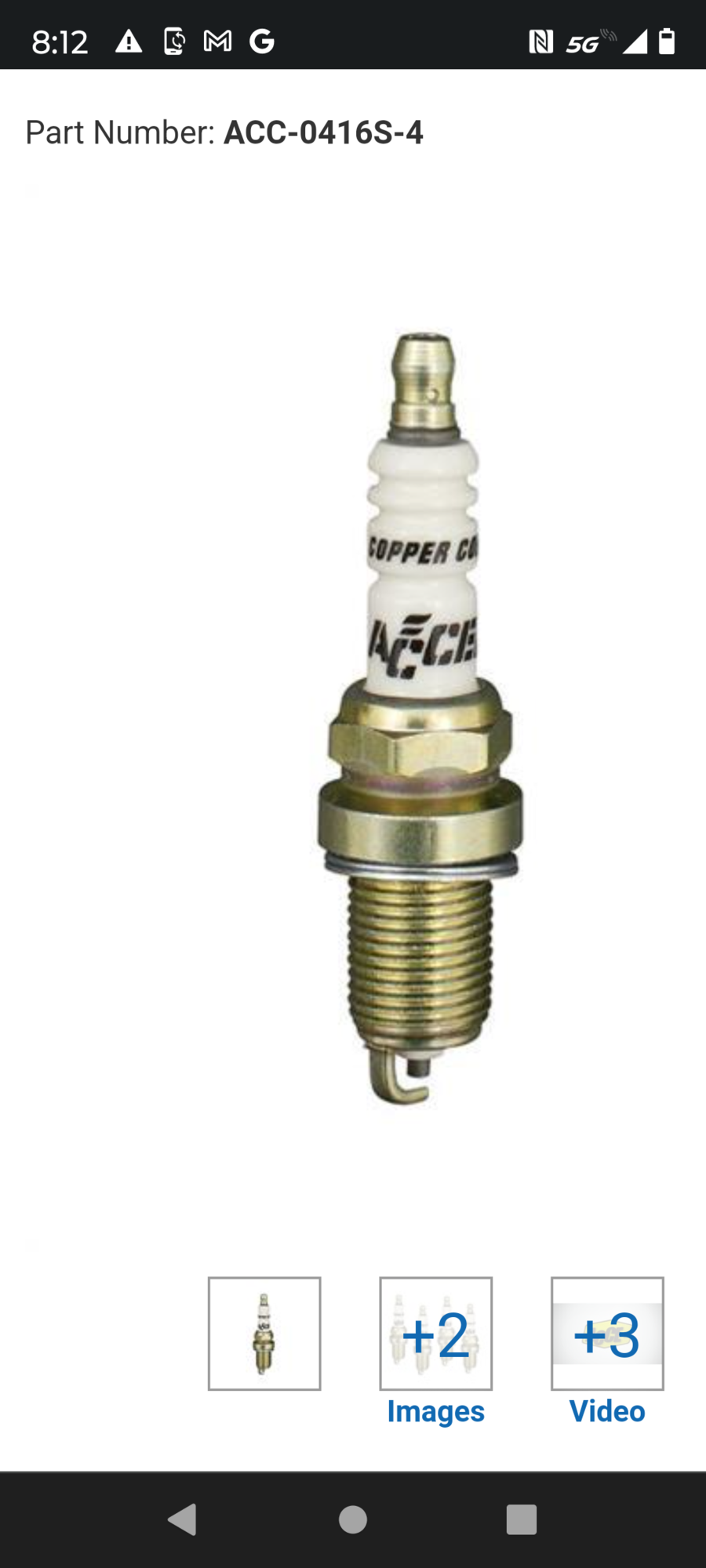

Have you tried installing a "shorty" spark plug like the Accel 0416S. I believe the "S" stands for short. They're designed to clear aftermarket heads/headers.

auburn2's Avatar
auburn2
Joined: Jun 2018
Posts: 532
Likes: 104
No I have not thought of this, but I will try it.
