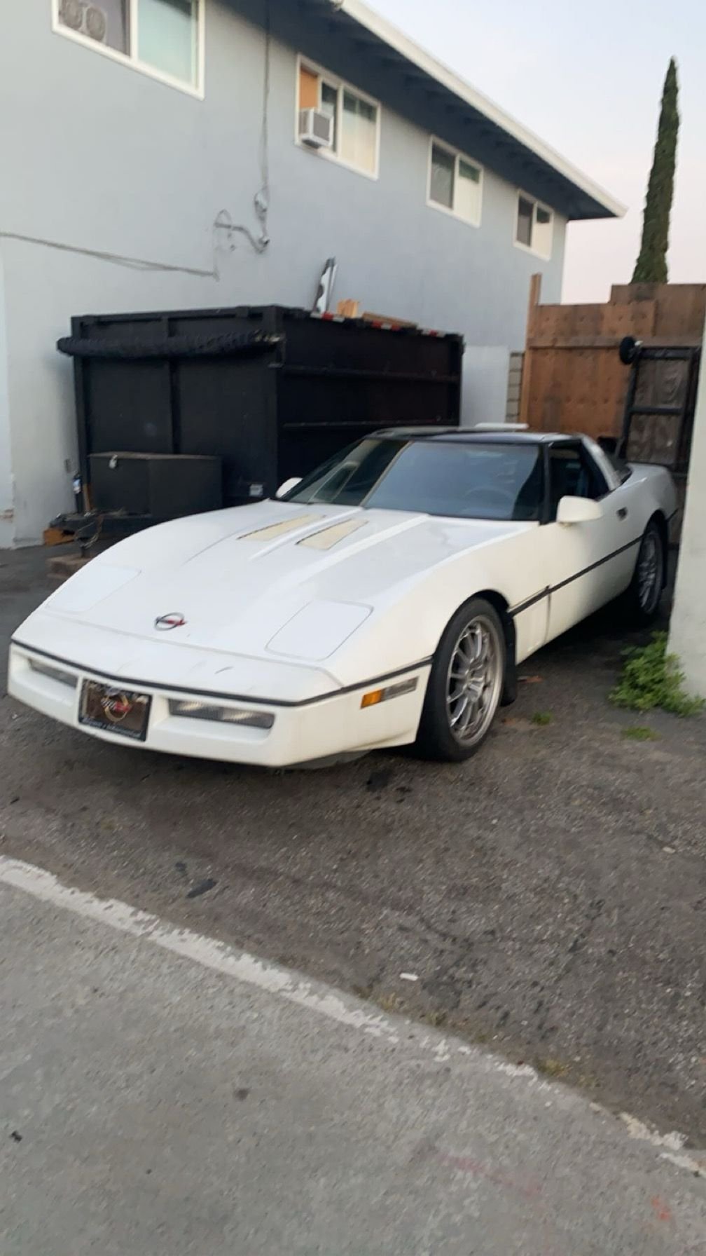

That sounds right, I was playing with the FMU to see if it helped with the lean condition and under throttle the wide and went down to 11:5 but idles lean still, I threw the new MAF power and burn-off relays on today and I cleaned the MAF and I was mistaken, the previous owner threw a Walker brand on the car which does not support the burn off function and I’ve been seeing terrible reviews.
If Delphi is a no go would you recommend a Bosch instead?
In regards to the engine build, I was going through the receipts I was given and the shop the guy has the motor built at has a description of everything but nothing on the rotating assembly, I called them and they said their system crashed last year and lost all records so I am going to assume that the motor is not forged, although I am pretty sure the rings were gapped for boost as it is mentioned.
Also here’s a picture of the car, the Enkei wheels will be going soon and I’m going to throw some C5 Z06’s on it.
