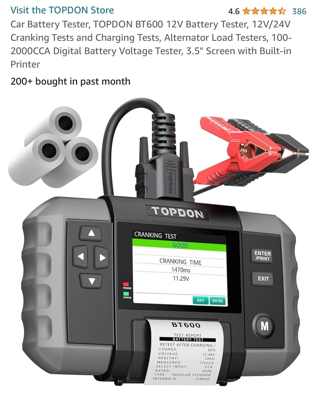

Load style battery testers are basically outdated…the capacitive type testers is what is used today…you can get this one for $135.00 from Amazon.

I bought one but without the printout function. Usually dealer uses that to give to the customer.
The one I have is Topton model BT50. Topton sells this model on ebay direct and less than $30. Amazon has it for $49.99.
Topton has quite a few different models to choose from. I am satisfied with mine. My .02
