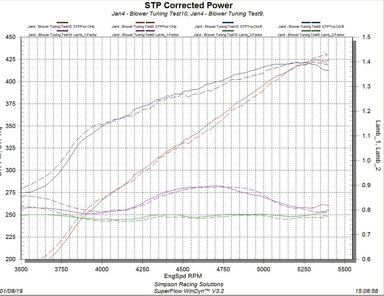

The blower will likely exacerbate the mini ram's issues.
Here's data from a blown mini ram car and raw dyno data included: https://datazap.me/u/tequilaboy/test...3&mark=139-214
Looks like it backfired on the dyno. Hot boost, not sure if they were using water/methanol injection during this pull or not. Hard to know what somebody else is really doing. AFR looks good to me.
This was a collaboration between myself, Blowerworks and Simpson Racing in BC Canada. Even with my support, a pro tuner had issues tuning it on his dyno. I think they blew it up in less than a year.
Note: This car had about 6 months of road and dyno tuning (December 2018-May 2019) with the mini ram intake prior to the log that I posted above. Do not underestimate the tuning effort involved. I supplied at least 30 bin files. Chris was also making changes locally with an ostrich, so probably 100+ iterations.

Found a dyno sheet to go along with the log data and dyno data that I posted above. It didn't really make much power and the torque curve is a bit strange, but at least its rising. Another 1,000 rpm would've been interesting to see.
