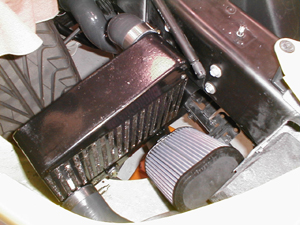

That was the ATI kit for the 90-91 blowers. the small intercoolers under the headlight buckets. I think that is too much plumbing along with this turbo mess we will be adding in.
they welded the 2 intercoolers together to look like one.
I am looking for the link now
I cant find it. it was long ago. All they did was hack teh ends of the end tanks off and weld the 2 intercoolers together.
You could do the twin intercoolers as well. LPE did this on the C5's. If you got creative and felt like hacking stuff up, you could do it very similar.

If it is possible to put the intercoolers infront of the tires in the bumber is it worth the work? Like maybe if you cut little holes or like the fines on a Early C4 behind the front tires on the fender? Kinda like that on the inside of the wheel well up front? and then Maybe add a small fan to the intercooler so it will blow the air out somehow through the slashes.
The LPE looks cool, but thats a C5 and I dont know if it will work for a C4. And done you think it would be harder to find smaller turbos?
Lingenfelter brings the air in through the front bracke ducts C5's have stock. Then they cut a rectangle hole in the inner fender, right in front of the tire. here the intercooler air escapes. This might be possible on a C4, the only thing I see getting in the way is putting the headlights up and down.
